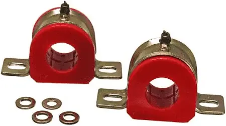

I added Accura S anti roll bars on the Honda. They bolted in and only improved handling. I added a big anti roll bar, Hellwig, to my 2500 Ram. When not loaded, it would dance around a bit on the highway. I add additional isolators to the end links and all is well.
I'm going to swap out the OEM anti roll bar bushings for urethane and see how this stiffens up the ride. This worked nicely on the Honda and truck and is a cheap mod.

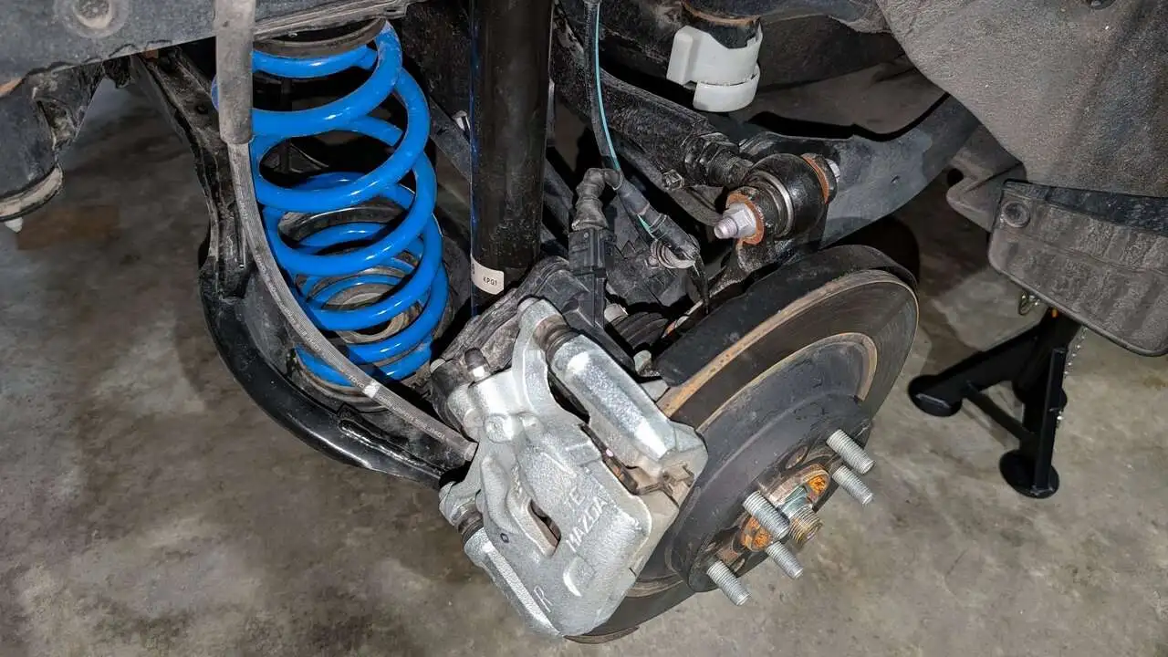

I ordered rear camber/toe kit for my 3rd Gen, 2024, CX 5 today.
Specialty Products Company - Cx-5 Rear Camber/Toe Kit (67416)

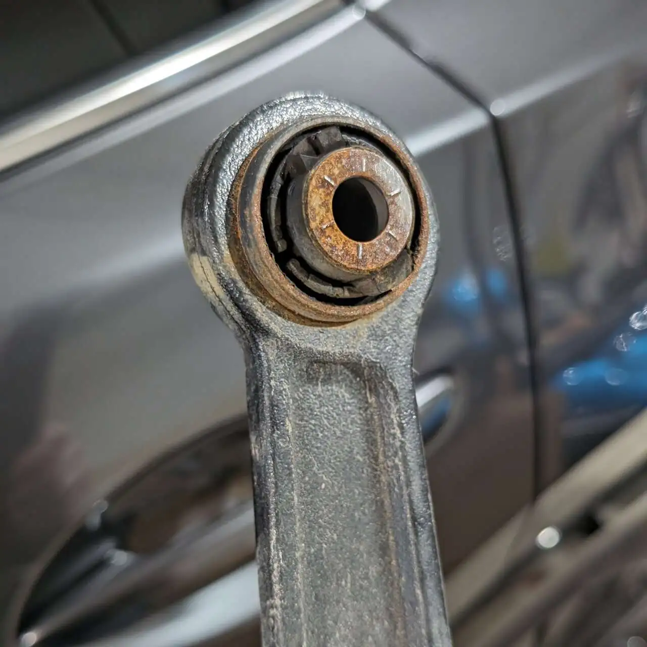

Jumping back in here...can confirm the LYKT control arms work well and look OEM. Thanks everyone for that tip.
Side note: rust happens quickly with these stock parts...this control arm has 3,000 miles on it and 1 winter. The same could be true of the LYKT.

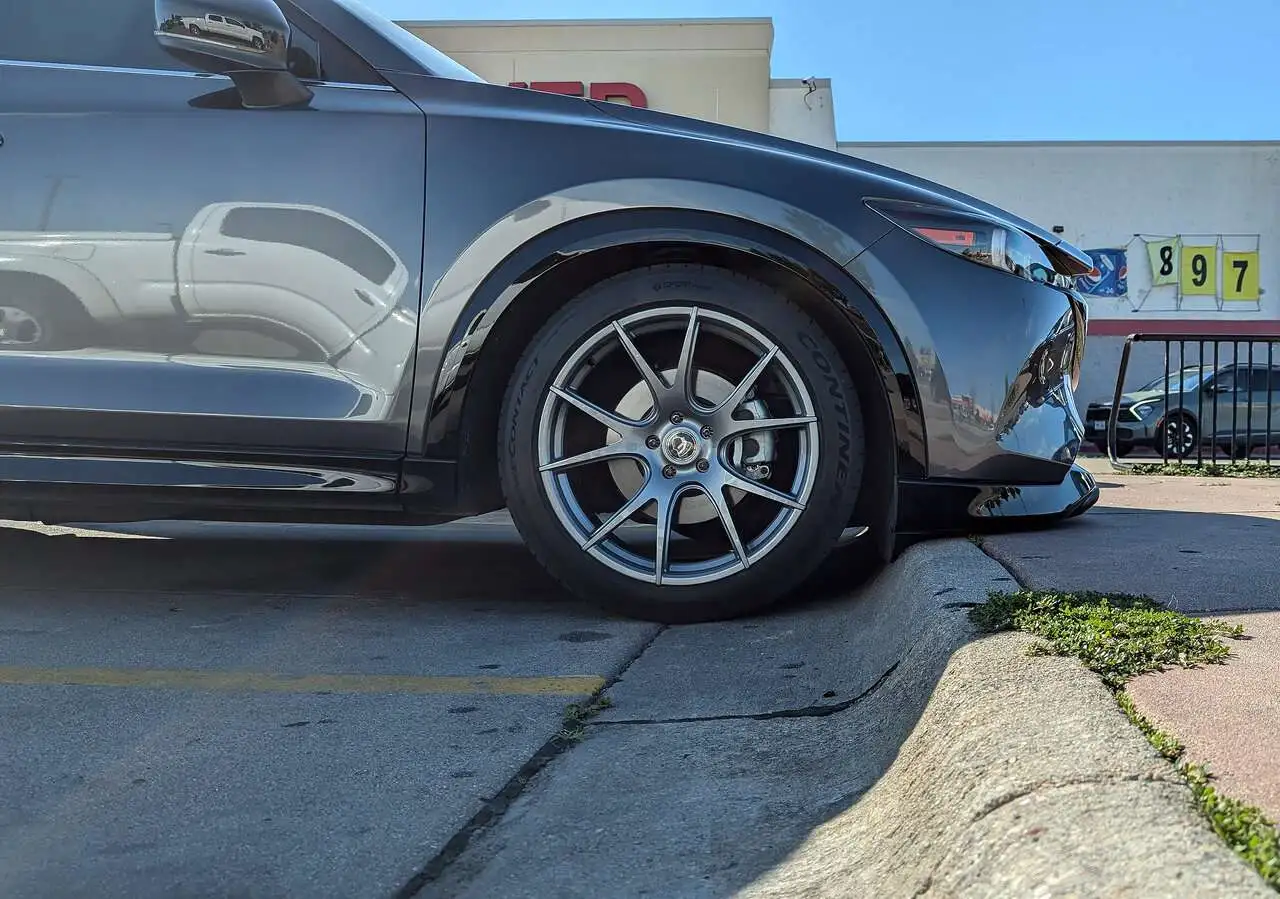

3. If you go much lower than the corksport springs, you'll have to watch out for curbs with the bumpers, exhaust, doors, as well as speed bumps
Can confirm! At 2" you are right on the curbs here. There might be enough room to slide a piece of paper under there...but maybe not.

My current thought process is that the 7.0K spring rate of the rear Corksport springs is enough to not need to add a rear sway bar. The tradeoff though seems to be a little more stiffness when going in a straight line. Most adjustable coilovers I see start at 6.0K rates in the rear (stock is around 5.2K) Then by adding a sway bar, you increase stiffness only during roll. Or so I understand.
You're crazy going that far over. I'm afraid to get too close to curbs (my previous car wouldve hit them).
In my seat position, I sight-line the bottom of the side mirrors up to the curb line and it ends up being the perfect parking position in pretty much every car I drive.
Assuming springs do the same thing as sway bars is mixing Apple's and oranges. If springs controled body roll, then we would never have sway bars. If you are happy with the springs and oem sway bars enjoy.
My experience with Megan Racing bars with urethane bushings is night amd day difference over OEM with stock springs and dampeners or coilovers.
