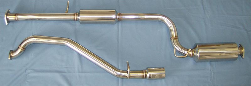

This exhaust fits the 2004-2009 Mazda 3 . Here are a few video clips of the without the optional high flow catalyst installed. The car shown is a 2008 2.3 Automatic.
Driving Away Video Clip
Revving Up Video Clip
Idling Video Clip
The CorkSport Mazda 3 exhaust is constructed from polished 304 SS and is TIG welded. We use flange connections for the installation for the junctions of our exhaust. The options available for the exhaust are PZEV and a high flow catalyst. The PZEV means there is an extra O2 sensor bung in the exhaust system for the catalyst monitor. The high flow catalyst option includes a metal substrate catalyst to replace the factory second catalyst which is removed with the installation of our exhaust.

The exhaust connects to the stock flange after the primary cat coming off the header,
non pzez afaik have all sensor bungs located on the header group opposed to a single sensor bung located further back by the secondary cat,
umm yeah no matter what exhaust you install cutting the "stock" exhaust to easily get it out is a must imo (right before the rear suspension framework group),
this is pretty much a 2 hour install depending upon how much time it is going to take you to break exhaust nuts free (amount of corrosion),
there is no fabing require, it fits perfectly, it was made for this specific application mazda sedan", but it comes as a 3 piece not as a 2 pc, you will get a test pipe standard and have to pay extra for a high flow cat that goes in it's place, or you could be really cheap and just have the stock secondary welded up with flanges and install that, kind of defeats the whole purpose though...I kept my stock exhaust, boxed it up and store it in my attic, comes time to revert the exhuast to trade it in all I have to do is have flanges welded and bolt it back on.
Had it on my car for 8 months, sounds good, good flow, little power gain, high qaulity materail and workmanship no issues what so ever and no cels,
This is for the n/a sedan, they make versions for n/a hatches and speed hatches.

It really doesnt matter on our exhausts now as we have made a change. All of the Mazda 3 exhausts come with the O2 bung now and a plug. If you need the extra location simple remove the screw in plug and put your O2 sensor in. If you do not need it leave the plug in.
