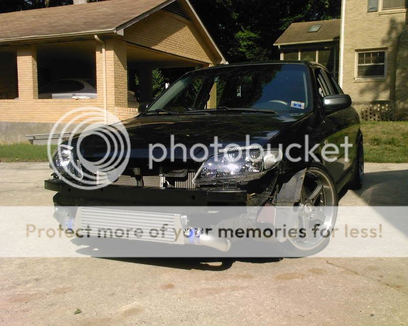

I think it will will let you use the bigger stock radiator. If you look at this pic you can see that the stock smic is still in place. If that's still there then the piping has to go around it somehow. People with MSPs can either leave the smic there or upgrade to the bigger P5 radiator.
This is the CS 24x6x3.5 FMIC with custom stainless tubing
What do you guys think?
is that how low the piping will sit with the cork sport piping? if so i dont know if i want in on this, seems like it would scrape REALLY easy... can someone post a pic of the corksport without the front bumper on

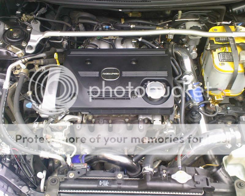

His MAF is in the stock location, he is also using the stock BPV with a BOV too I think.
i love the front mount, soooooo much more pull, i'm running a dual valve setup and the MAF is still in the stock location, no stalling problems, while we were building and putting on the tubing i was worried about how low the are, the neighborhood i live in is filled with 6" high speed bumps so when i came to first one my heart was pumping but it made it over fine, it doesn't scrape coming out my driveway either, i don't park all the way forward in parking lots cause my car is lowered, i am still very carefull though, thank you for all the compliments guys, total the kit cost me $630, so so worth it!!!
