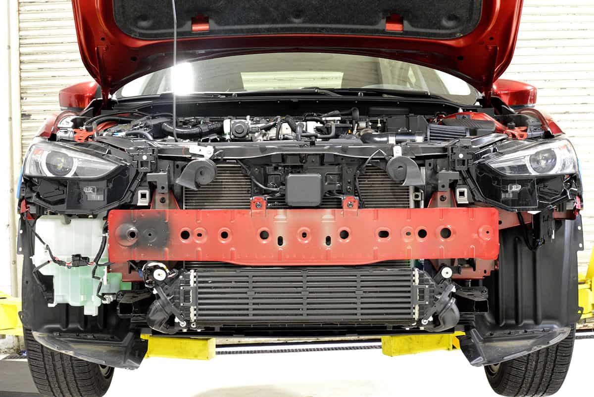

"The stock intercooler core is 24.5” wide, 5.5” tall, and 2.625” thick. Our plan is to fit a 27” wide, 6” tall, and 3.5” core without any trimming. This sizing combined with a low-pressure drop will be good for 400WHP with no issues! Because the Mazda 6 comes with just around 200WHP from the factory, this sized core provides plenty of room for upgrading down the road without causing excessive boost lag that can occur if an intercooler is simply too big. "
-Corksport doesn't say it adds any HP, but can provide the ability to add upto 400 WHP"

SkyActiv 2.5T: Lets Talk Intercooler Pipe Upgrades We recently went over the stock intercooler & piping system for the 2018+ Mazda 6 2.5T. If you missed it, be sure to check out the blog HERE. Today, its the first look at the CorkSport parts that will be coming in the near future to remedy the...

"Front Mount Intercooler is 3/8” taller and 1” thicker than the OEM intercooler, providing 50% more core volume"
