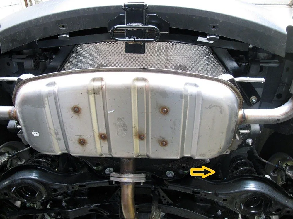

It's not this one? If yes, that looks pretty vertical to me.
Yea but, that car is on a lift so the suspension is not loaded. I am interested in a loaded example. I may just got to the dealer and look next time I have time.

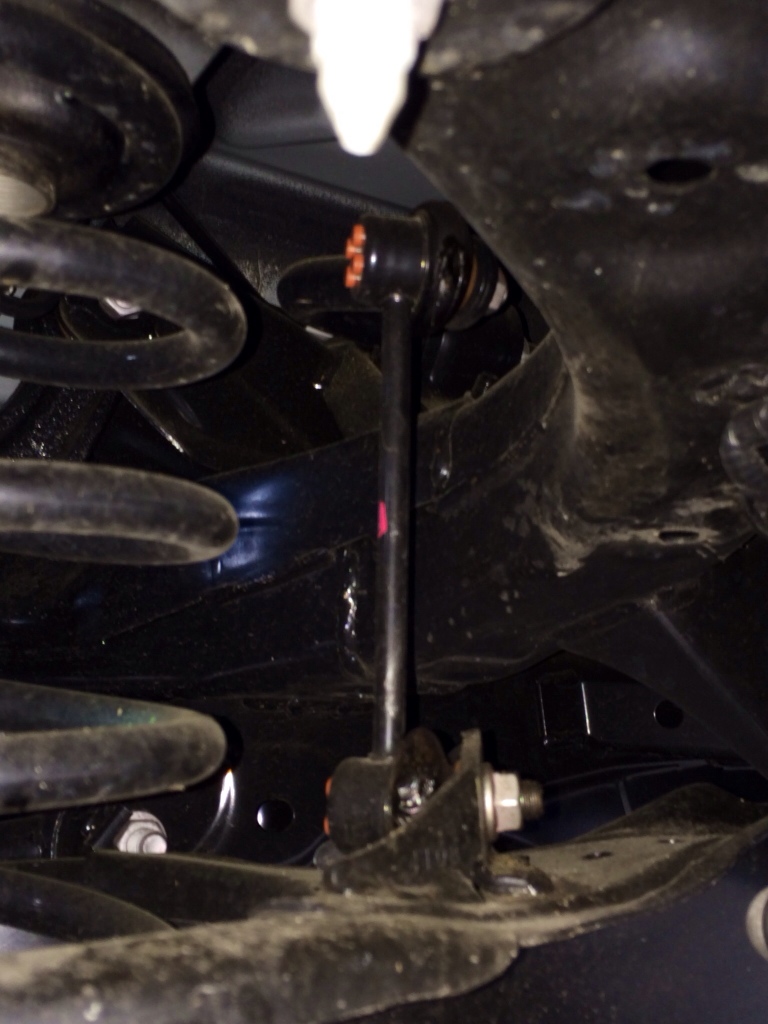

Here ya go, I snapped a pic of mine (stock)-
Thanks, so it appears it's pretty much vertical (correct me if wrong, that is on the ground right?). I think I will need a shorter link then. I can just undo lower link nuts and swing it by hand and use a ruler to find a good length. Thanks.
You're correct, it's on level ground.
