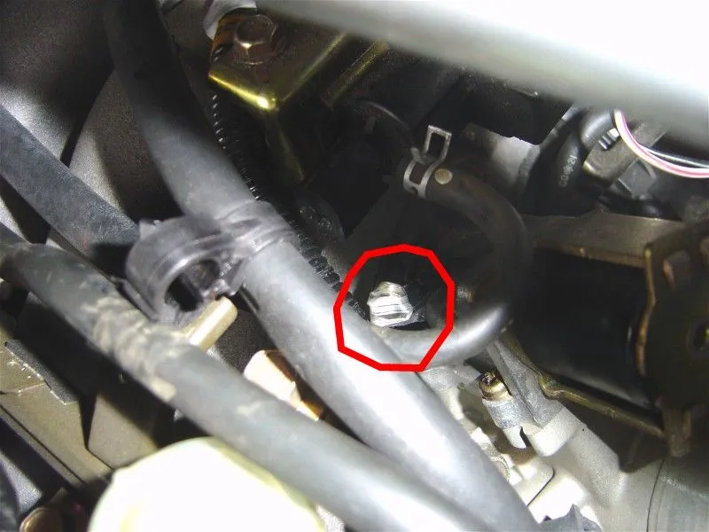

I finished mine earlier tonight...I had to take the intake & upper IC pipes out to get at it. Even then, I still look like I got in a fight with a cat as George (EviLMan) puts it.
LMAO..
I took some pictures while I was doing this to help out anyone who hasn't done it yet. When I first looked at it, I had no idea where the hell anything was. I have pictures of the 2 plugged inlets to the TB (my ghetto plug job that will be replaced tomorrow with vacuum caps). For anyone using the 3/8 size hose connector from Home Depot, be aware that the OEM clamps are too small to fit over the connector once it's in. They are the same cheap kind that are on the BPV line & I will be replacing them tomorrow as well with screw clamps. I also drew the path of hose on my picture to give you an idea of where it goes. Finally, whoever said they only got 3 drops of coolant was lucky...I got about 6 ounces. I had let the car cool down for at least 4 hours, so I don't know why it happened. Anyway, I haven't driven it since I finished, so I'll report my findings tomorrow.
Glad I'm not the only one! Lol!
I was coming back tonight after visiting a friend at his house and I was going about 60mph in 5th gear, listening to the turbo spool around 2-3 psi. Then I heard a THHHHUH! All the lights came on instantly (CEL, oil lamp, airbag, etc.) so I turned the engine off (I don't even know if it was still running) and pulled off onto the next side road. I didn't have a flashlight with me so I called my brother and asked him to bring a flashlight and some tools. While I was waiting on him to arrive I fiddled around in the engine bay trying not to burn myself, and find the coolant hoses that I had just connected earlier. They were still intact, so I had no idea what else it was... until I wiggled the intake pipe. Apparently I didn't tighten the hose clamp on the IC to TB pipe and it popped off the TB. I was glad it was only that, and not a coolant leak. But I don't understand why all the lights came on. I assume the engine stalled. But I don't know why it would.
Anyways, if you take off any intake piping make sure it's really good and snug.
