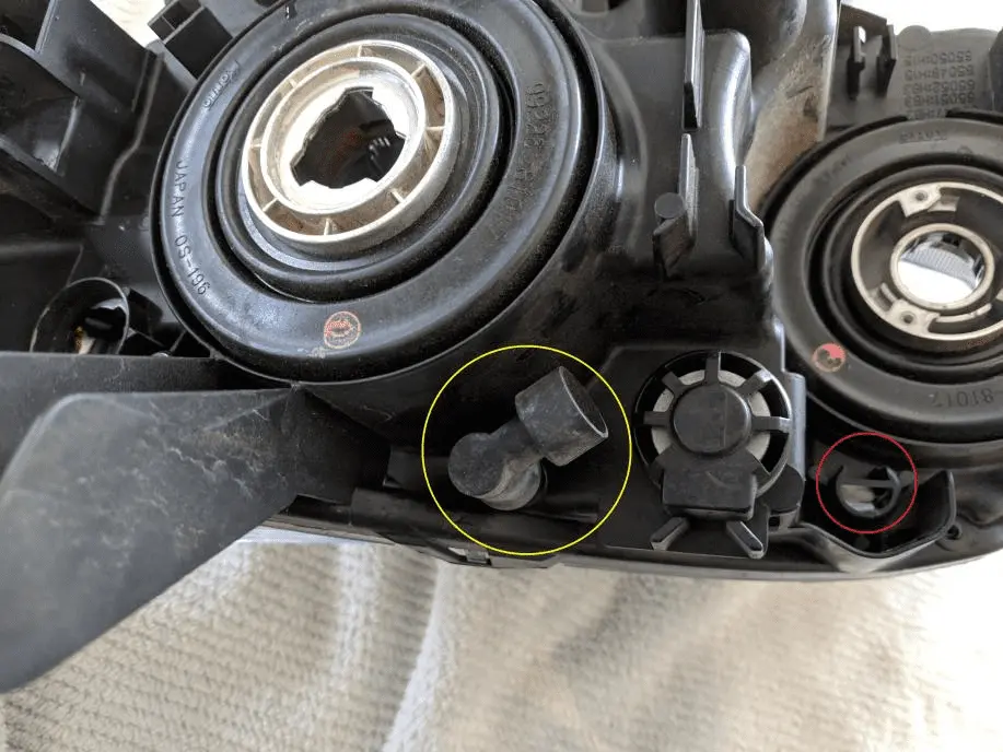

@Himalayan_Hi I had the exact same problem. Without removing the headlight, locate this drain plug snorkel and remove it. Inside is a piece of foam that will be soaked in water. Remove the foam and let it dry completely. Keep your hood open and try to let the water evaporate out of the housing.
If you only have a little water inside, do NOT wait. We had about 5 ounces of water which would not evaporate easily.
