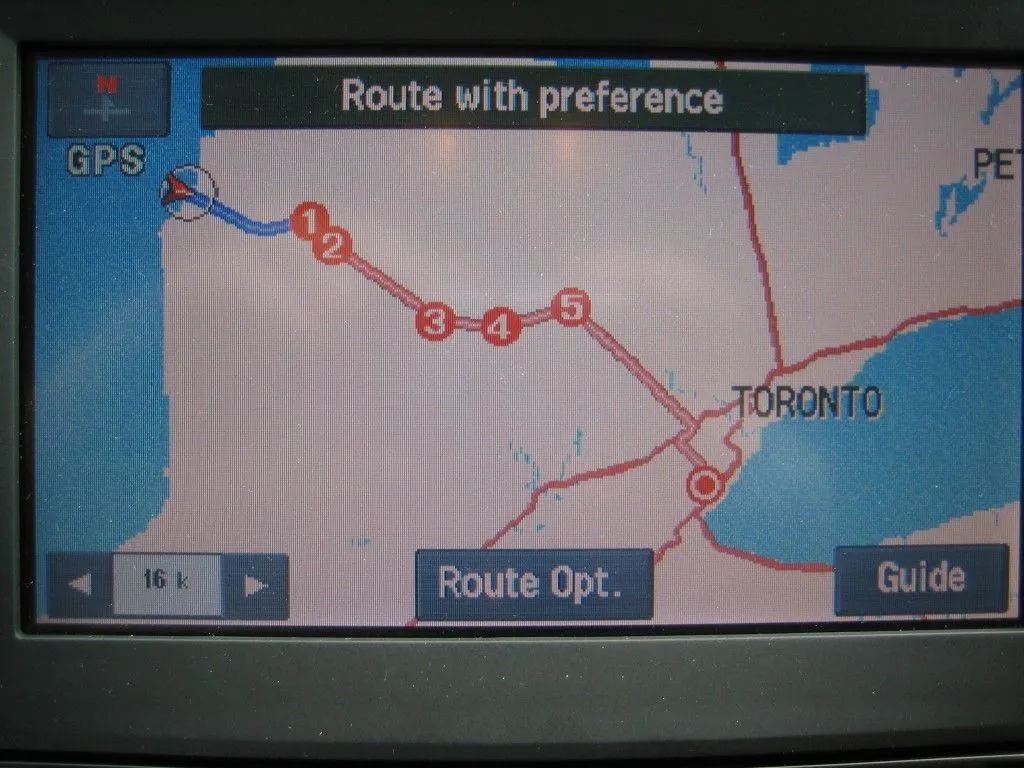

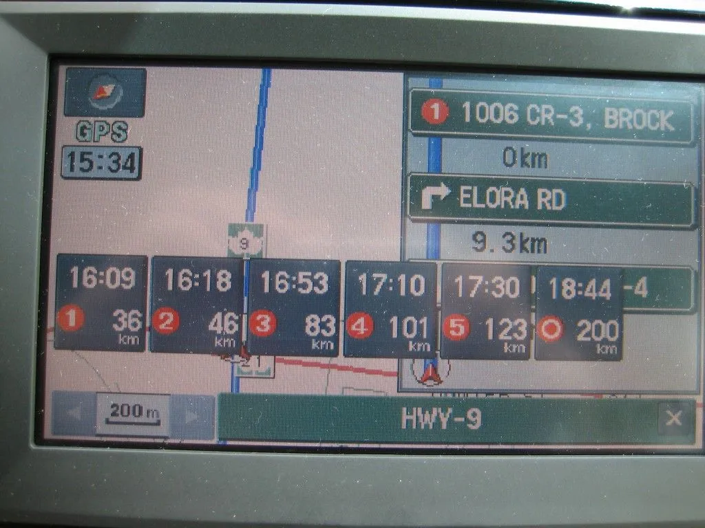

There is a compass on the top left corner of the navigation screen. I don't really like some limitations of the navigation system, but yesterday I liked it a lot when played around with waypoints and other features and run into an interesting screen (third photo). The first picture shows the waypoints and the compass in one of its two operating modes. ("Geographic-north-up" map orientation mode)

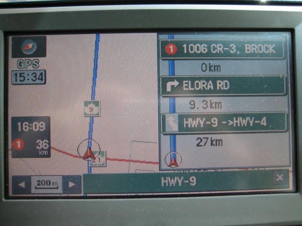

Here is the other ("Heading-up") operating mode of the compass:
On the above screen I clicked on the displayed 1st waypoint icon, and the following screen showed up:
I really liked these trip planning details. It's always good to know your distance and ETA to Tim Hortons "XL double-double".(canada)

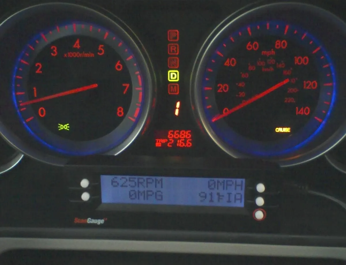

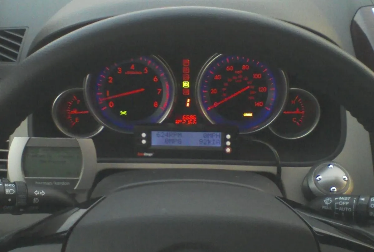

Got the ScanGuage II and installed it in all of about 2 minutes! Truly plug-and-play. Works well, but I'm still in the calibration process (takes a compete fill-up to fill-up to get the fuel usage totally accurate). As with other cars, having the instantaneous MPG in front of you tends to increase your gas mileage!
I went with a blue background to match the blue ring lighting of the tach and speedo. It's only visible at night. During the day it's black on white. Here are two pics:

We installed over the weekend as well. Piece of cake! We completed the speed calibration (using a handheld GPS), and it was only off 2% or so. Will be calibrating the fuel tonight after 3/4 or so of the tank will be gone. We also went with the blue background; seemed to match the dash pretty well without a heck of a lot of work (and trying for one of the 63 custom colors).
My wife loves the miles to empty feature, and will likely leave it on that page 98% of the time, though the other gauges are fun to view from time to time...
What is that Harmon/Kardon device to the left of the dash?
That's a Drive+Play that works with the little mushroom shaped controller on the right of the picture, to control my iPod.
There are a number of threads that discusses this. Just search for "Drive+Play". I posted close up pictures in one of them.
