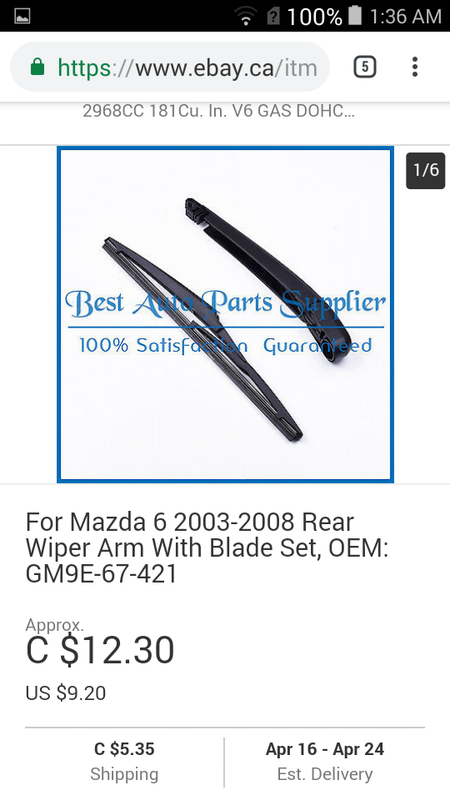

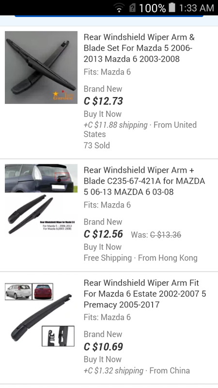

I just ordered this one. I entered Mazda 6 instead and got the same blade.
I guess they're all the same.
I ordered the one from the US because I should have it in less than two weeks.
It was $5 more.
The ones from China take about 7 1/2 years to get here. lol
Then I found out the it ships from China/Taiwan/Hong Kong but it's expedited.
