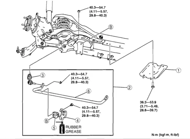

yep, the endlinks spin around, just did the install myself this weekend and had to hold one down with an allen when removing, but putting it back it grabbed and tightened no problem. the bracket bolts and endlink nuts suppose to be torqued between 30-40 lb/ft, the brace bolts 27-38, and all thread-locked (i used the red stuff). also use synthetic grease (not petroleum based), i used Green Grease available at any auto parts store.
Not to be a jerk, but hominemodi, are those torque specs accurate? Did you get them from the service manual? I just want to be sure because I just downloaded the Cobb install instructions for reference and they didn't have any torque specs in there.
Also, would blue loctite be sufficient or is it not strong enough?
no problem, it's a completely pertinent question; yes, the values are from the service manual. and good point, i don't know why cobb and others put out an installation manual omitting such critical info. i think blue loctite is good enough on suspension; for engine and other vibrating parts i'd use the red though. here's the page from the manual

Superb! Thanks so much for the service manual page and for understanding. I have the Service Manual downloaded via PDF, but couldn't get any results through the search of over 2,900 pages :)
