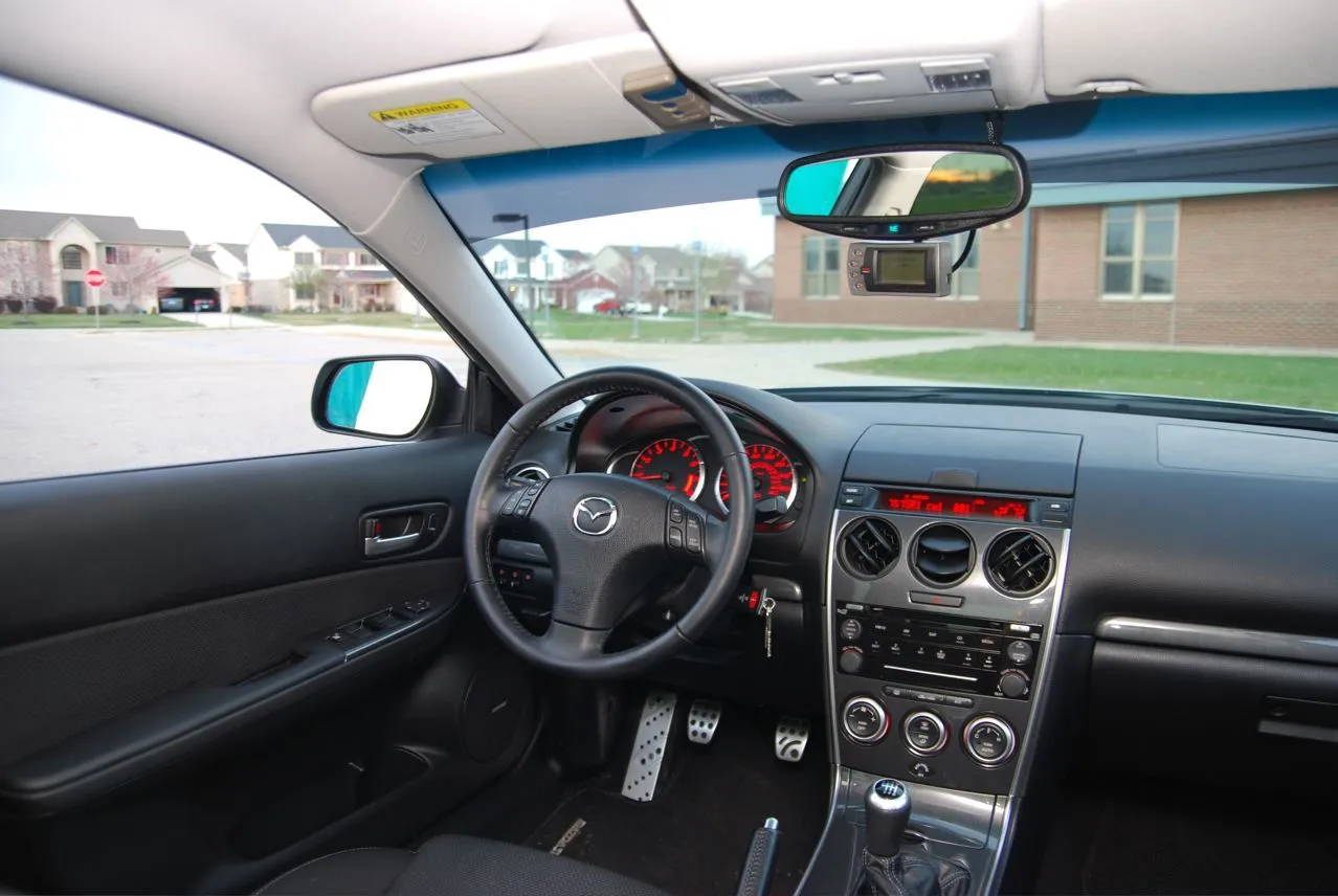

Absolutely. The DH is great regardless of mods, and worth every penny. It's more of a peace of mind mod, but with how odd our cars can be, I'd suggest it. I picked up mine before I got the AP, and just being able to monitor so many parameters made me feel more at ease.
