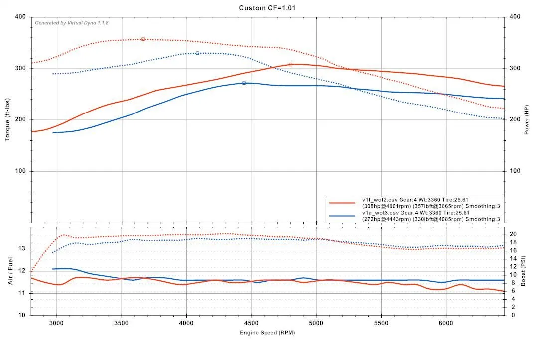

Well I did couple hard pulls latly after breaking in the stage 1 sf map...and the highest knock I get is 0.7...pretty consistent too..each pull I do it doesnt go higher than 0.7.....so thats alot better than the 4.9-5 knock iwas getting with stage 2 map..as it looks like this map will be the safe map to run till i get my downpipe installed then ofcourse its custom tune after that :)
Looking through his data, it occurs to me that not once did he go WOT. The closest he gets is 75.27% throttle.
i caught that also cataphract lol u gonna be a man and la the hammer down or the numbers r useless!!!!!!!
Throttle position never goes past 75% for me when i do WOT runs and i have been doing a bunch of datalogs i know my foot is to the floor and ive been working with Dizzy Tuning for a custom map for my current setup. i believe the accel. pedal position shows if you have your foot mashed to the floor, that logs at 99% when i got WOT. so i think he is doing it right. i posted a Virtual Dyno Graph to show my progress, car is really dialed in right now, feels great. still tweaking the timing, waste gate duty cycle and the load tables but i should be done soon.
