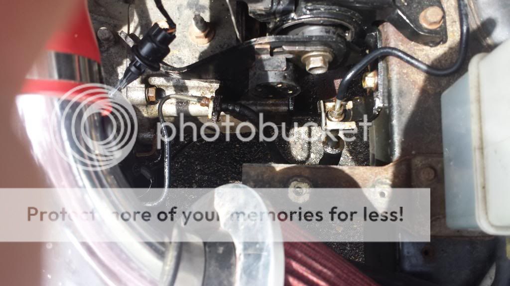

It's not that. It's the soft line between the two hard lines for the slave- and master cylinders. Here's some pics:
