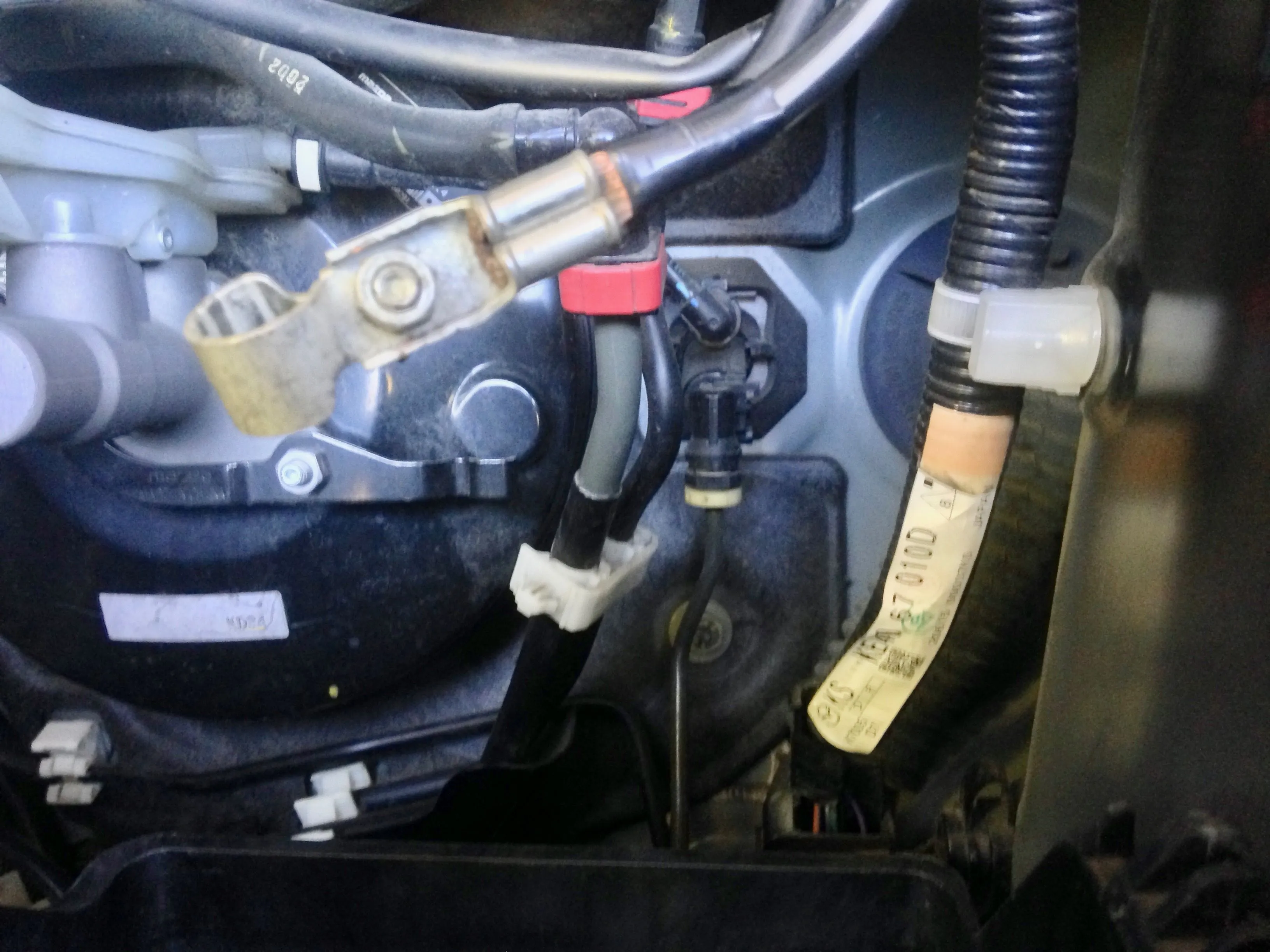

Edit. I started taking things apart. I took out the Air cleaner ( this will make it easier to get to the slave cylinder to bleed the system when done ).
I took out the battery. I did not take out the Battery tray and PCM component. I don't see why I would have to. I have a clear opening to the Clutch Master Cylinder. I will start just saying CMC. for that. I posted a pic. The CMC is just southwest of the bright red. If anyone can think of a reason to remove the PCM let me know.
