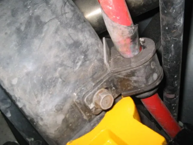

I have been clunk free for almost 4000 miles. All i did was added a piece of rubber between bushing and the frame. hmmmm... And it has been cold in the mornings. Also no squeeks. :D

here is a pic of what i did, and i have been clunk free for a while now. I got my new bushings put on in june when i got my LSD put in. the also used teflon tape. You can see the small piece of rubber i added.
