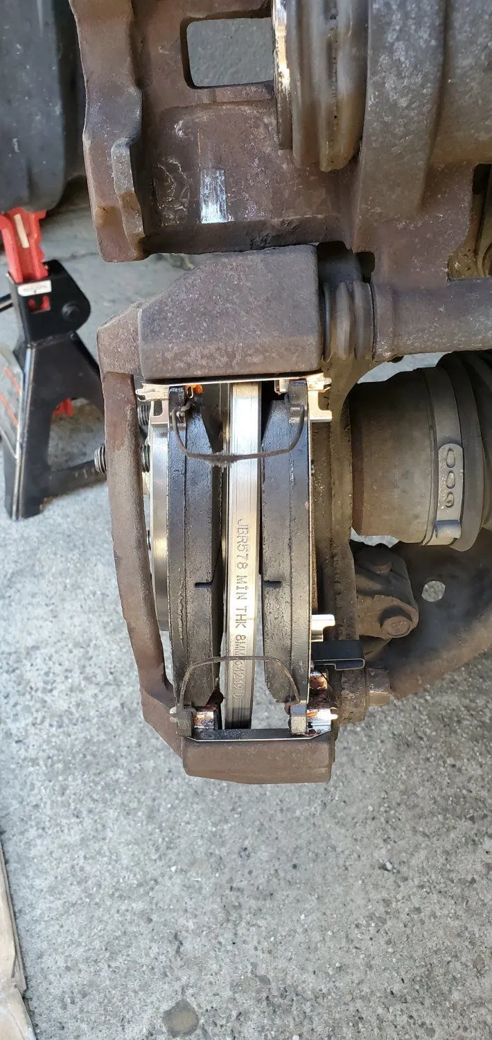

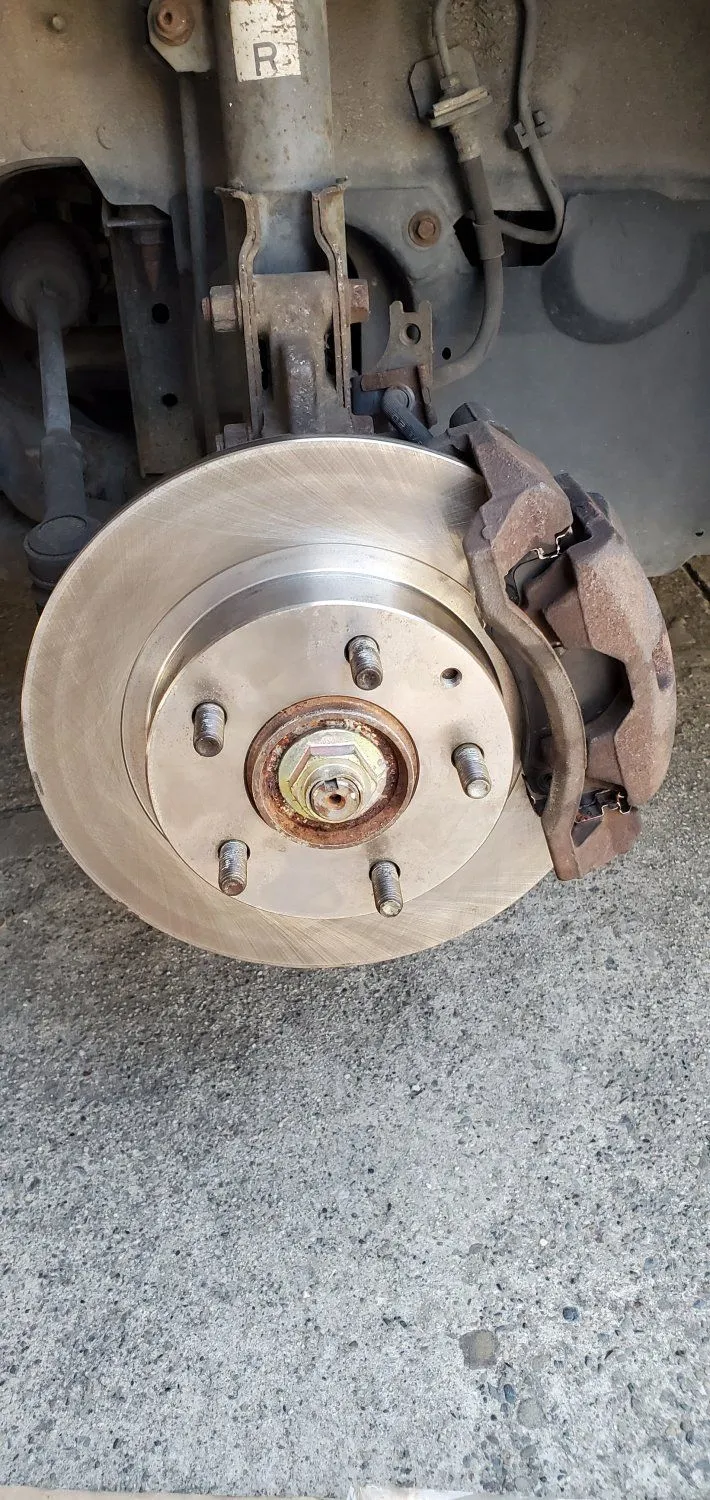

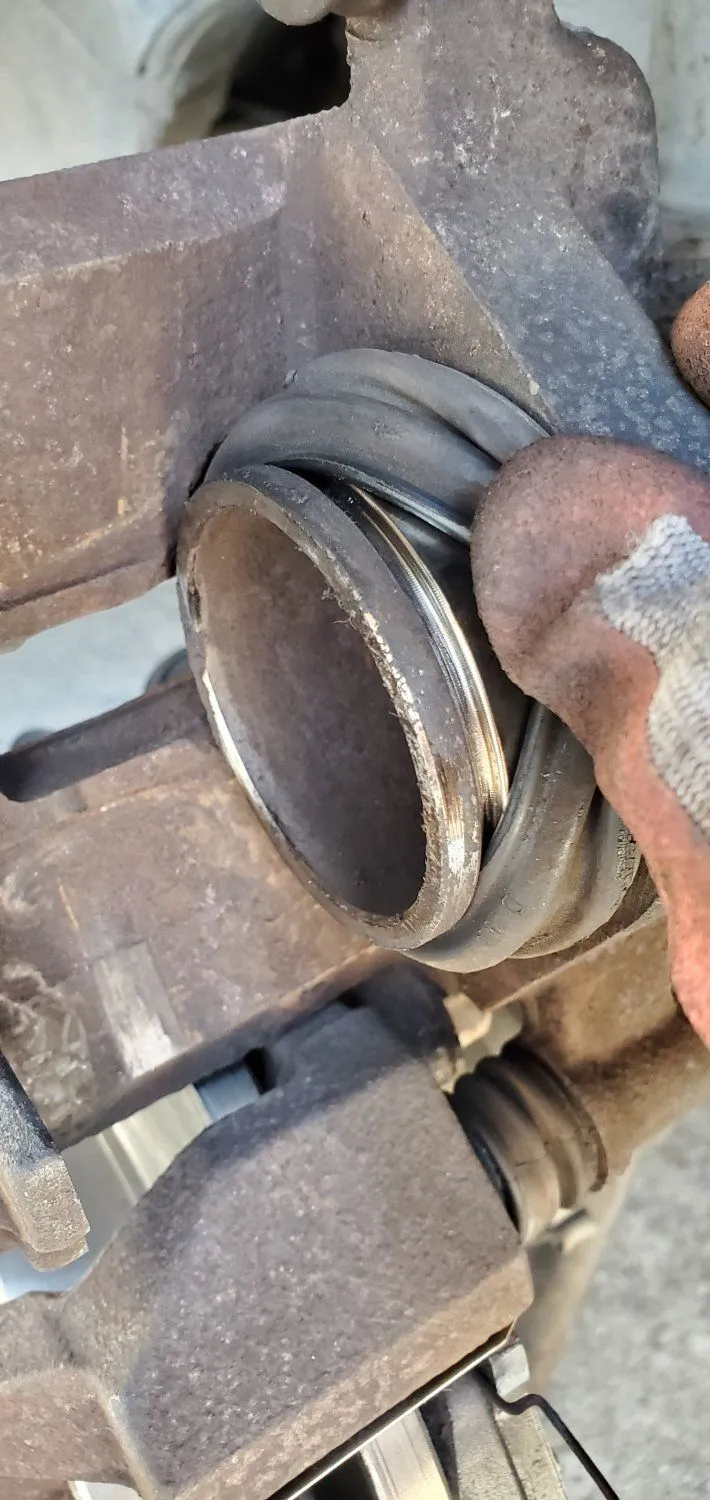

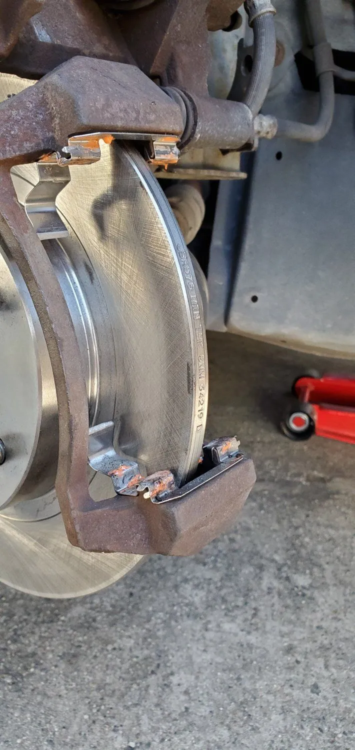

I don't know why I didn't do this sooner, but here is the video of sound in question. The noise happens when I apply the brakes aggressively, once i hear it, the noise doesn't go away. The video is taken on the first drive of the day, it took several attempts of aggressive braking before the sound started to appear.
I am using "Permatex silicon ceramic extreme brake parts lubricant" for brake pad lubricant

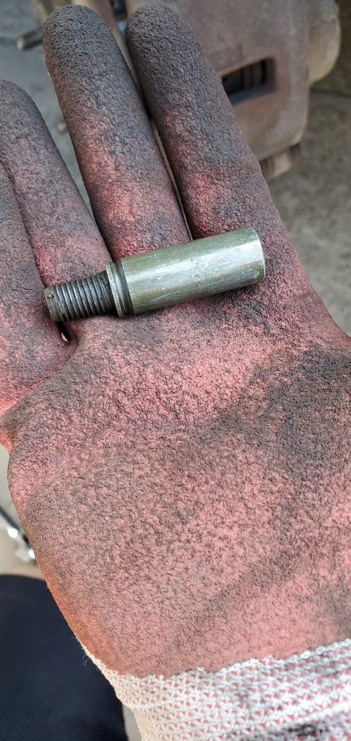

Part of me is wondering if the
shouldn't be used on the two bolts holding the bracket together.
When the brakes are applied, the bolts are sliding freely which results in uneven pressure of the brake pads to the rotor causing the sound?
notice on the second picture ending in 3487 there is a fresh scrape mark on top of the bracket.
Shouldn't the front disks be much thicker and vented? (see PCB's Post)
It looks like the disk isn't sitting square with the hub or brake caliper, maybe check to see if the disk is warped or if there's any gunk on the hub that's not letting it sit right
The bolts are meant to be greased and the caliper should slide freely back and forth but not wobble around, if it's doing that then the caliper is probably junk.

That caliper looks really wrong.
I think you've got the wrong rotor and it's completely cockeyed.
The pads are supposed to be flush with the rotor.
Being off by a couple of thousands of an inch is bad.
You're off by almost an inch.
Actually, you don't have your lug nuts on so the rotor may have "fallen".
If you've got the long lug nuts, you can screw them on to snug up the rotor.
