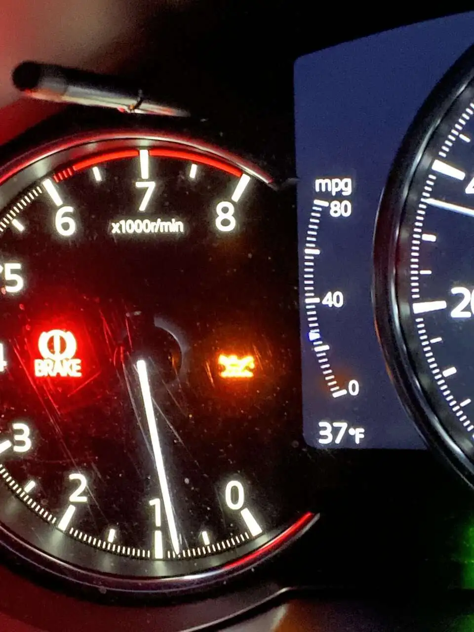

If your 2021 CX-5 2.5T has had “Low Oil Level Warning Light” on, you can go to your Mazda dealer with a current TSB (the 3rd revision) to get the exhaust valve stem seals replaced under warranty. This should be covered under 5-year / 60,000-mile powertrain warranty. You don’t need any “oil consumption test”, the dealer just needs to pull DTC P250F code which was registered when the Low Oil Level Warning Light was on.
TSB No.: 01-003/23 CHECK ENGINE LIGHT ON WITH DTC P250F:00 DUE TO LOW ENGINE OIL LEVEL
