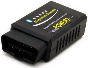

Buy your own code reader... They're only 10-20 bucks.
This one broadcasts to your smartphone... Tells you EVERYTHING about every sensor on your car. (and it will rub codes too.)

The Bluetooth ELM327 adapters are awesome. You can view live data as well as view and clear codes. For less than 20 bucks it's a no brainer, I bought mine from Amazon, I believe it was a Vgate. Use the Torque Free app for Android, and there is also a Torque Pro for 5 bucks.
