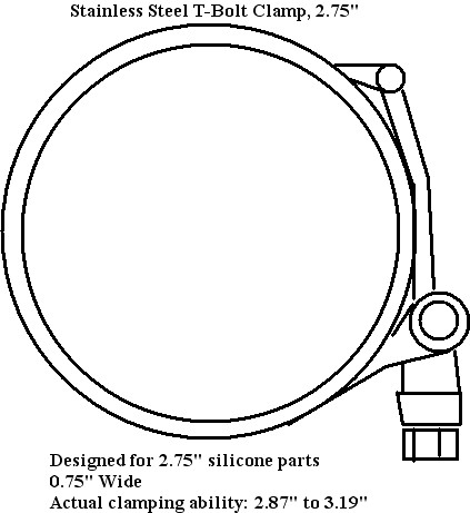

You will need to buy:
2x 2.75" T-Bolt Clamps ($2.60 ea)
http://www.siliconeintakes.com/details.php?products_id=103&osCsid=5604cd1958d675df8bc9b691970063cc
2x 2.25" T-Bolt Clamps ($2.60 ea)
http://www.siliconeintakes.com/details.php?products_id=101&osCsid=8408d78136ca61690a5a9db6bd1826e2

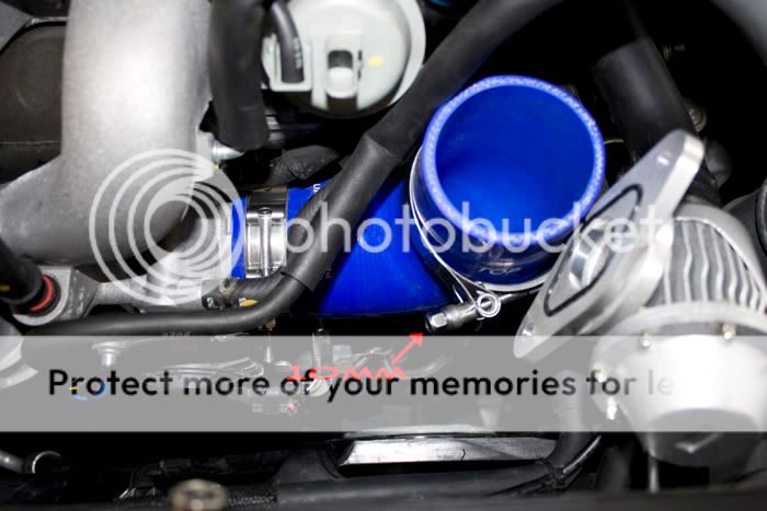

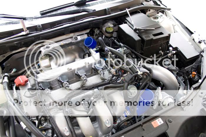

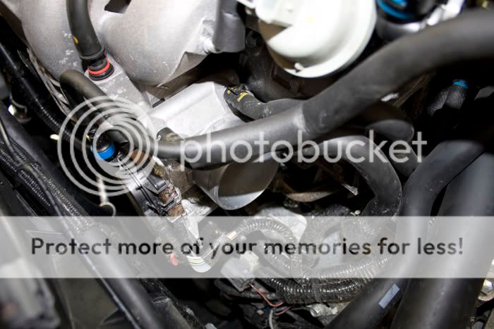

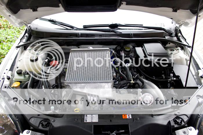

INSTALL:
Pretty straight forward...

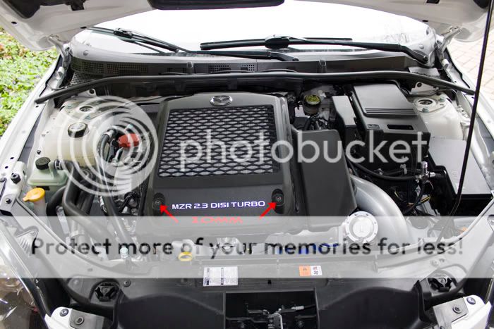

1) Open hood
2) Remove intercooler shroud

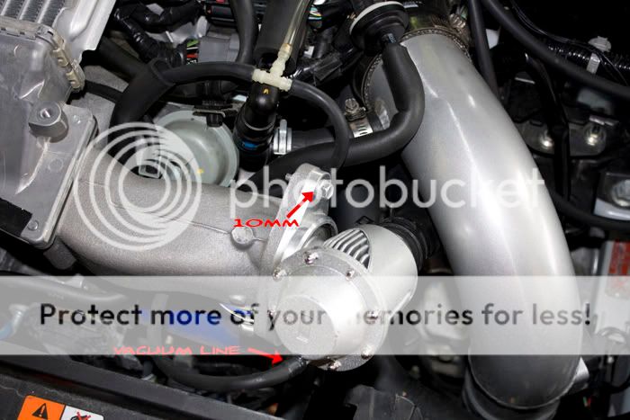

3) Disconnect vacuum line to BPV, then disconnect BPV from intercooler

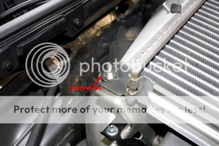

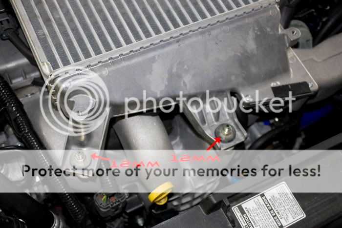

4) Remove the 3 nuts holding the intercooler in place

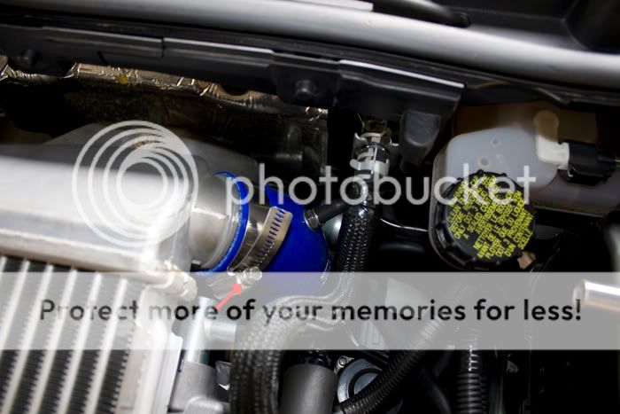

5) Loosen the worm-style clamps going to and from the intercooler
6) Carefully pull upwards on intercooler...remove, and set aside
7) Loosen the worm-style clamps coming from the turbo and to the intake manifold and remove the boost tubes
8) Replace worm-style clamps with T-bolt clamps

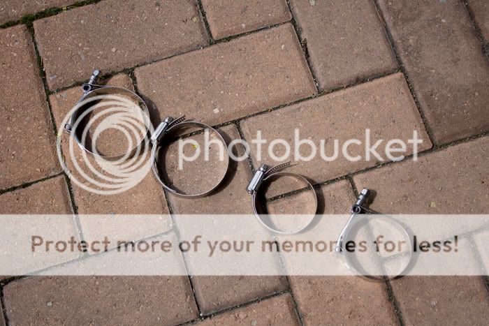

Comparison between worm-style and T-bolt clamps
9) Put back together in reverse order

1 - Remove intercooler cover
2 - Disconnect BPV
3 - Remove 3 nuts holding intercooler in place
4 - Loosen clamps holding stock tubes onto intercooler
5 - Carefully pull up on intercooler until it comes off
6 - Loosen clamps holding stock tubes onto turbo and onto the intake manifold
7 - Remove stock tubes
8 - Replace with new tubes
9 - Put everything back together.
Basically, it's the same process as the one I described in the OP

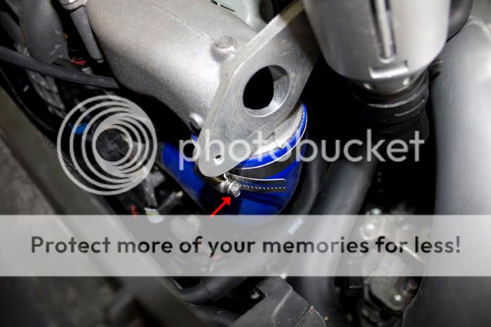

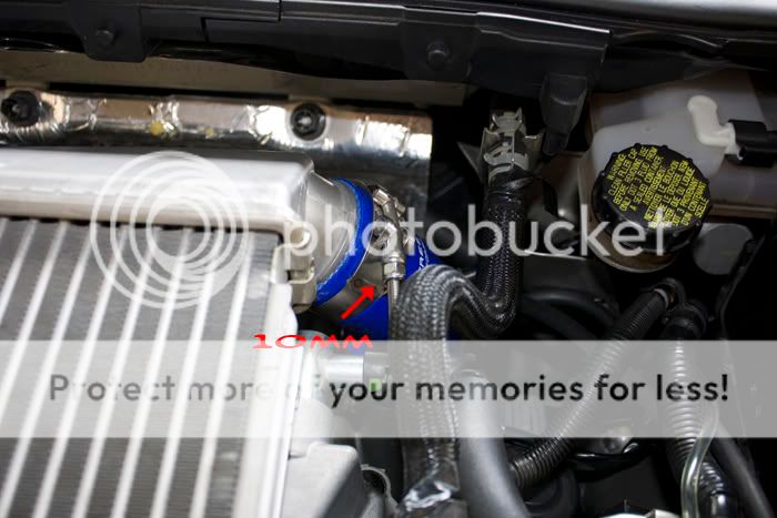

the large (cold side) clamps were a perfect fit.
the small (hot side) clamps are big, almost too big. youll need a 10mm deepwall to get em tight, and I was nearly outta thread.
Next size down, 2", IF they are big enough, would be a better choice
also, they are wide, so you need to get them well positioned over the groove machined in the tubes
absolutely secure once installed
