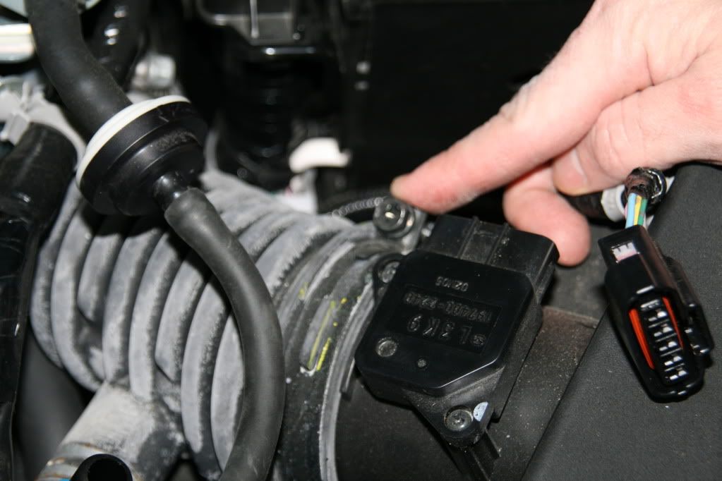

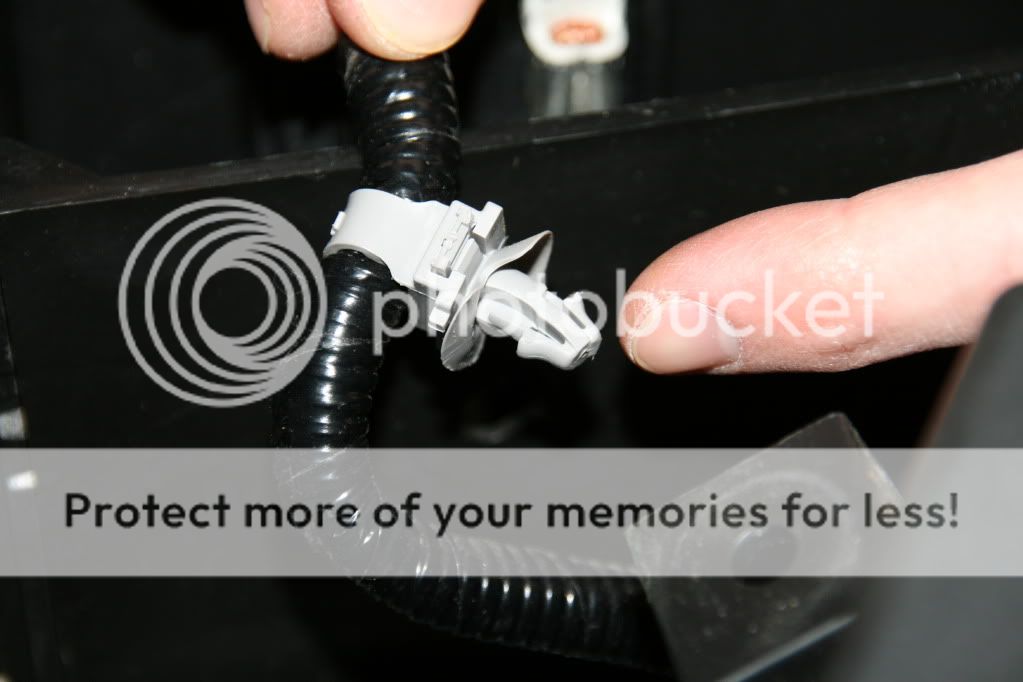

You have to then remove the MAF sensor... this is a pic of the plastic piece that clips and holds the MAF wire loom in place... reach under it and squeeze it and lift up.. a little tricky, but it looks like this once out.

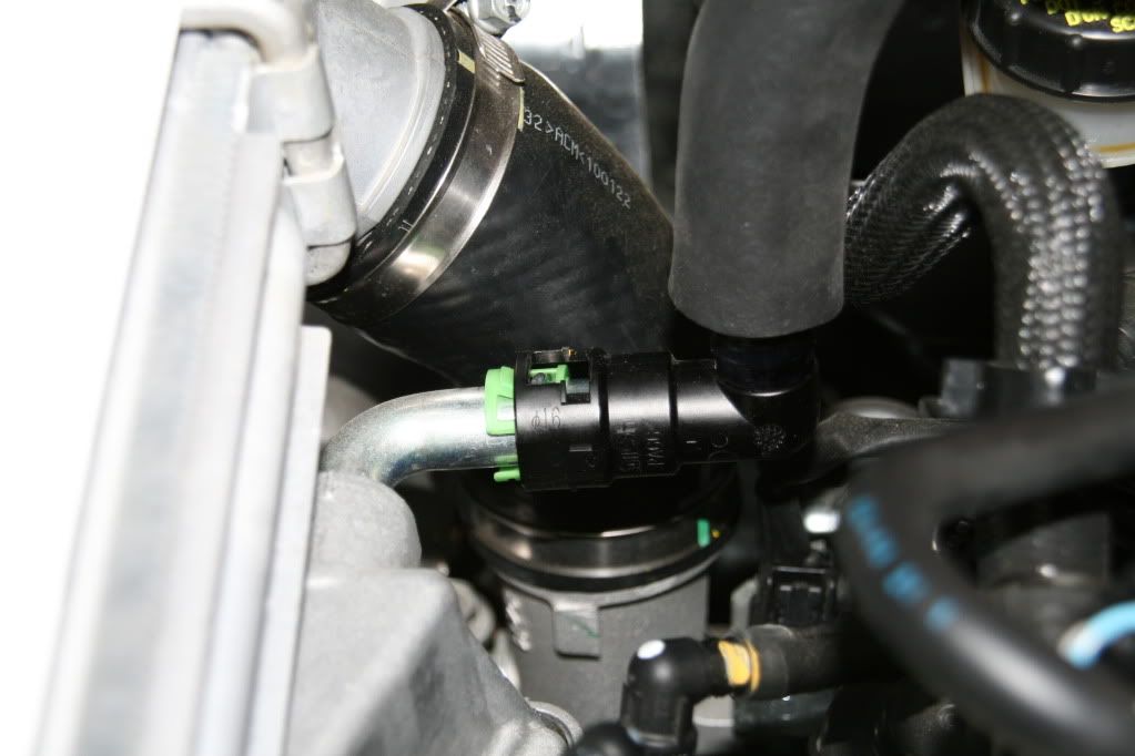

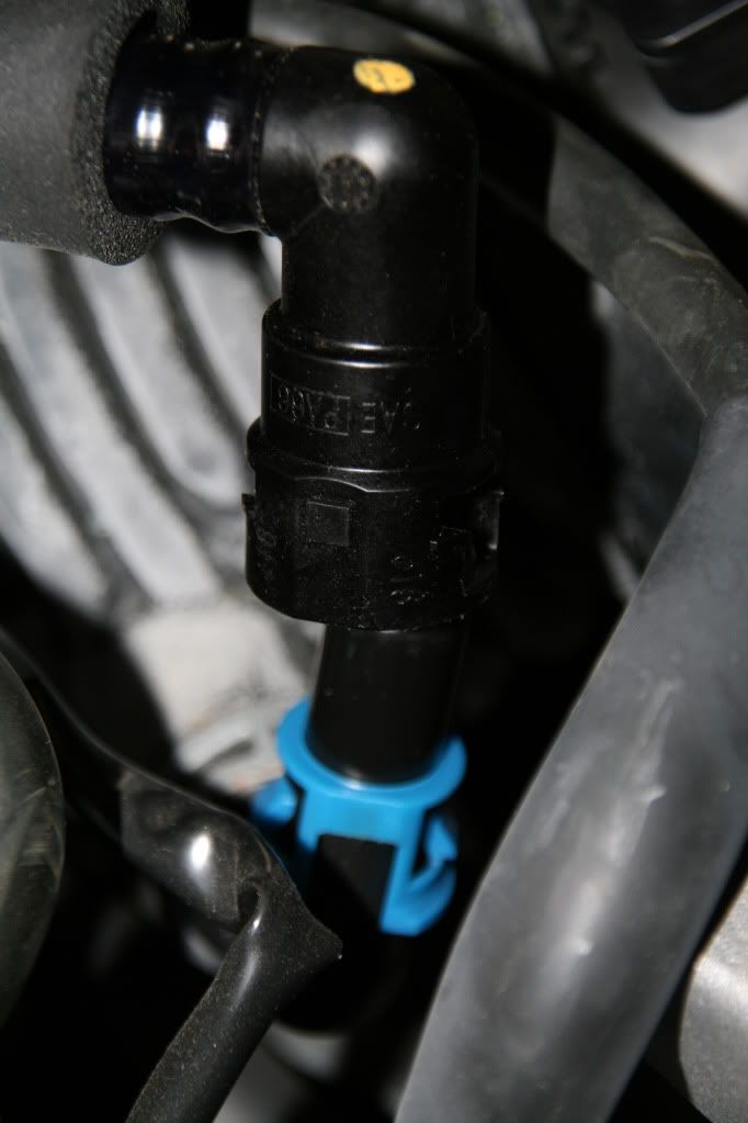

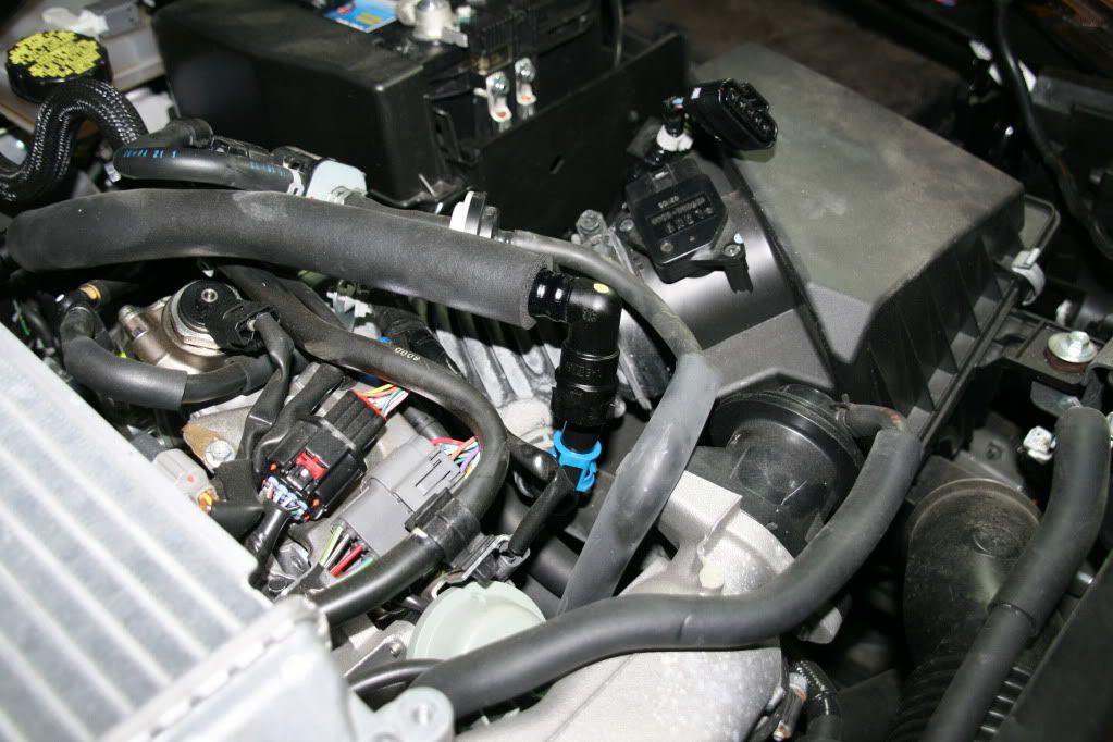

Before removing the intake box and such you will need to remove the breather tube... this is easy, but can be a little tricky... look for the blue clips that are attached at the intake tube that looks like this (note this is after removal)
The other side goes to the TMIC and the clips are green, remove these the same way and take the whole tube off and put it away.
using a screw driver to press the tabs down can be helpful...

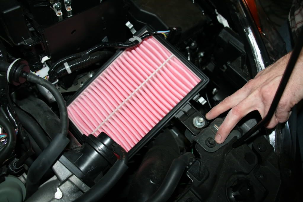

This is a pic of the few bolts that hold in intake box in... remove both of them and the bracket that you see here.

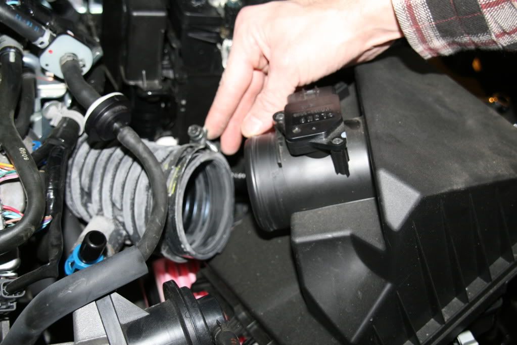

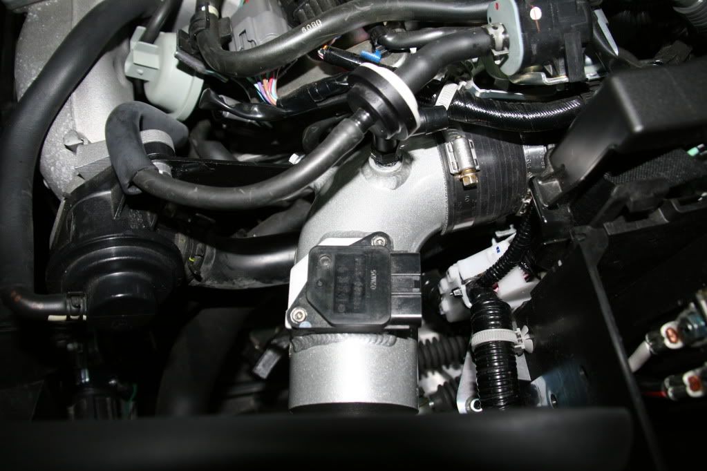

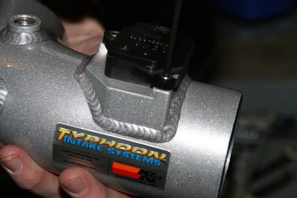

Here's a pic of the MAF unplugged... now take the worm clamps loose on both the intake box and where it clamps to the TIP.

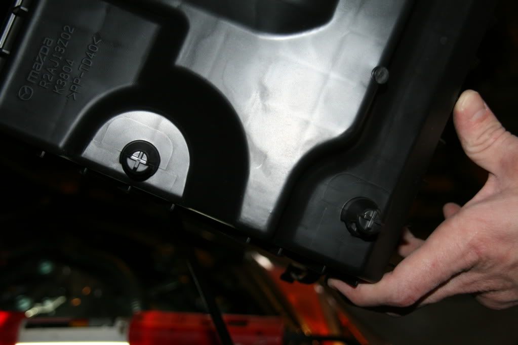

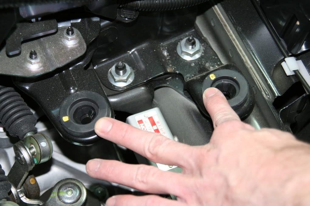

Now pull the intake tube away from the airbox like so. The airbox will still feel like it has bolts holding it on, but it's not. There are rubber grommets that hold the box in place so just give the box a good pull and it will come up.
These are the grommets underneath
this is the underside of the intake box and the two pieces that go into the grommets

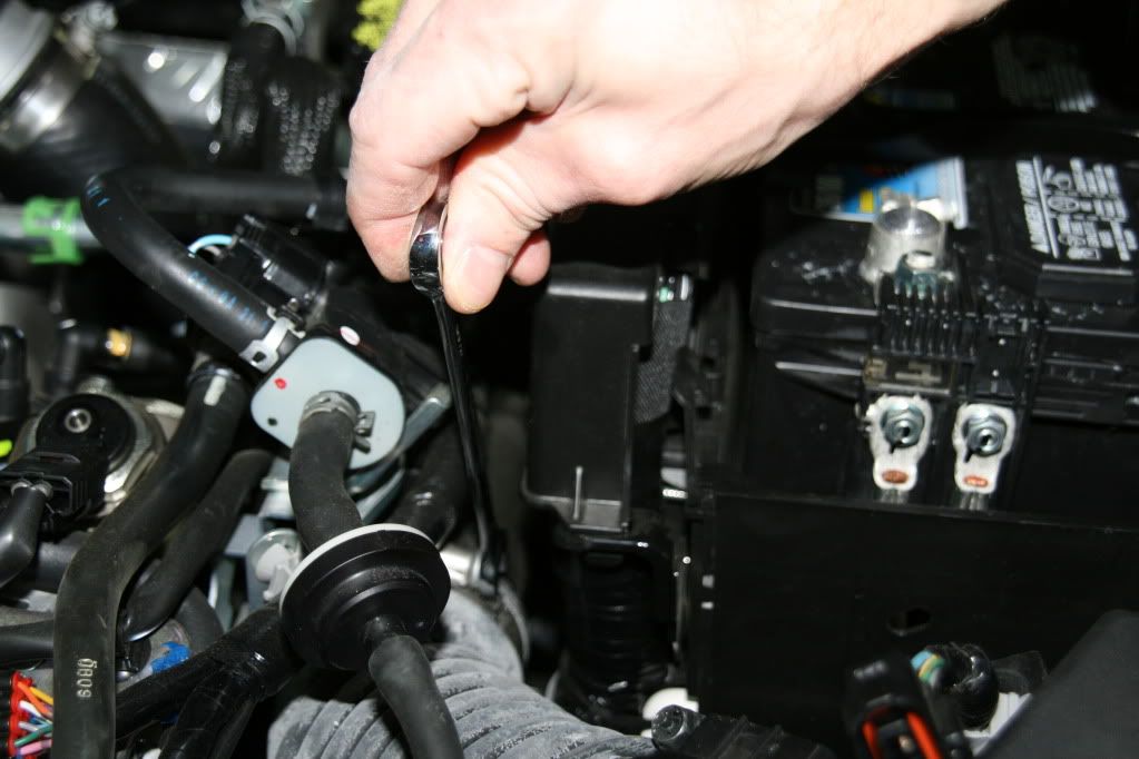

Ok now the next step is to remove the intake tube... you already should have your worm clamp loose from earlier, but in case you forgot, do it now and get it very loose. The bolt on my car I had to use a box end wrench.

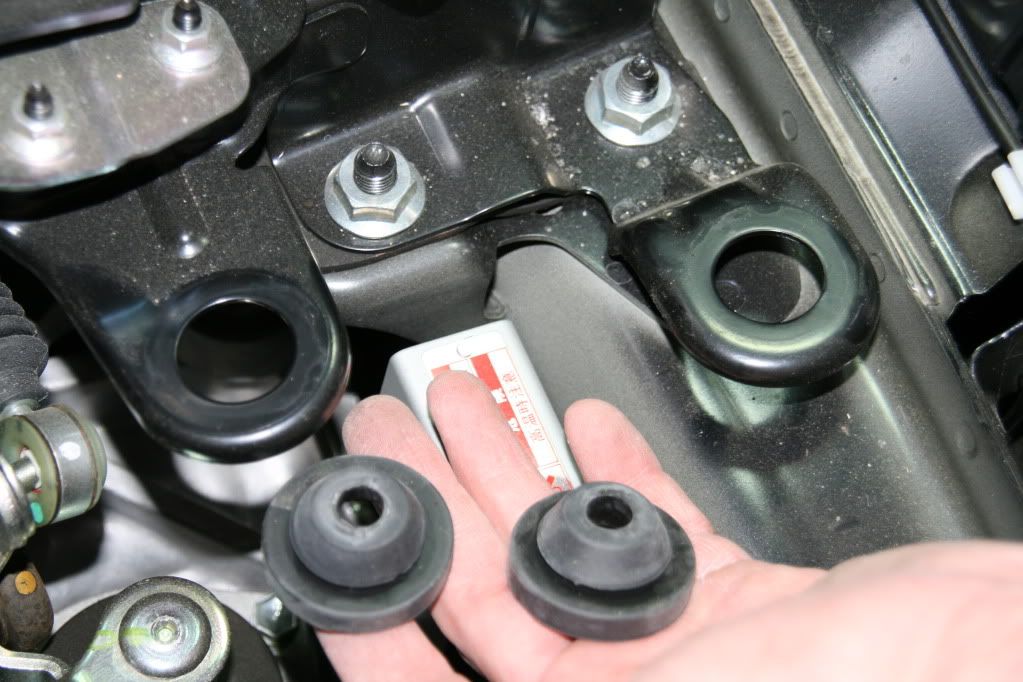

Next remove the 2 rubber grommets from where the airbox was attached... they look like this..
here they are removed...

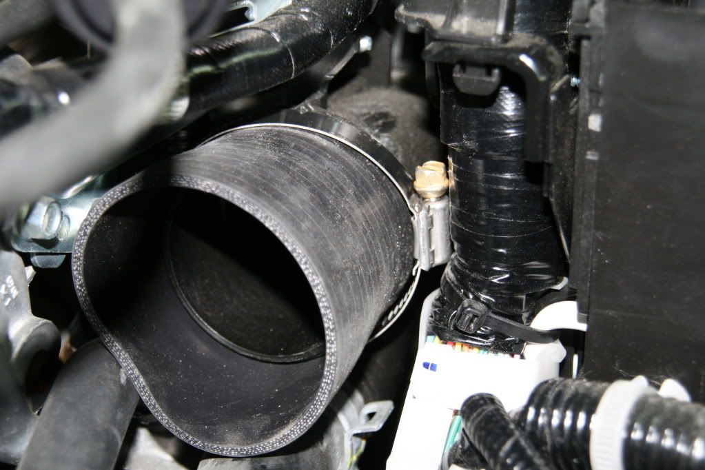

Now. put the new silicone coupler on the TIP the smaller end will go on here...
tighten down..
Notice the very small amount of room here... this will come into play later.

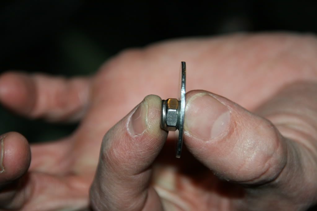

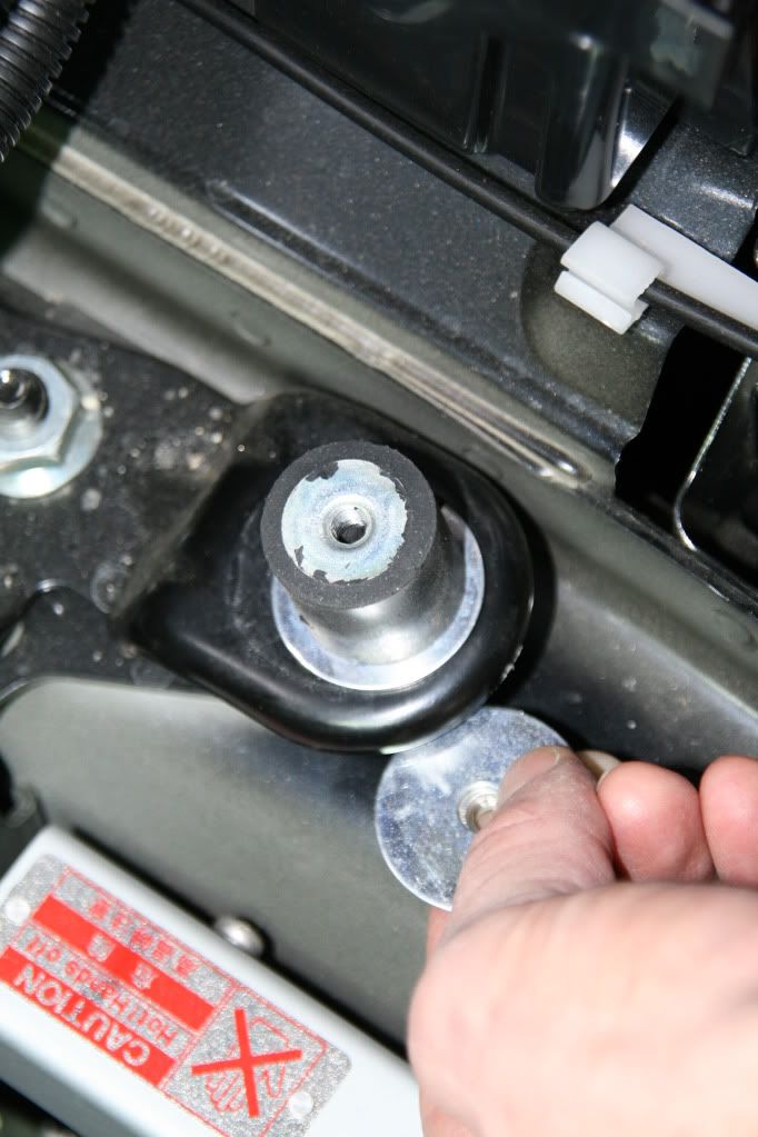

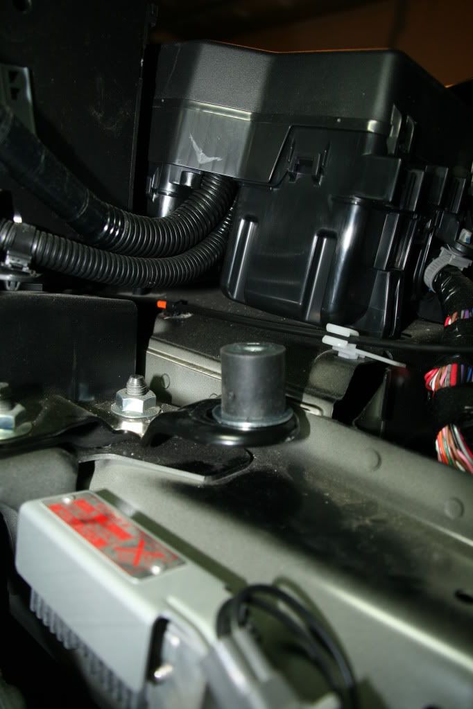

Take the rubber piece that looks like a drum and mount it to the hole where the grommet was on the right side of the car like so. You will use a large washer on the bottom and top of the hole.. the bottom isn't easy if you don't have smaller fingers, so just hold the washer and nut in place and screw the drum piece down.

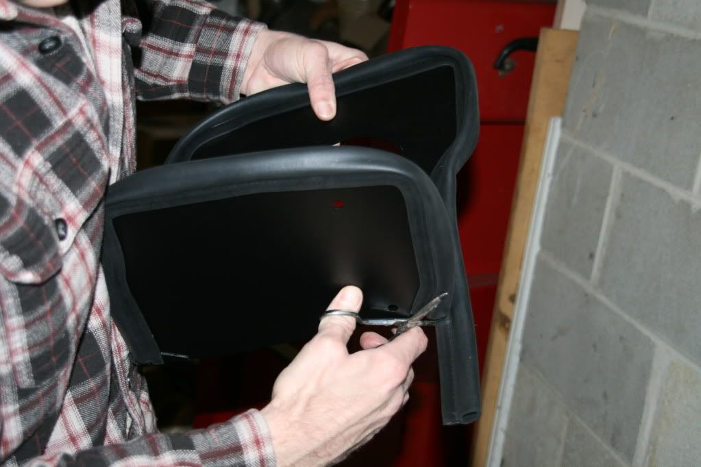

Now you can take the heat shield and use the long rubber piece needed to go around the heat shield and install it. Go around one side, and then just cut it off and go around the other. There is aluminum inside of it to ensure a good fit, just make sure it seats down on it well.
Trim off any excess and you're good to go.

The instructions will show installing the MAF sensor, and intake breather onto the main pipe... no big deal, just be careful with the tube, as it is plastic and to much pressure could break it.

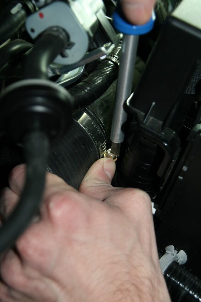

Now you will install the tube. This part is a pain because of the lack of room, so take the worm clamp, and put it on first and get it even all the way around and hold it in place.
Here is the tube installed...

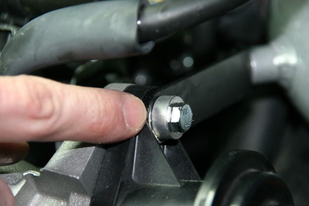

Slide the tube into place and try to keep the worm clamp from moving back to far... tighten it down with a flat head or 8mm socket. Once the tube is in place, you will take the long bolt that came with the kit that isn't threaded the whole way, and the metal spacer and with the spacer on, slide the bolt through the bracket and tighten it down. You may need to tighten and loosen some of the other parts in order to get the piece to fit just right, so you should wait to tighten it all down until everything is in position correctly.

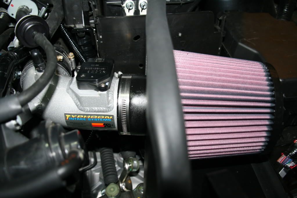

Now, loosen the worm clamp on the filter, and push it on the intake tube and tighten it down again with either the flathead or the 8mm socket.

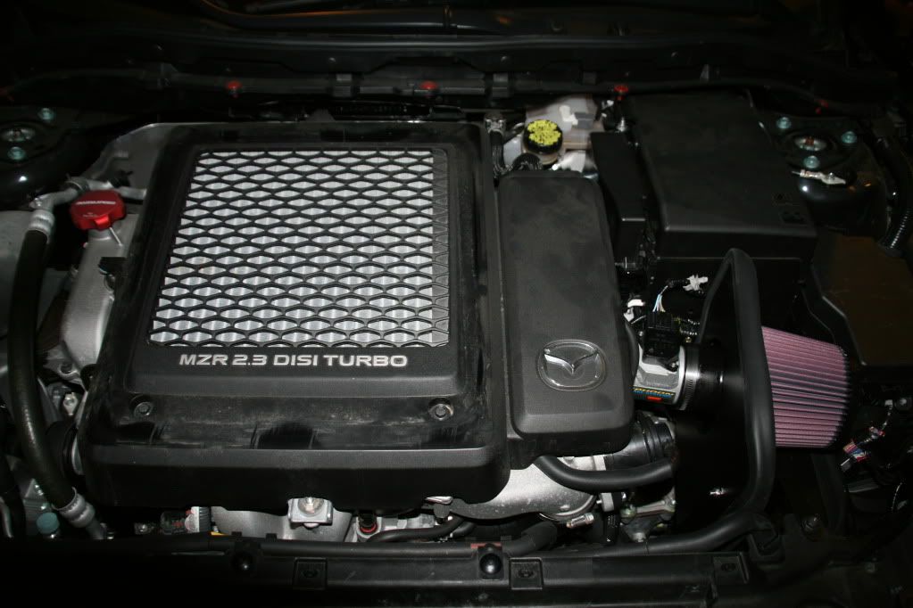

That's it! Plug your MAF back in, run your new breather tube, put your battery box cover and engine cover back on and you're good to go.
Finished:
