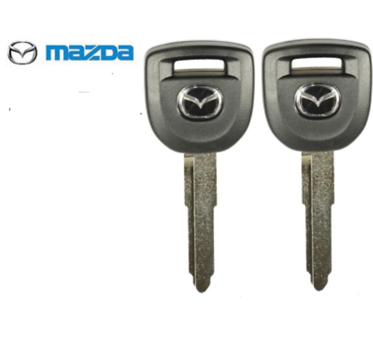

I have 2011 with keyless fob and i do not have spare fob. I bought uncut key on ebay and chip then stop by locksmith.
locksmith cut the key and it opens the door without any issue. They couldnt program the chip. Even they couldnt figure out what was wrong until i saw the chip info. The chip I bought was wrong type of chip.
so, if you buy uncut key with remote on it, you can take it to locksmith for cut. I believe they can program the remote.
when I did the process, i remember key cut was around $45, programming was $90

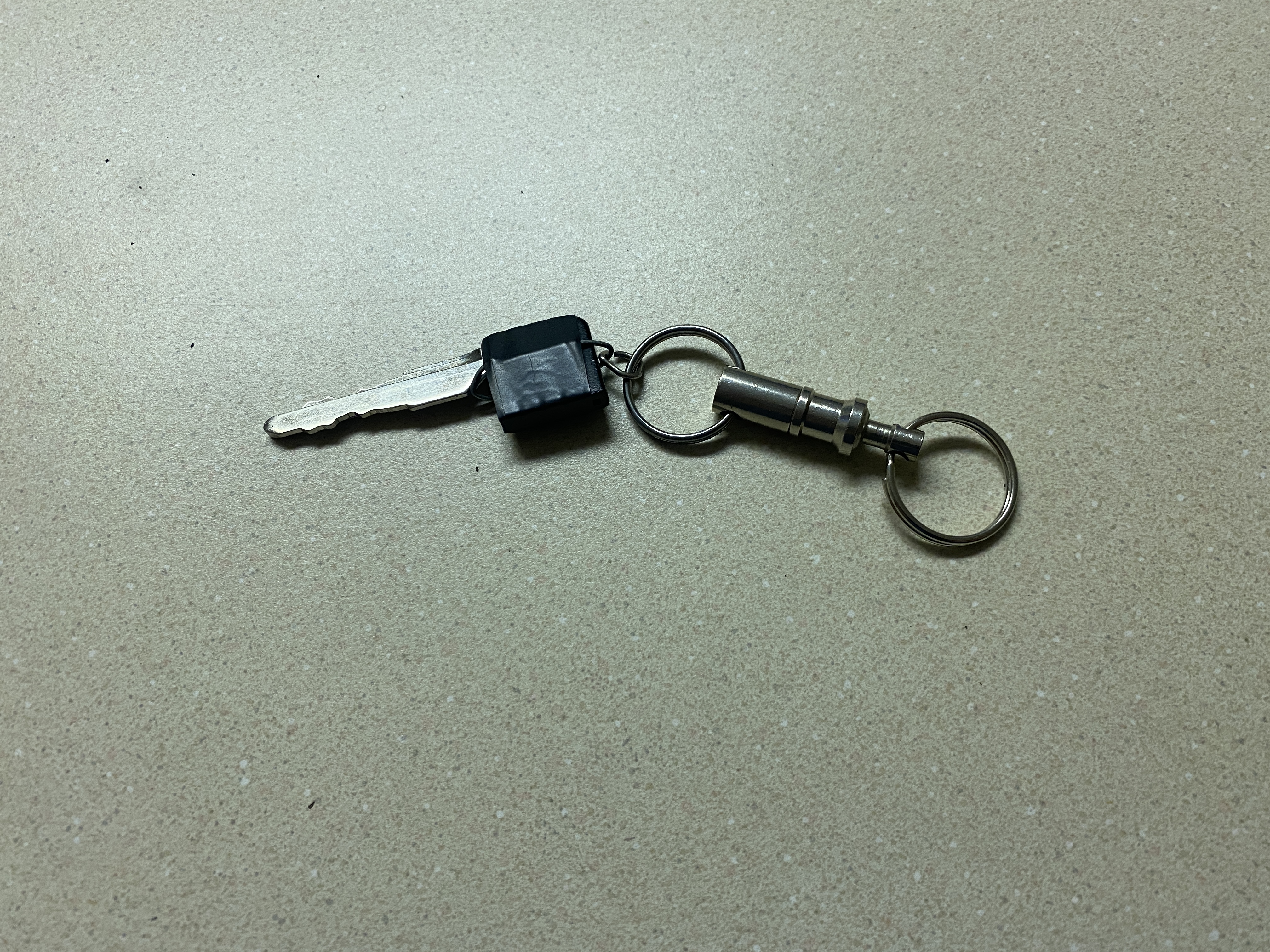

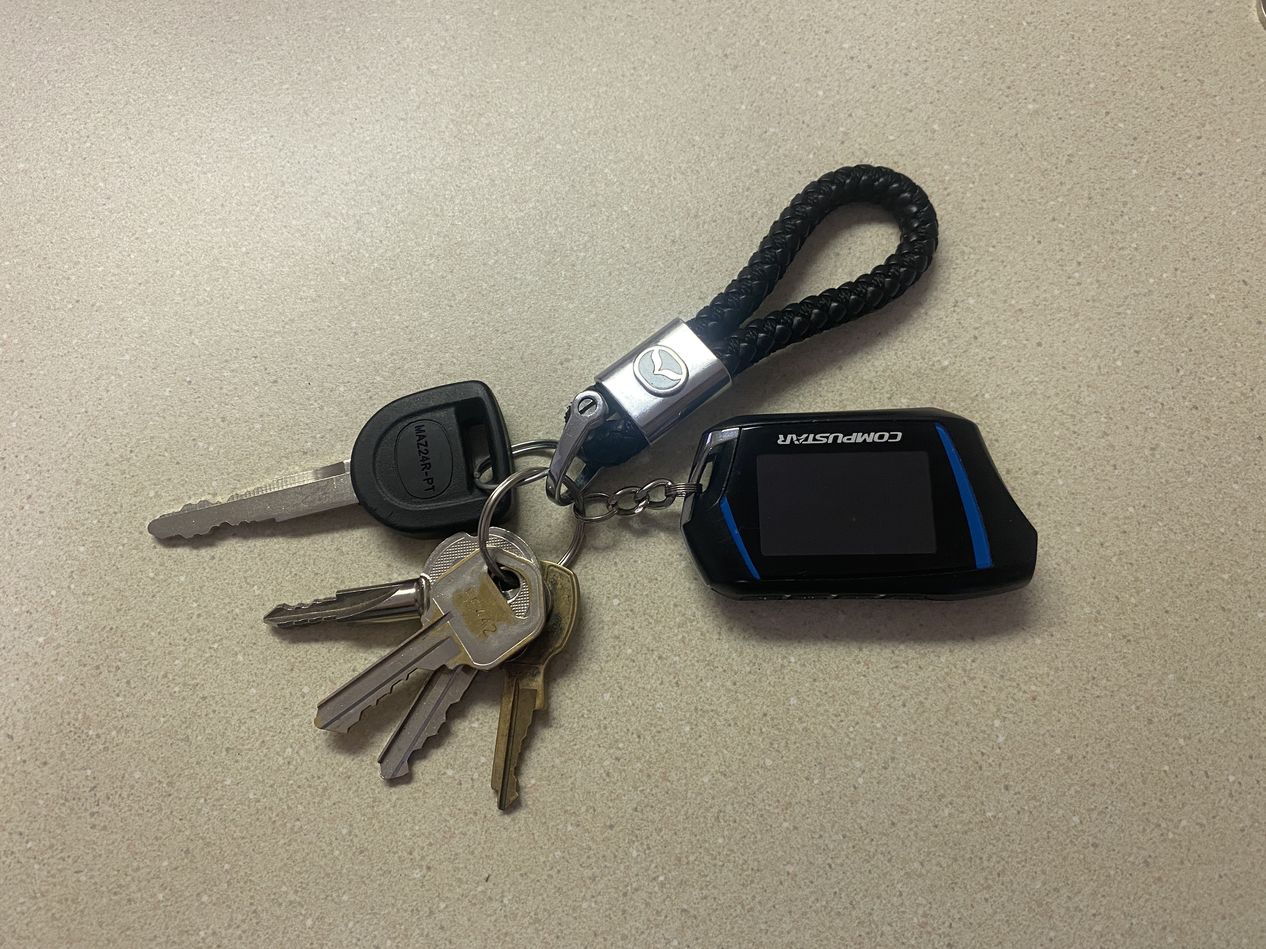

In the mean time, here is my temporary solution..... key from my spare smart-key, some tape, some wire, and a few misc keychain items, and voila! A key that can go on my keychain and be used to start the vehicle. It ain't pretty, but it will do the job for now.
I have a 2-way remote start/alarm to do all the work. The smart-key fob's two roles are to provide keyless ignition and carry an emergency key for when it fails, so all I need is a basic key.

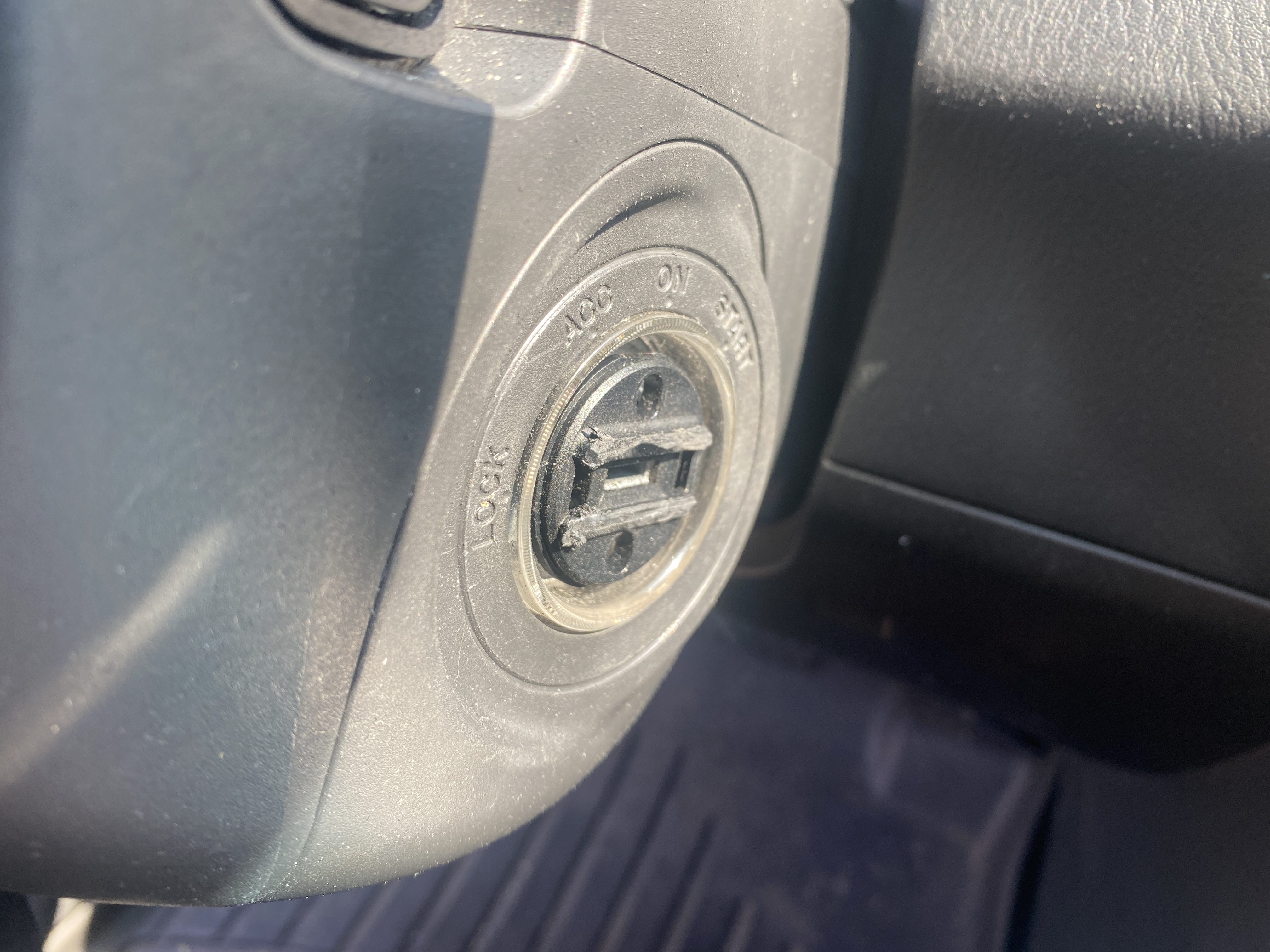

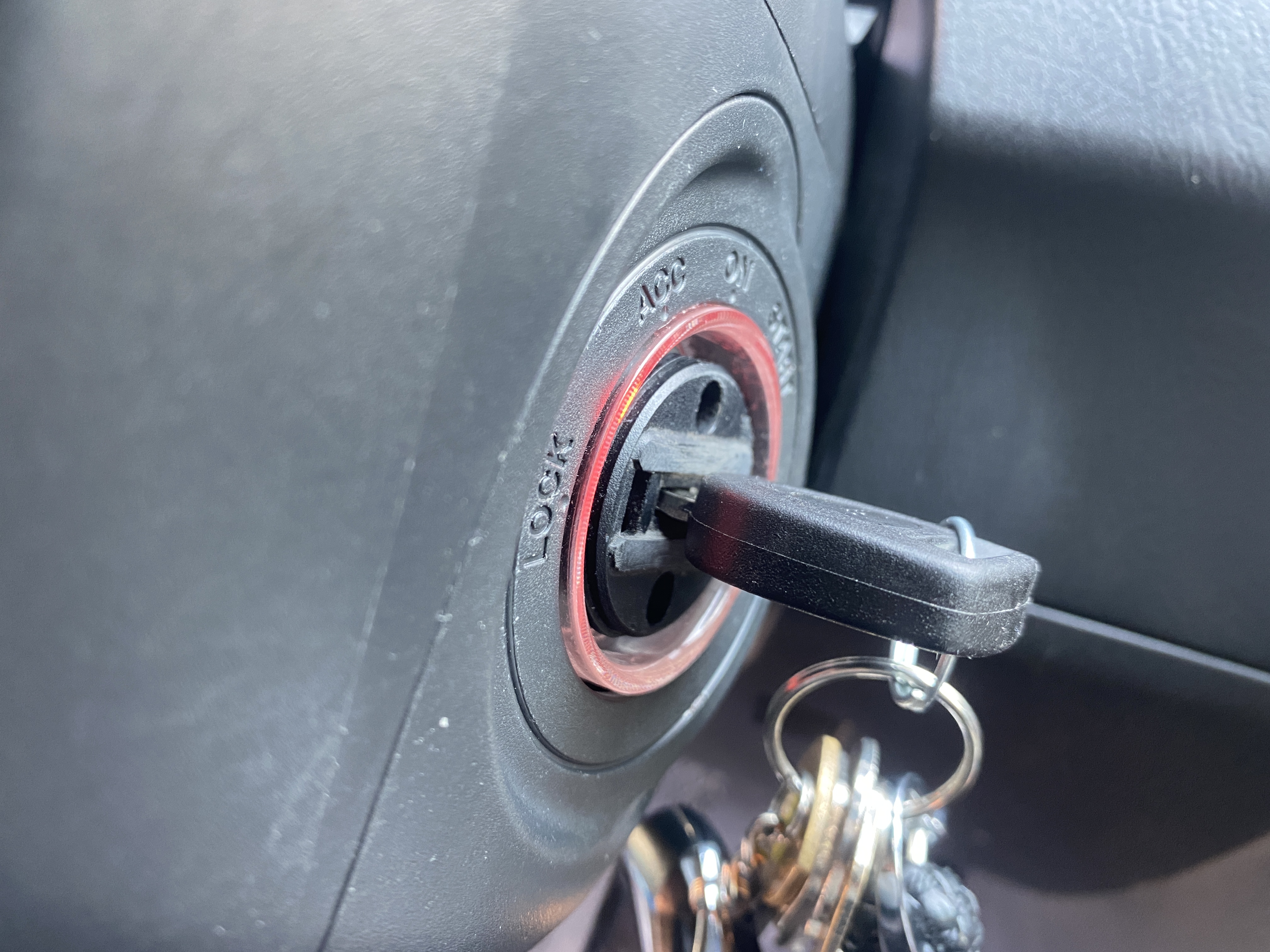

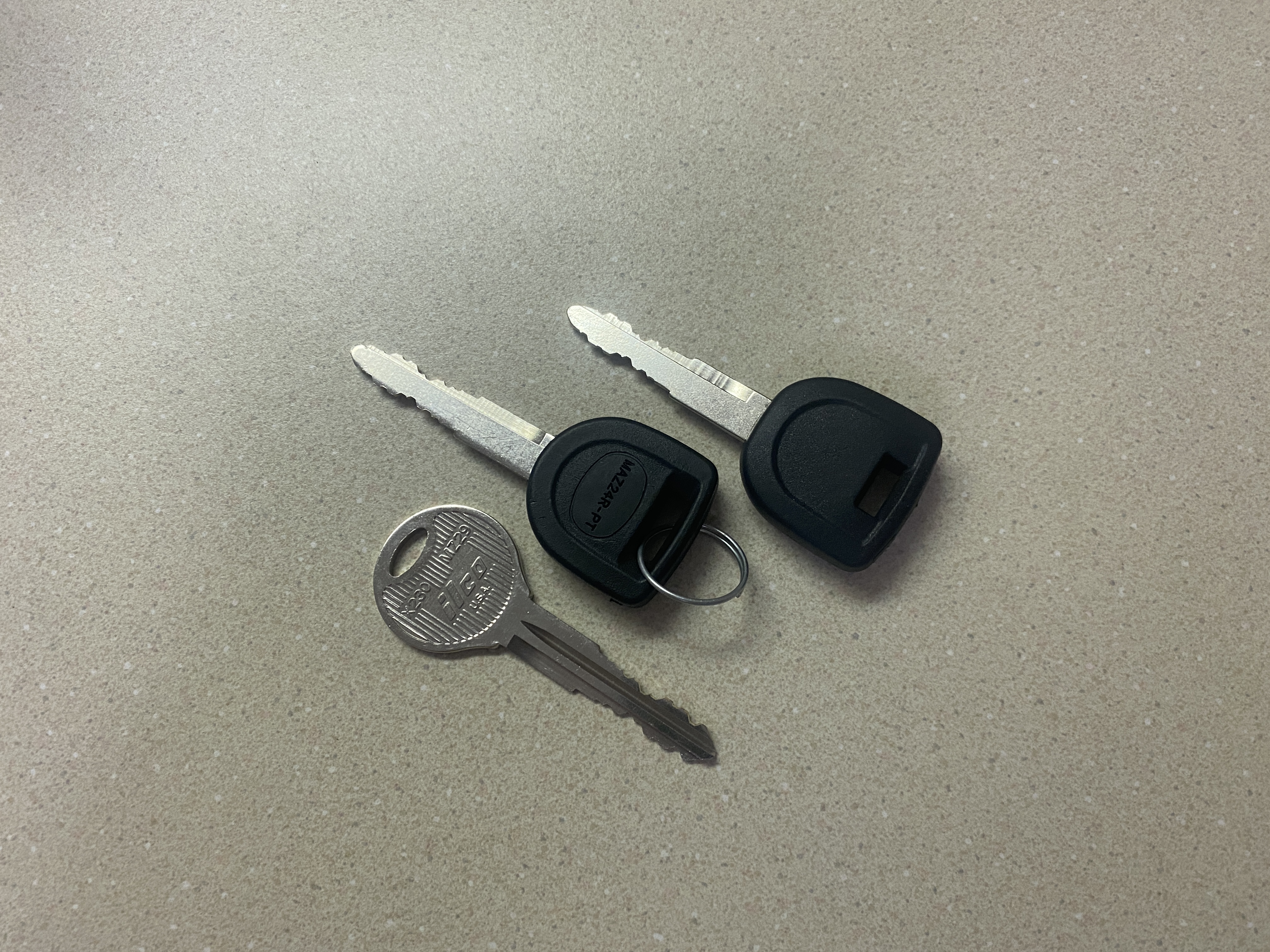

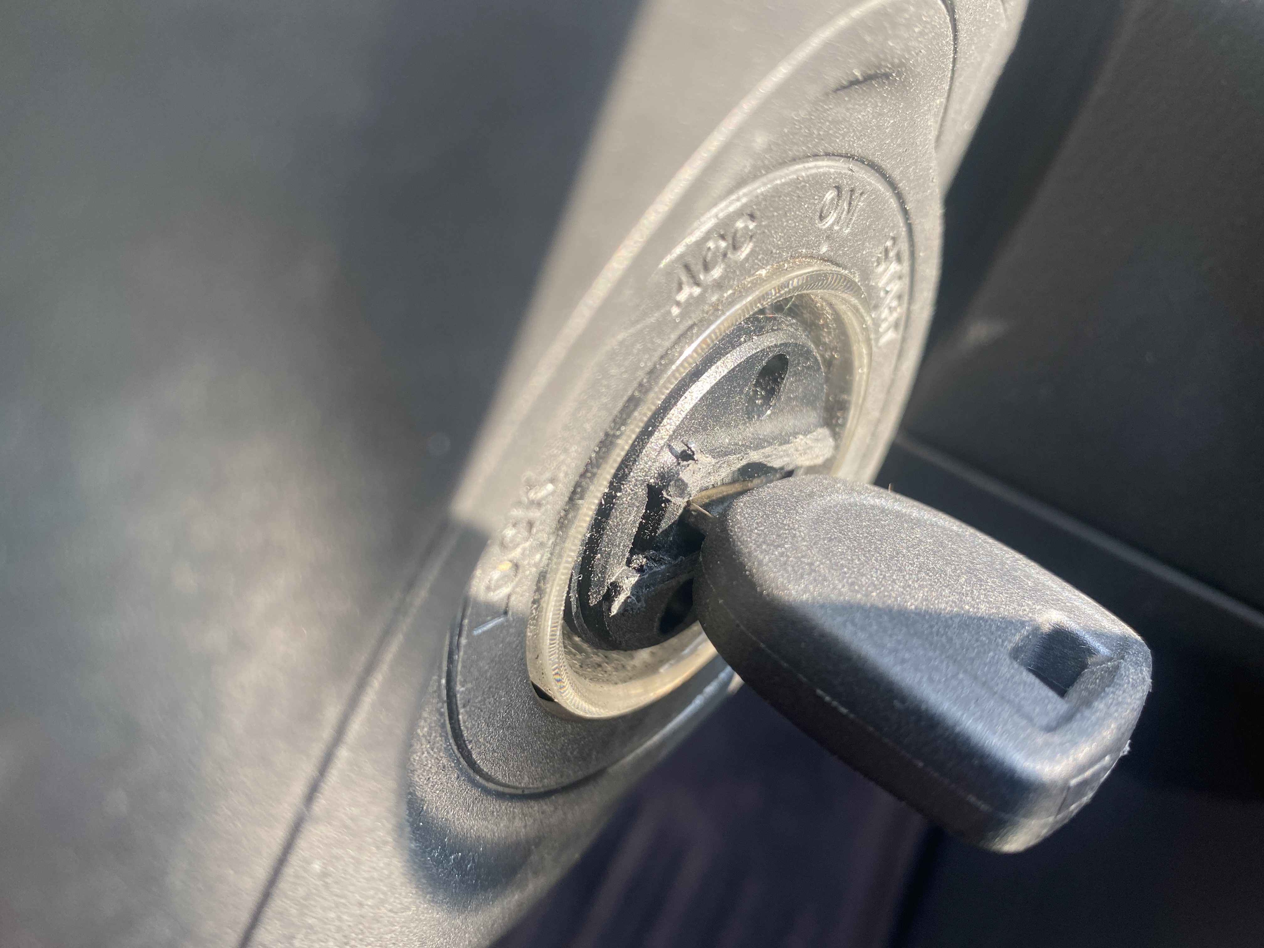

All done. Found a locksmith that knew what he was talking about, came to my house on a holiday, supplied one test key, two chip keys, cut and programmed them for $150. And I got to watch the whole process. Had to cut the two wings off the ignition cylinder to clear the key (you could force the key in), so still have to clean that up a bit.

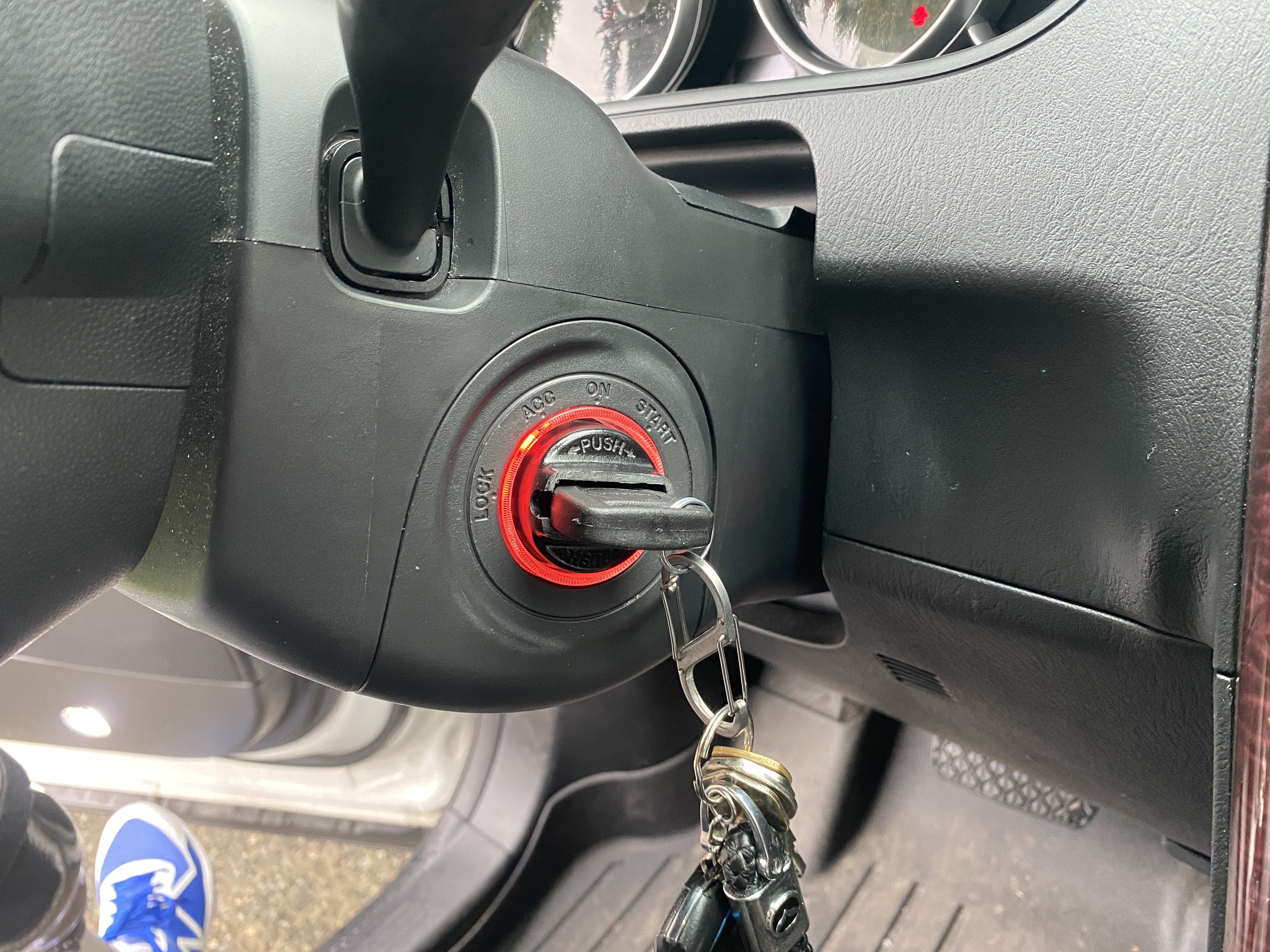

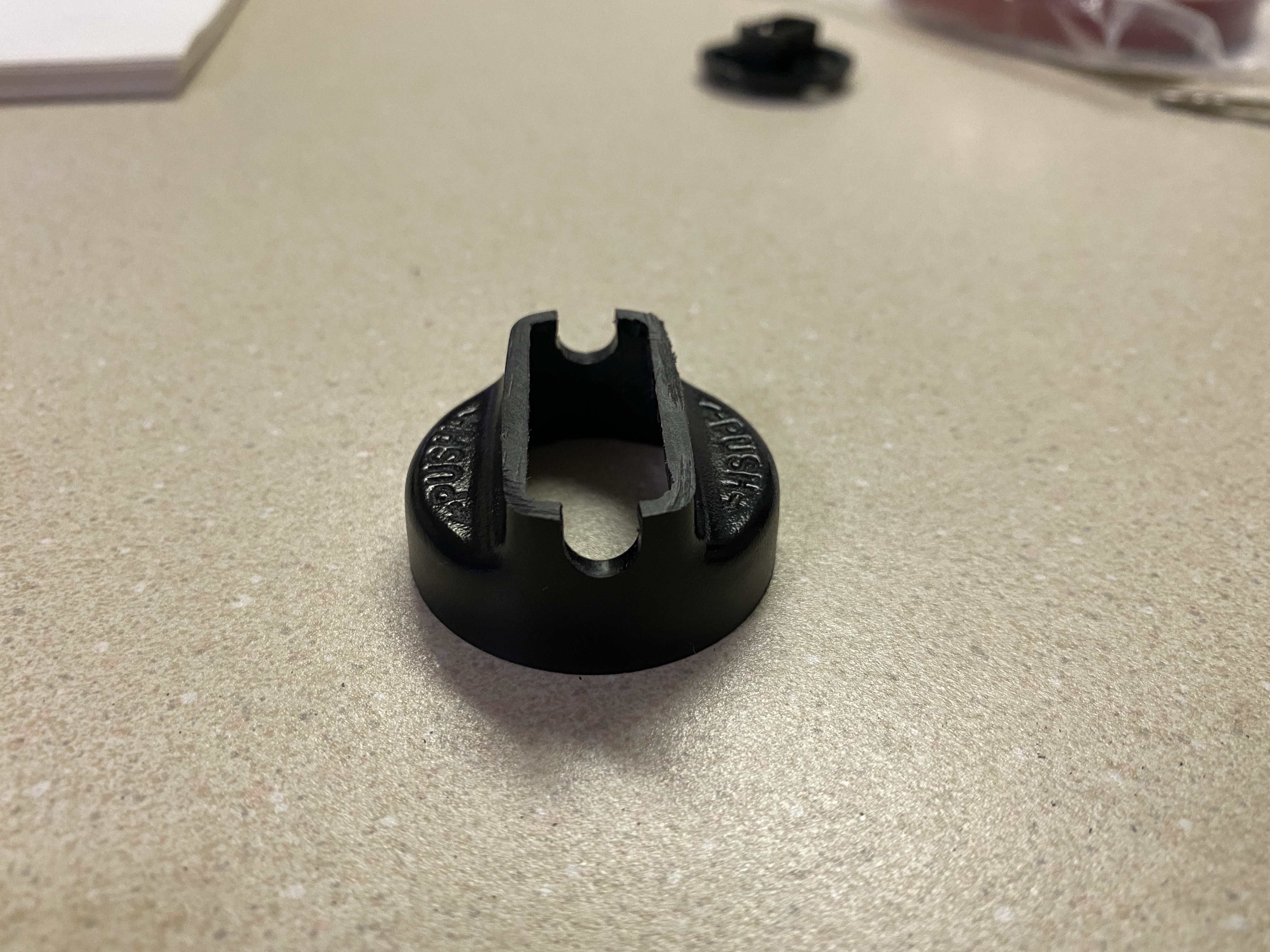

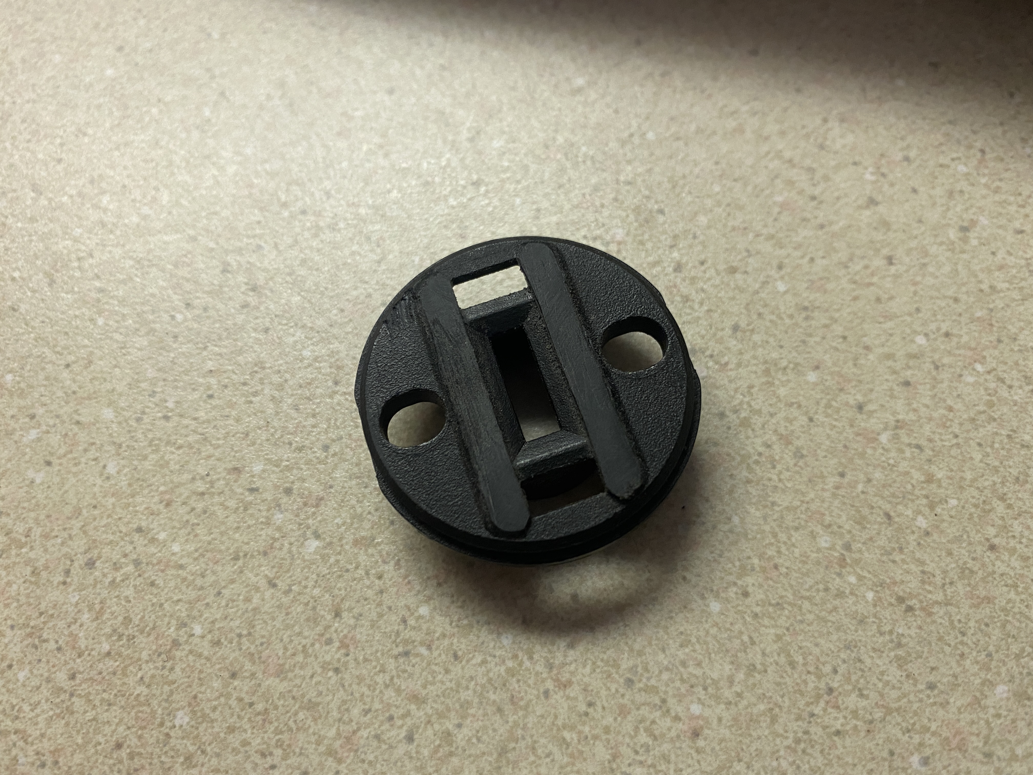

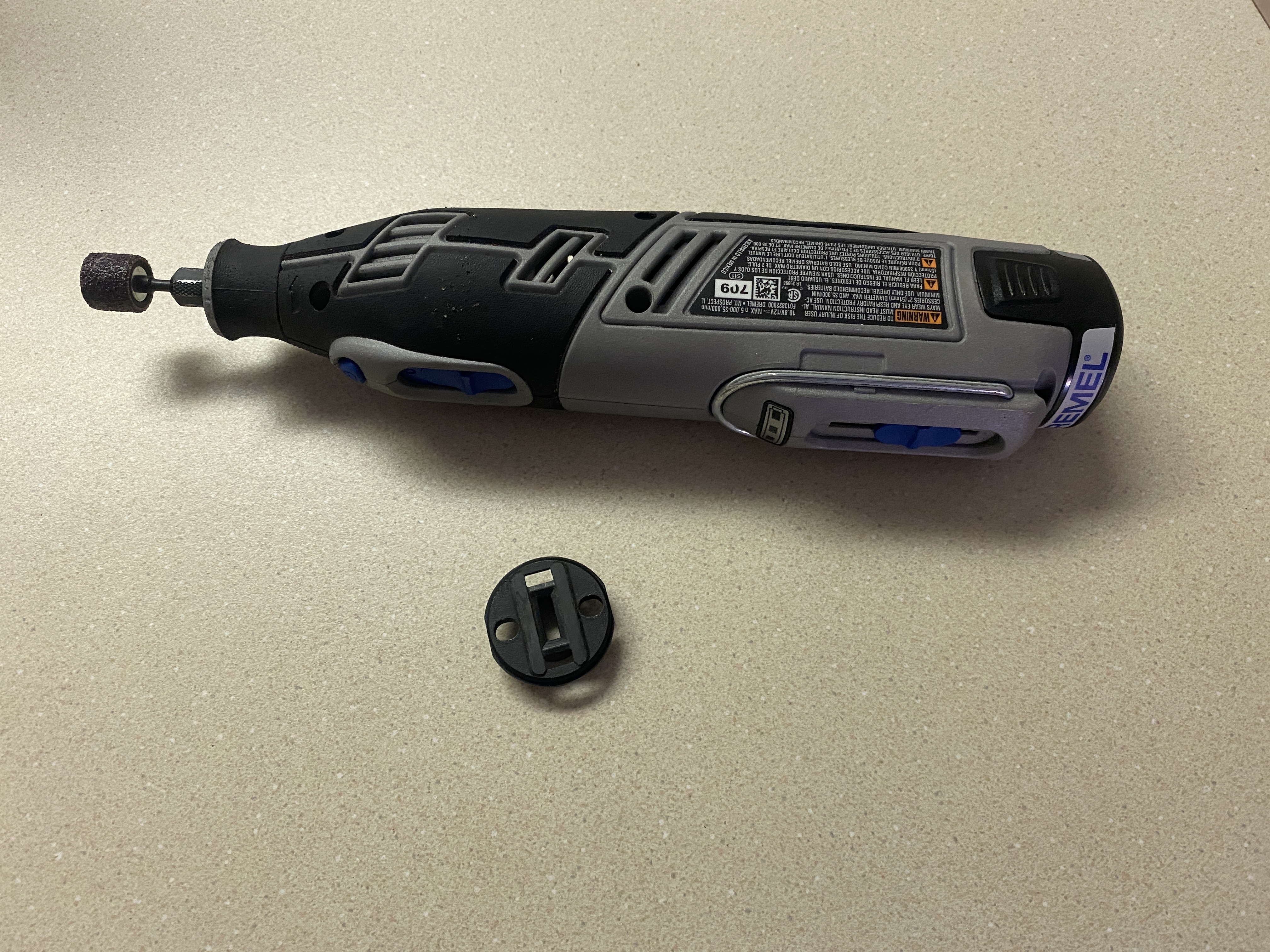

Decided to trim the cover to clear the key, and give a little cleaner look.

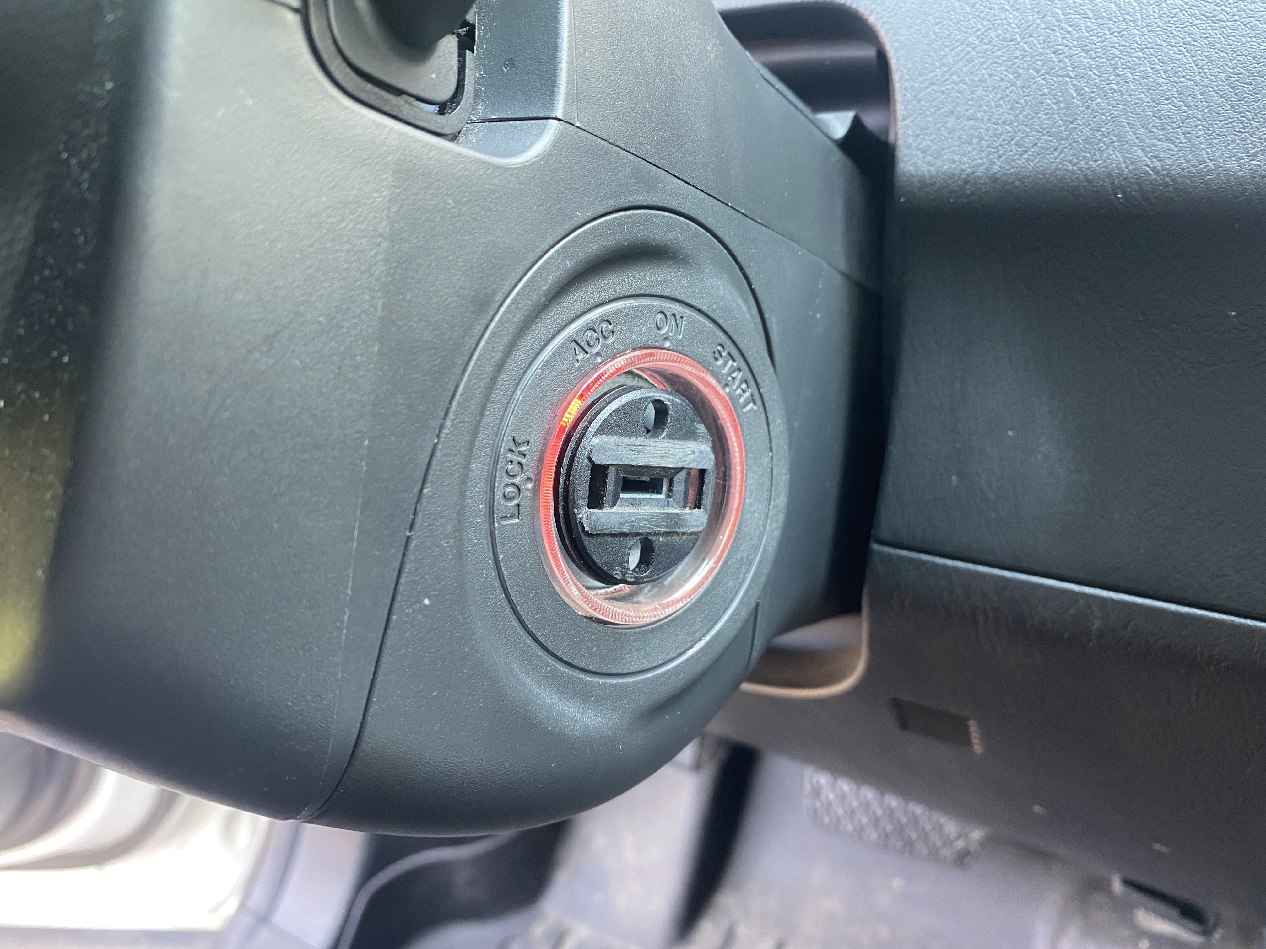

And an interesting note: when I remote start, the insert the key and disable the remote start, the red "key" on the dash stays illuminated (sometimes). When I start with the key, the red "key" stays off.
I think I will call this project complete. On to the next one. 🙂
