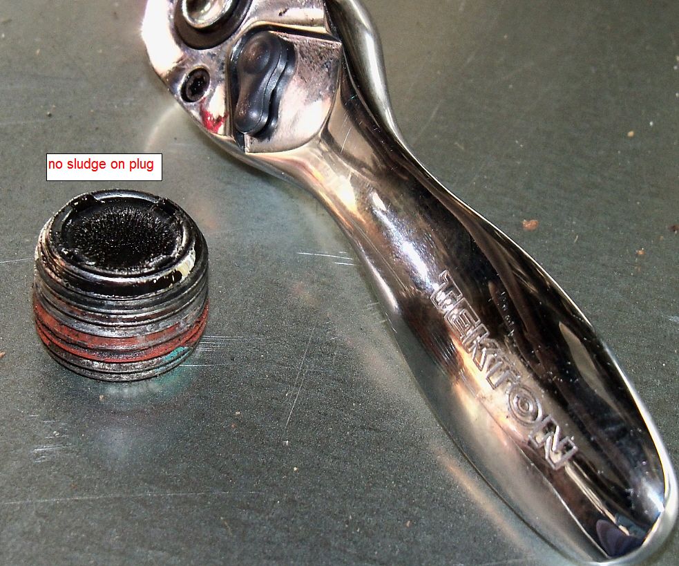

I decided to just check my drain plug today with only 5,000 miles on my new transfer case.
I had no intentions nor did I have any tools to change the transfer case oil today,
just wanted to check the plug for the heck of it, fully expecting the plug to be clean with no sludge.
I was honestly surprised, 5000 miles ONLY on a new transfer and and the plug already showed signs of sludge! not a lot BUT it's there :
I honestly don't know if this is normal and it's just suppose to be like that but I can't imagine it being good for the gears.
Anyway, I'll swap transfer case oil next week, still on the fence with what oil to go with, shortlist so far is Royal Purple, Amsoil, or Redline. Whichever oil I end up deciding to use, it definitely won't be the OEM oil.
.............Or could it be that since it's a new transfer case still breaking in there's going to be more metal particles/filings on the magnetic plug ?

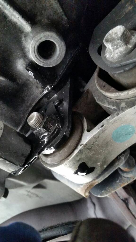

I just completed this same process on my 08 CX-9. Two days later I noticed oil drops underneath the front end of my Mazda. It was undoubtedly transfer case oil. I wiped everything clean and took it for a spin and the TC is definitely leaking. I bought it a few months ago. I only put 2k miles on it and I've changed the rear different oil and transmission oil just to be safe. I didn't know when the last time any of these things had been serviced. Everything has gone smooth thus far besides the complications with the TC. Any idea what may have caused this? My CX-9 has 83k miles on it now.
