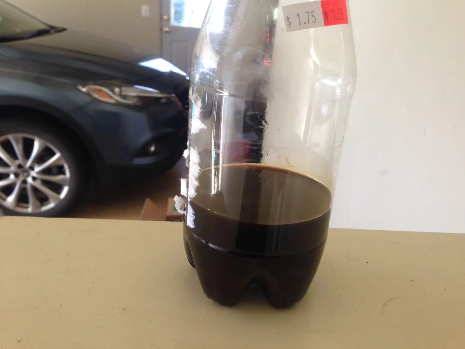

Very strange results. As I mentioned earlier I change the T-case fluid on both my 2011 and 2008 CX-9's last week. I decided to take the plug out and have a look at the magnet since doing so. Originally, there wasn't much crud on the magnet. But since changing the fluid it now has a ton of gunk on it. Weird. This is on both the CX9's since changing the fluid and only a few hundred miles were put on both. About 5 times more gunk than before. My initial thought is that the fluid level was too low to get much on the magnet collector, thus when the level was increased it now is starting to clean up the case and therefore there is more gunk now than before.
Thoughts?

That would seem like the logical explanation, since there's no drain plug and that magnetic fill plug is pretty high up. It would explain that after you refilled with new gear oil and increased the oil level high to the plug, the plug would see 5 times the gunk. So seems like the oil changed is working and doing it's job to dilute the old sludge. Probably best to suck out the oil and refill after another 1000 miles.
To follow up on the more sludge on the plug thought. I just did my transfer case today and it was the second change for me. First was about 25K and today was at just about 50K.
I too noticed that the plug had more sludge this time than the first time with the original fluid. However, my fluid was also in much better shape this time. Actually pumped pretty easy and when I poured it into the recycling bin it was much more 'liquid' than the last time. This may support the theory that the first change cleaned things up a bit by flowing better and this time around I was removing the results of that process. Sounds as good a theory as any to me.
I'm going to stick with the 25K interval as it does seem to be producing good results for me and my 2012 CX-9.

This makes sense to me too. I just changed it again after about another 250miles on my wife's 2011 and it was again very nasty looking (the magnet plug). The fluid though as mentioned was much better looking overall. Just starting to turn dark, but somewhat still clear/cloudy/black looking. So my plan is to run it for a while now, maybe 5000miles and do it again. I've gotten pretty fast at this and its quite easy once my arms are used to contorting into the strange positions to get the job done. I also went ahead and put a remote spin on oil filter on the transmission as that fluid looked like total garbage. The transmission is sealed, so go figure. This takes the normal screen filter and makes it obsolete. Felt good to put some real filtration on it.

Now, For the first time I was doing this job and it was really messy, even I was using the same electric pump shown in the first post. I ended up using entire bottle of RP - a lesson learned
1. The oil came out about 1/3 of qt, and it was not really relly bad (maybe Mazda updated PTU fluid in 2014 and up models. Must to say I have not refreshed the fluid before). It was kind of dark brown, but definitely not sludge and not black and gooey. See the pic
2. The oil definitely has clear burnt smell but not bad
3. Pumping out the oil was not a problem, the electric pump worked like a champ, but putting in was a huge issue.
4. When I was putting in oil, I was using a manual pump with wide (bigger) in and out hoses and it was a mistake. the wide hose makes spilling all over the place as it's not design for putting such small amount of oil.
So I shifted the out hose of the pump to a small one and ended up blowing off it from the pump several time. Apparently, you need to hold the pump and the hose by one hand in order keep in place.
Basically, technique when wide hose inserted into the pump and a small hose out of pump works the best for me, just maintain the pressure and do not rush

I have a 2014 touring with 65,000 miles and decided to do this. After a half an hour trip to the store I drove it up on ramps in the front and jackstands on the back so I had plenty of clearance. As you can imagine the transfer case and surrounding exhaust were extremely hot so I had to be very careful. I used the suggested electric pump that I purchased at Northern Tool hooked up to my battery charger and it worked extremely well in extracting the old oil. As someone else suggested perhaps Mazda has change their lubricant or the design of the transfer case or the heat shielding around the exhaust, but whatever the case the used oil was not that bad. I replaced the old oil with Mobile 1 synthetic oil, the same that I put in the transmission and differential of my Miata. It comes in a squeeze bottle so I simply connected it to one of the hoses on the pump and squeezed it in. All in all it was a fairly painless process. I do not feel like I need to do this again for another 30,000 miles. Thanks for the suggestion OP. Now I can sleep better at night!
Ok here is my updage after my wife drove 500 miles and i repeated the procedure. The oil came out slightly dark purple almost the same as the original color. I used the same eleftric pump to fill the case and was a right thing to do. There was not a single drop of oil on a floor. I put paper towels on the exaust pipe when the oil started coming out after overflow. That is it, do not use manual pump! This time i used mobil oil, which was on sale at advance auto parts. My personal thought it's better than the RP. Also love design of theirs bottles, as the bottle has measuring indicator which shows how much of oil you have added.
