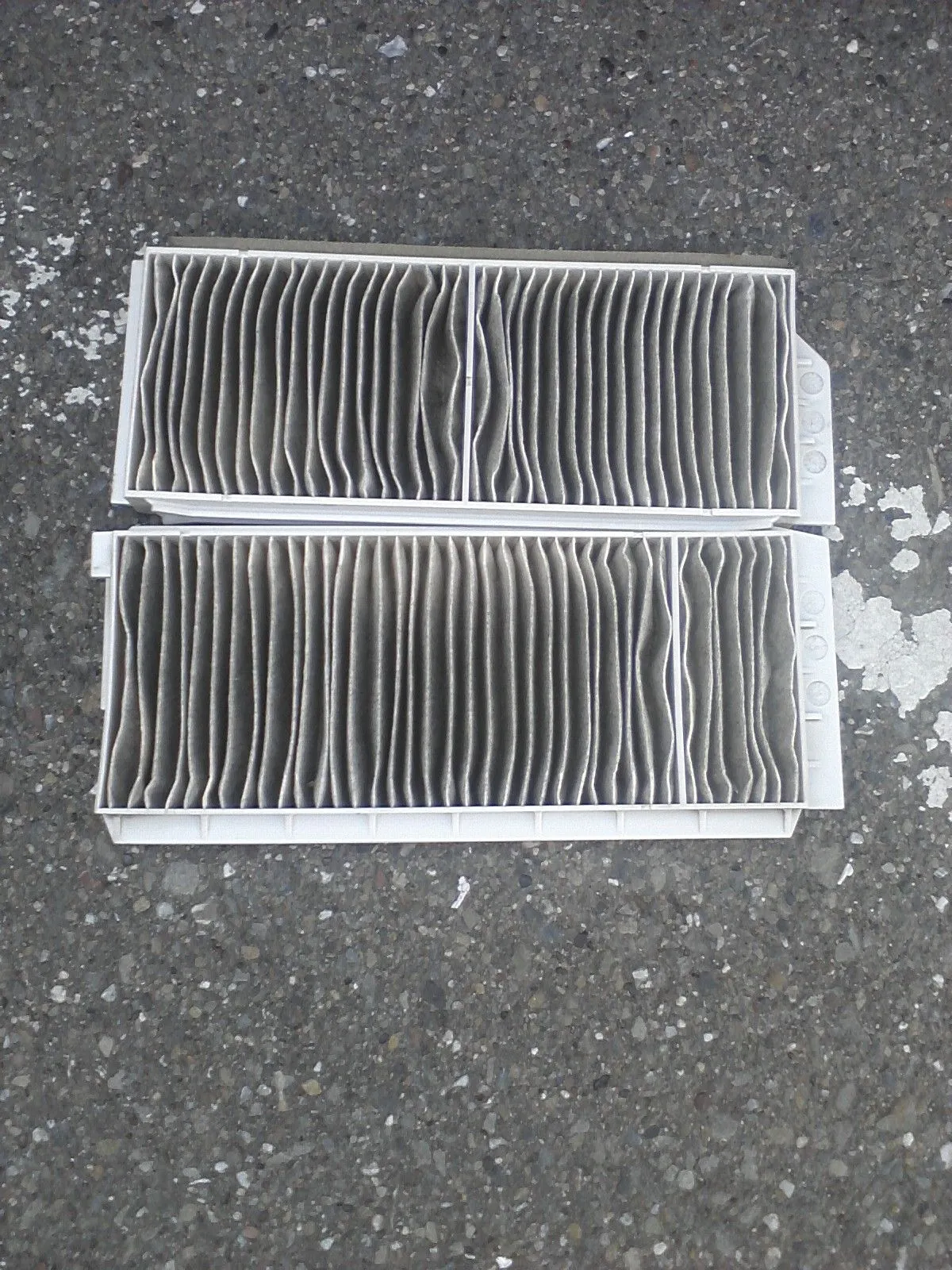

I just replaced the cabin air filter in my 2007 TG, 37,500 miles. Attached is the picture of the old cabin filter. New filter set costs $10.07 delivered off from ebay. It was really tricky to remove one top screw. You may need to be prepared to squeeze yourself.

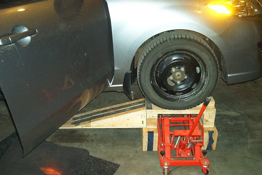

This if my first post, if I screw up picture attachment or otherwise, please be gentle. I just replaced the cabin air filters on my Canadian Model 2010 Mazda 5 GS with optional "Rear Air Vents with fan-speed control" at 36,829 km (22,885 miles). I used Mazda Part Number CE49-61-J6X ($35.41 Cdn), and followed the instructions in the video at www.filterheads.com/product/single/AQ1116 which may show a Mazda 5 without rear air vents. As suggested by the Mazda service manual, I did disconnect the battery first. The process was similar to what's shown in the video, but I'm guessing they had the vehicle on a hoist in order to access the parts. On the basis of an earlier post suggesting having the vehicle on ramps, I drove my vehicle onto ramps, and then jacked the ramps get the front wheels 14" off the ground. While this might make the job easy for a young, small, flexible person, for a late fifties 6" 210 lb guy it didn't help with removing screws though it probably did help with removing the plastic panels under the glove box and beside the foot well. Perhaps hoisting the vehicle 3 feet or so above the ground would be worthwhile for a big guy to do this job. In order to remove the 4 screws, I moved the seat as far back as possible, and fully reclined the seat-back, then sat backward on the seat, with my feet up beside the headrest, my back on the seat bottom and my head underneath the dash. I placed a light coloured towel on the floor to help reflect light onto the air ductwork in order to see the screws (only 4 need to be removed), and did not find it necessary to disconnect the electrical connectors. YMMV. I did mark the filters prior to removal, in order to get the orientation of the new ones correct, and marked the new one prior to installation. Perhaps because the front of the vehicle was in the air, it wasn't difficult to hold the top filter in place in order to insert the bottom filter. Hope this info is helpful to someone.Used Filters As Marked Before Removal New Filters Marked Before Installaion resized.webpRamp plus Blocking 14 inches high IM000797 - resized.webpUsed Filters As Marked Before Removal New Filters Marked Before Installaion resized.webpRamp plus Blocking 14 inches high IM000797 - resized.webp
