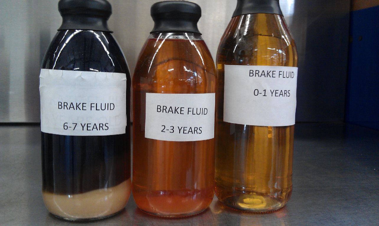

Going through a similar 'changing the brake fluid' conversation on my motorcycle forum. It seems that some of the guys haven't been changing the fluid in a timely manor and now have developed issues with their ABS pumps. A couple of them completely lost the rear brake because of corrosion in the system. The pump can't be repaired and must be replaced. Not cheap.
This is what can happen after the fluid absorbs moisture.
I do not think that most people understand that the fluid is DESIGNED to absorb moisture. And such is the reason for a 2-4yr replacement interval, higher in more humid and tropical areas.
Once the brake fluid has absorbed as much moisture as it can hold, the excess moisture now settles out to the lowest points... Lowest points often include ABS pumps, Wheel Cylinders, brake calipers, etc. Now that these parts are filled with water, instead of brake fluid, rust and corrosion accelerates, or even failure from low temp freezing can now occur.
Now you can add what a 19-year-old Honda brake fluid looks like when I have a chance to flush it. But by looking through the reservoir of my CR-V it looks much better than 6~7-year brake fluid in the picture! I did have a first-hand experience where the water, which is heavier than brake fluid, settled at brake cylinders and corroded the cylinder wall! Yeah brake fluid requires periodical change but I wonder why Mazda doesn't put that into factory recommended maintenance schedule like Honda or others does?
Perhaps because that would add additional cost to the all important "COST TO OWN" figures in the JD or Consumer Reports...
