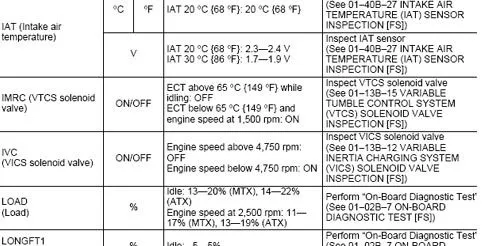

Im not sure of the exact code.. but your car has the P5 ECU so most likely that is what is throwing the code, someone else will confirm the exact code #.
The MP3 ECu lacks VTCS which the P5 ecu is searching for, so it throws a code.
There is a thread in this section of howto fix the mp3 cel problem. If this is in fact your code.
i was trying to research the code that should come up from the ecu, and it did not look like a similar code or a similar description. if it is from the ecu swap, i can work on one of the many workarounds people have suggested.
check out the attachment
woot. i understand. i will fix the ecu vtcs problem.
i just didn't see the direct connection between the imrc and the vtcs until you posted that attachment.
thanks.

not to say that you're talking out of your ass, but did you see the attachment domino2k1 posted?
it associates IMRC with the VTCS solenoid, and IVC with the VICS solenoid.
i found that attachment in the manual i have.
wouldn't it be possible that 2009 is a cel code that points to a problem with the same solenoid, just interprets the problem differently?

so in reality the accuracy of these codes when they are not defined in the mazda workshop manual is questionable. the 2001 protege manual i have does not include the codes that may be resulting from the p5 ecu. so in reality, all the codes may be interpreted inaccurately unless i have the workshop manual pages from a p5.
i will try the solenoid fix. i should get the solenoid in a few days. at this point i just believe it's easier to try to eliminate the code by using the fix for the vtcs solenoid than to try to second-guess the only information i have been able to find. i do thank you guys for your assistance in this matter.
Ahh, I see.
Well, that's why I said it was just a theory...cuz I didn't know.
But yeah, I agree, it could just be a diff code from the same issue. It's just odd that a lot of people haven't seen that particular code before. You might as well do the fix anyway, since you have to, and then see if the code is still thrown.
