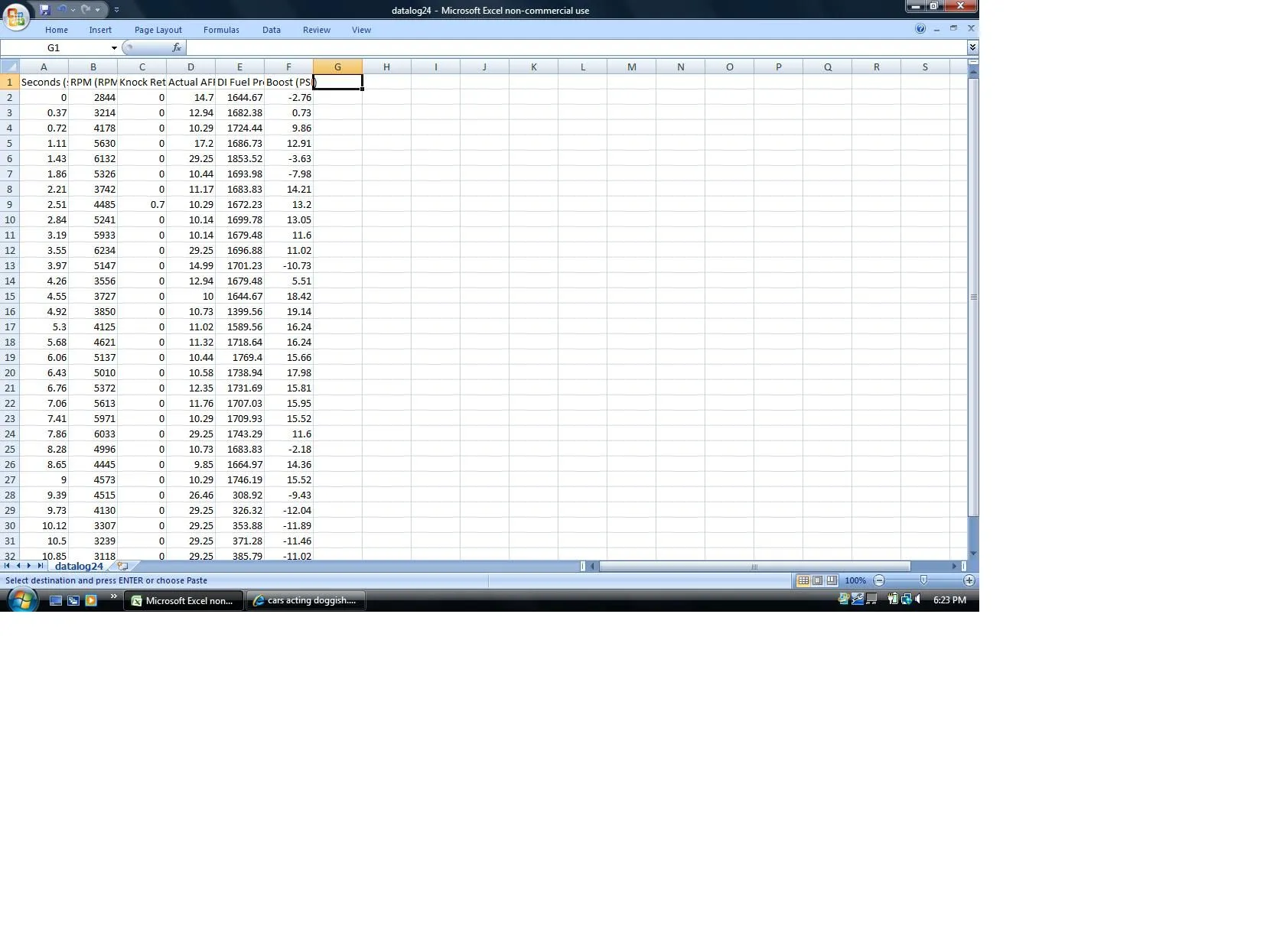

i was doing a few fun fun pulls and luckily i had it in fuel pressure mode. it hit about 1300-1400 once from a 2nd to 3rd gear pull during WOT in 3rd. i said to myself....****. lol.
i did about 3 or 4 more pulls, 1 time it did it again from 1st to 2nd. but then didnt do it anymore on the last 2 pulls. now during the last 2 pulls i did a launch to 4th gear and it didnt show a fuel pressure below 1700 but, it felt like someone was blocking my intake. no, nothings blocking my intake.
im need to change my intake filter but cant seem to figure out why its acting....wierd. im going to go get some gas so ill do a couple data logs to see how its all running and ill post them tonight for eveyrone to see. i think shes running alright otherwise though. hmm....this sucks, i have a FMIC on the way too.
def dont want to buy fp internals. i took a chance with some CDI's, oiled them up real nice. they dont show any other signs of going though...i know people have had experiences with these going....a lot of people, how did they fail? signs?
