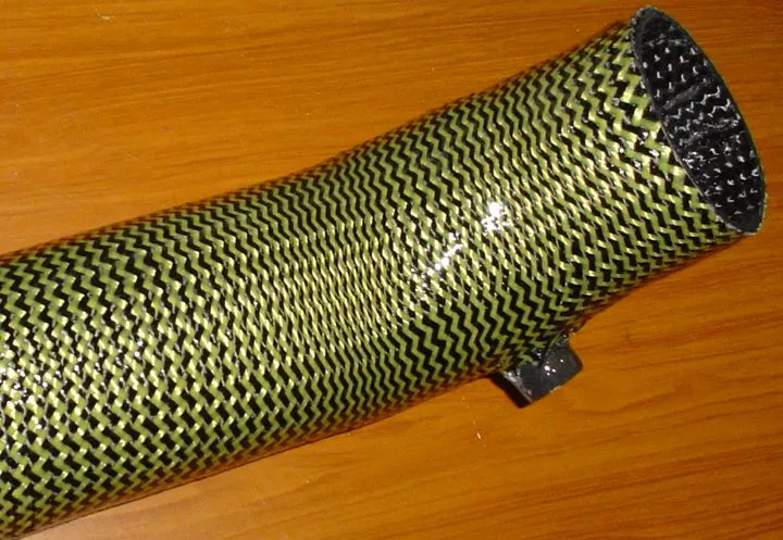

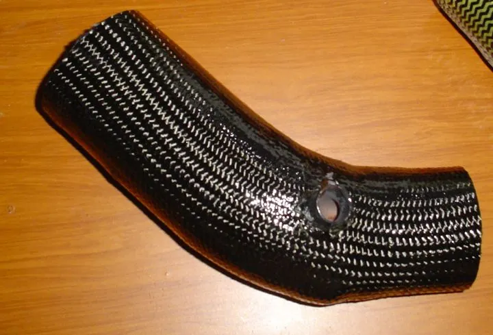

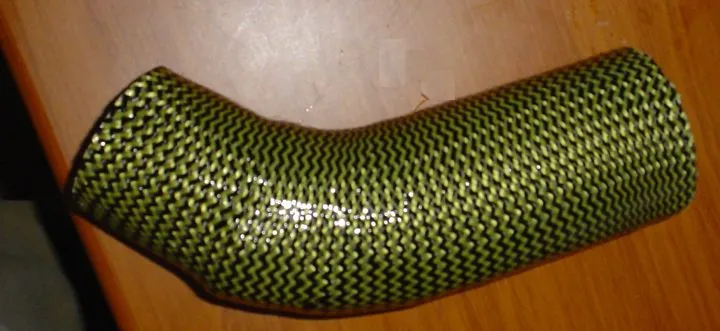

Here are some new pics of the SRI. Had to do a little photoshopping to get my hands out of the pics.
In response to your concern, Slug420- my original designs did have stalling issues, but with each subsequent test I built, I moved the nipple closer and closer to the turbo. Now, the outlet for the BPV is only a few inches from the turbo, and it works great. When I let off the throttle after a real hard drive and heavy blow off, the rpms will dip to 500-600, but then go back up to 800 pretty quickly. I haven't stalled at all with the current setup the way its being sold now.
A major difference between my SRI and the Perrin is that the BPV nipple on mine is almost at the bottom, unlike theirs, and I think that really helps.
