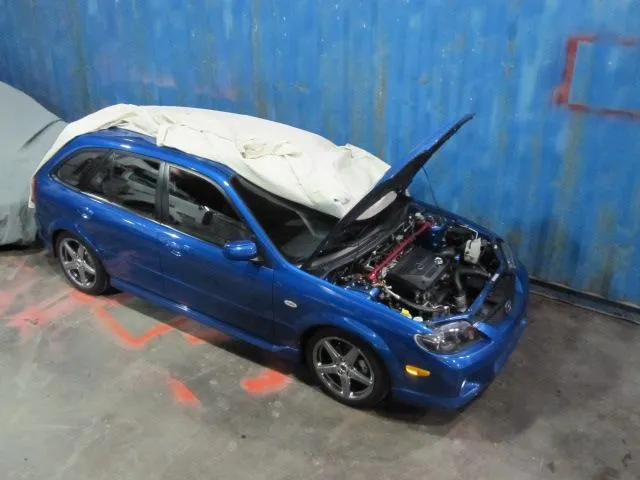

mine is like this @ about 2800 or their abouts it cuts out. I can here bov working. Its all stock, new turbo new lines and so on . No mods. Steed manifold. then It took off worked thur all the gears, and now Iam back too light rough idle, no mil light and a drop of power. could it be a temp sensor. maf or vics not opening??
Help would be great, sounds like we have same prblem.????:(:((p5blue)

Hey again,
It runs perfect till it gets hot. then it runs o/k but little missfire at idle. then at 2600 rpms it will only work thur with little boost.??????:(
Hey Again,
I got good news, I fixed my ride. Sombody put the rong plugs in this motor. (NGK LFR6A 11). What are these for a mini van??? Mazda speed plugs are for that car and only that. I think the number starts like ZRF???? It says in the manual got some on the way. ouch on the price 16ea and higher at the dealer 21ea$. good thing I only need 4. Soooo I am runnig pro5 plugs from another engine I have. They are wrong too but when i installed them and did a road test at operating temp the car took off, thur that low range, pulled till 6000 Wow i'am impressed this car almost felt as good as my old RX7 Turbo 11 car. Any how can't wait for new plugs.
(drive2)(rei)(p5blue)(p5blue)
Sooo O/K try new plugs, the right ones. Not the ones someone said they would work.
