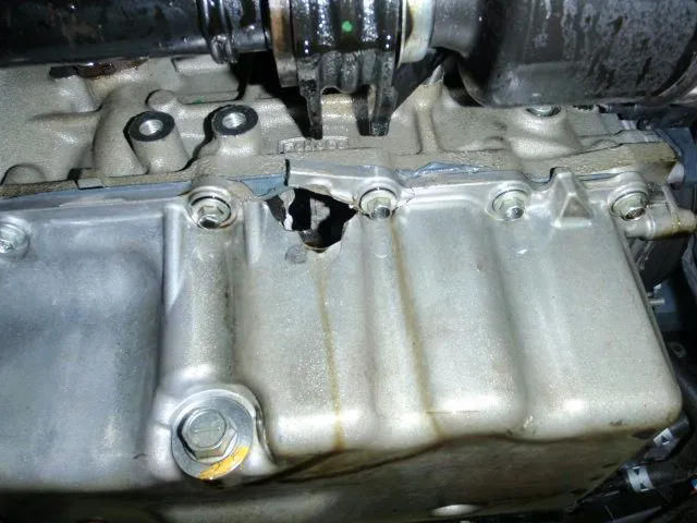

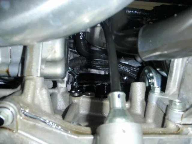

well what can i said my beloved POS mazdaspeed3 went boom boom boom, it happened saturday afternoon me and the wife getting out of massage envy which is 4 blocks from house we go through a stop sign nothing happens, next a four way stop, 1st gear all good as i engaged 2nd gear not even close to 3500 rpm we heard a big boom and i felt like something came off right off the bottom of the car, looked at the rear mirror a cloud of white smoke and the car shut off. called the tow guy and as the guy lifted the car oil pour into the street like water from a bottle. this morning i snapped these pics, the piston pin came loose and open four holes, one of them being the pvc, the oil pan and two through the block. the tech guy said that the clip that holds the piston pin slided out and cause this whole mess, he also told me that this has become a problem with the speed3s, that theres no way that clip can hold that piston pin. im the third car i see in the dealer with a blown engine due to either weak rods or piston pin problems. new engine has been ordered.

If the clip that held the wrist pin in failed there is still not enough room for the pin to slide out enough for it to fall out or even come out of one side of the piston.

i really don't think it has anything to do with the wristpin. its just not logical or plausible in this situation. i am betting once the engine is apart it will be an apparant rod failure and the wristpins will be intact. the pictures indicate that a rod snapped at or near the crank, which a wristpin failure or clip failure would not cause. a wristpin clip failure at worst would allow the wristpin to slide back and forth horizontally and scrape the cylinder walls apart.

hey ken waz up man, theres a mark on the piston pin which the tech told me that the pin slowly slipped through the clip, the clip came off intact no damage at all.
