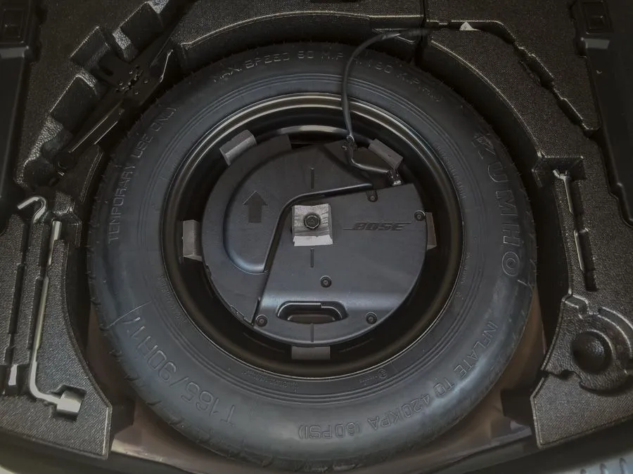

I did the exchange this morning. I only left about 1/4" of each of the 5 foam pads on the hard cover and everything fit perfectly. I did elongate the center bolt with a M8 rod and coupling nut. I need to have a coworker trim about 1/2" off of the rod at our shop in the next few days, but otherwise ready to go. Of course, after I put everything back together, I didn't think to remove the cover again for the "installed pic". It's amazing how much bigger the 165/90R17 is than the stock spare. I feel much better about heading to the North Rim.

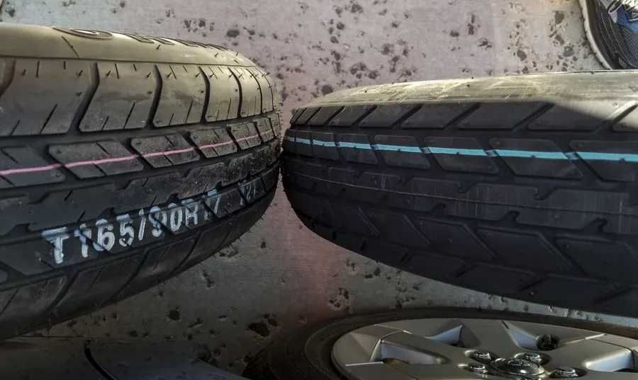

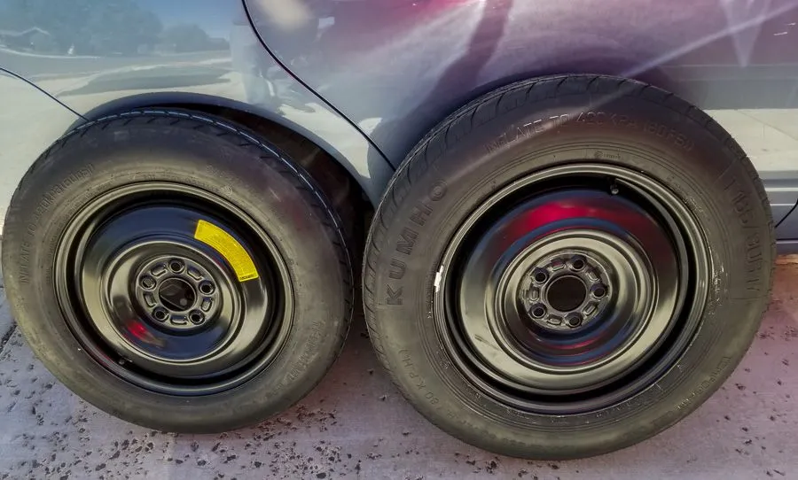

Went back out today to install some of the cut-off foam around the subwoofer and under the too-long bolt until I get the bolt cut shorter. I snapped a pic this time. It would be nice to be able to get the 185/70R17 regular driving tire that yrwei52 refers to above. There is definitely room for it.

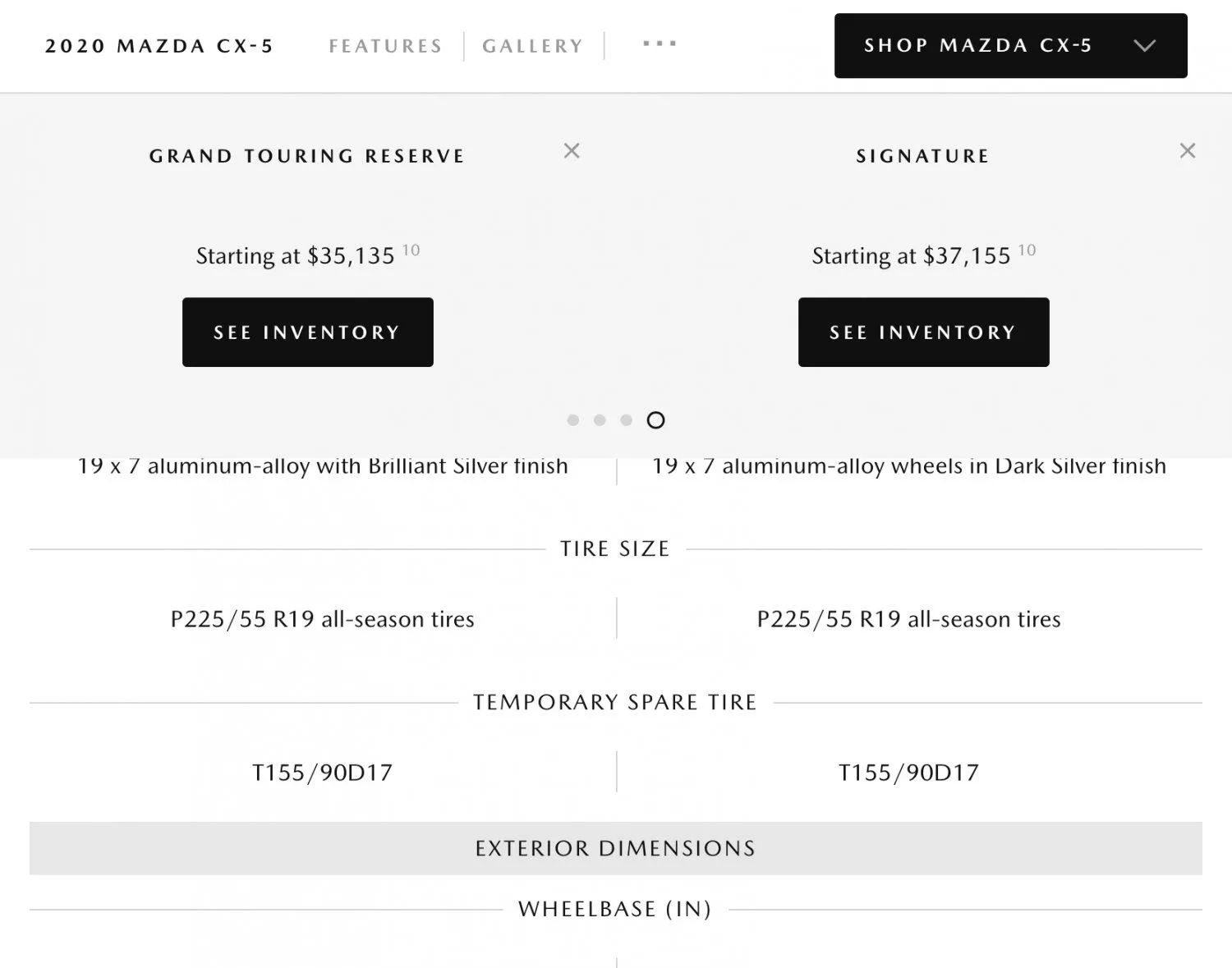

Just realized now Mazda states that 2020 models ship with “17 spare

New 17” temporary spare, T155/90D17 101M on 2020 CX-5 GT-R and Sig. has 28.3” outside diameter. Although it’s still not a size with correct outside diameter of 28.7”, but it fits CX-5 GT-R and Sig. at 4 corners which have bigger dual-piston front brake calipers whereas the previous T145/90D16 106M is too small to fit at front. Now we can use new 17” spare at front temporarily if it’s ever needed. I guess Mazda North American Operations saw the complaints here and decided to make the change. ;)
Actually, 155/90D17 outside diameter is 27.98" which is 0.7" smaller than your regular tire. You would be better off with 165/90R17 which at 29.1" diameter, is only 0.4" larger than your regular tire. 165/90R17 is spare size on old CX-7 and Hyundai Santa Fe/Kia Sorrento. If you plan to buy a new spare rim, consider buying the 165/90R17 tire. It's $78 at Discount Tire.

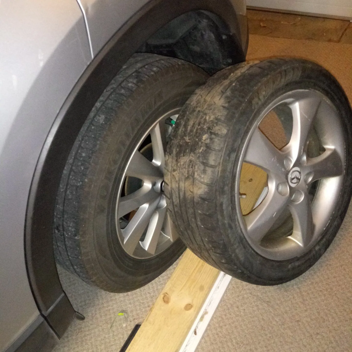

I just picked up a Fuzion 205/50 17 on what looks like a Mazda 3, 5, or cx7 rim for $60.
I can tell the tire is a bit small but it's probably better than the steel donut. I will probably replace the rubber with a take off when I get a new set.

Your 205/50 17 has a 25" diameter which is 1.3" smaller than the donut! Also, the 205mm width may make it hard to close the cover with wheel in the spare tire well. IMO, you're better off with the donut.
I haven't tried to put it in the trunk. It's in the garage. I thought it was a good deal for a 17" wheel but the tire is almost worthless, although it seems to hold air. When I get around to a new set of tires, I might put one of them on the wheel.
