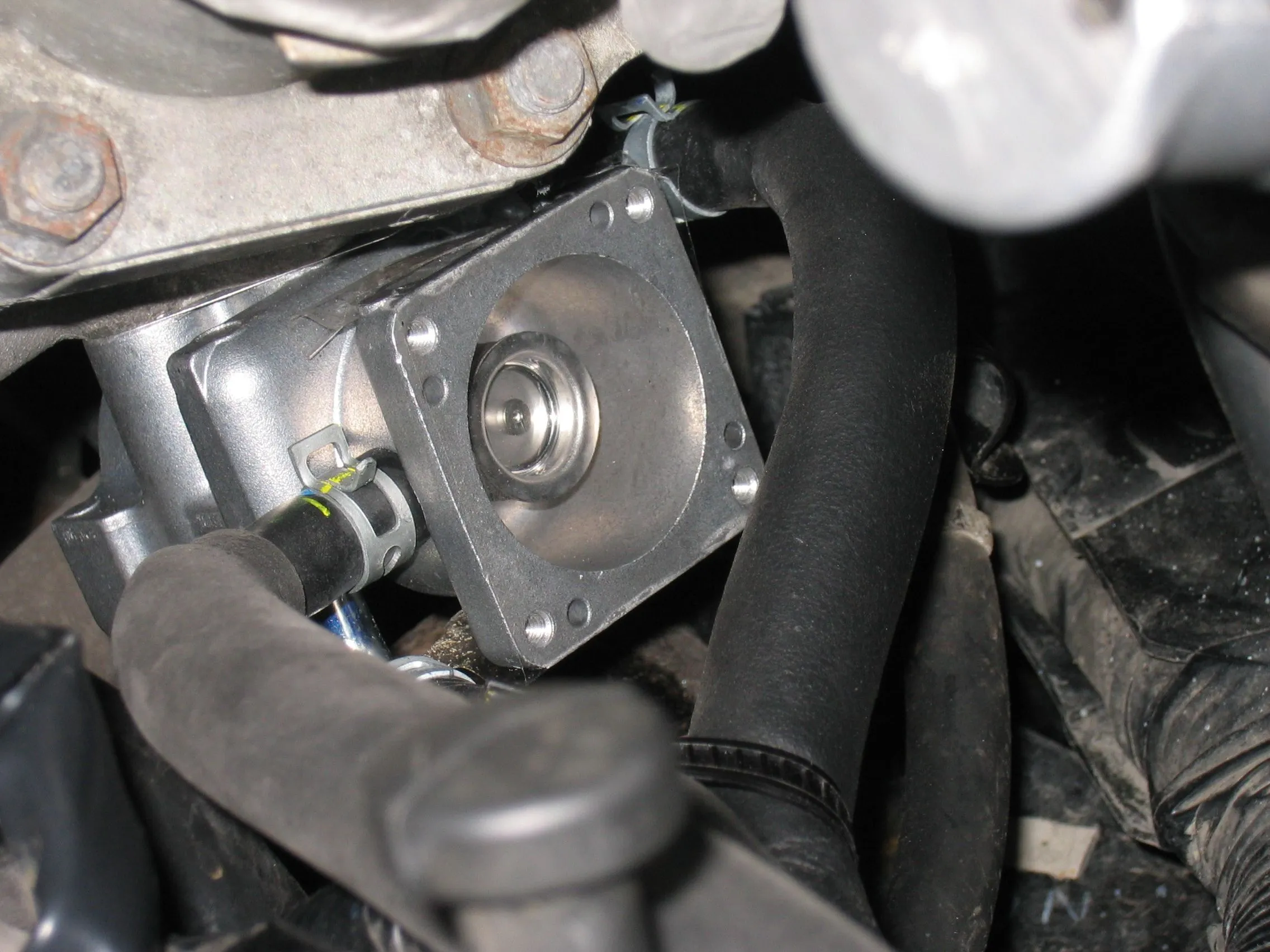

Just like mspeedP5 said - they can be easily damaged. I installed a Canadian EGR Valve, but had to remove solenoid first to gain some space. Then I attached solenoid to the valve with the same brand new screws (Philips type), and it was pain in %^& with the last screw.
