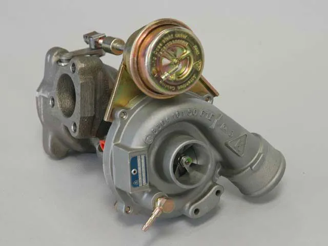

ok so check this...i typed k04 turbo in google and this came up....but is that little nipple the oil drainage? or is it the orange plug thats behind it? im not really awesome at turbos when seeing one and mechanically trying to explain it so......

orange could be the drain.. small section between the compressor side and exhaust housing side..
That orange plug should be the oil feed or drain connection. I can't tell. The nipple on the compressor housing is most likely where the boost solenoid connects and then the other will connect to the wastegate actuator. I dont know enough about these cars yet or the boost control system.

figured that.. i was just posting them for mazdaspeed32007
it doesnt show us much anyways, its not the turbo itself we need to look at , it is the drain lines..
