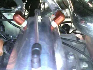

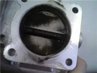

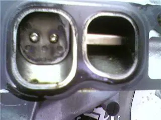

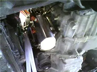

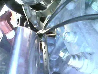

if noone caught this earlier in the thread i have some install pics of my catch can. ugly s*** guys. get one quick! This was only a few pics of the oil building up in the intakes and throttle bodies. there was more all over the intake side of this thing. BTW....does anyone know what that hard line is that runs to the bottom of the IM?? it looks like something that runs from the dp's cat....like an egr or something. the inside of that s*** is like a chimney! but anyway....get a catch can.
oh and for those of you with a CAI you can mount your cc lower than your im which will allow gravity to feed the oil much easier into the cc. check it....theres a bolt that grounds something to the tranny. take it off and use it with your.....mounting pole??....to mount the cc there. its higher than the tranny so you know it wont bump but its lower than your pcv so your getting all the oil to your cc no sweat.
