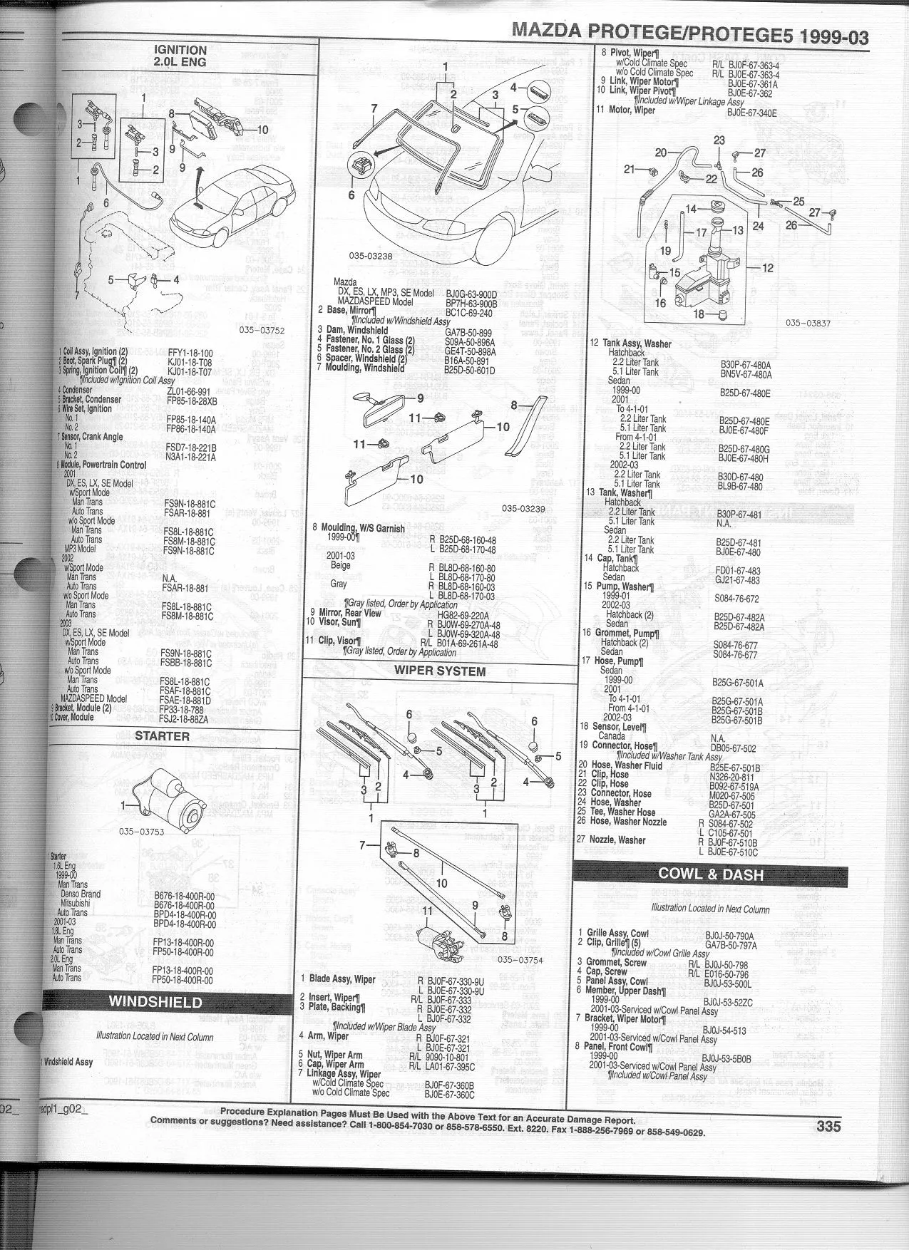

Here is the parts list for the Washer system. You need #27. If the dealer is killing you, you can get the ricer ones, but not plug in the LEDs. I think there was some solid chrome and black generic ones last time I was there.
Thanks for the info.
I thought of getting generic ones if the dealer is killling me, or I can find someone that lives close that has a CF hood and no longer needs the nozzles.
I hope I can just get 1 and not have to buy the pair.

I would swap the pair, so they both look new. I know mine have some wax around the edges and probably a little fade. New ones don't,a nd are pretty easy to replace.
