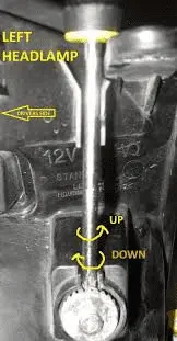

This is a picture I found, but the screw is like this park about a car distance from a wall with headlights on. Open hood and look for a joke with a screw like teeth marks. Looks something like this move 180 degree at a time and you will see the line move line both side to top cut off line
.essentially if you are behind a car about 3-4 car length you don't want the light in their rear view mirror just slightly below the other cars rear view mirror

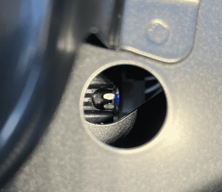

To expand a bit further on the above post, the hole that you're looking for is in the sheet metal just behind the headlight. If you look straight down into the hole, you'll see the adjustment screw in the picture above. You can insert a Philips screwdriver straight down into the hole to catch the threads on the adjustment screw.

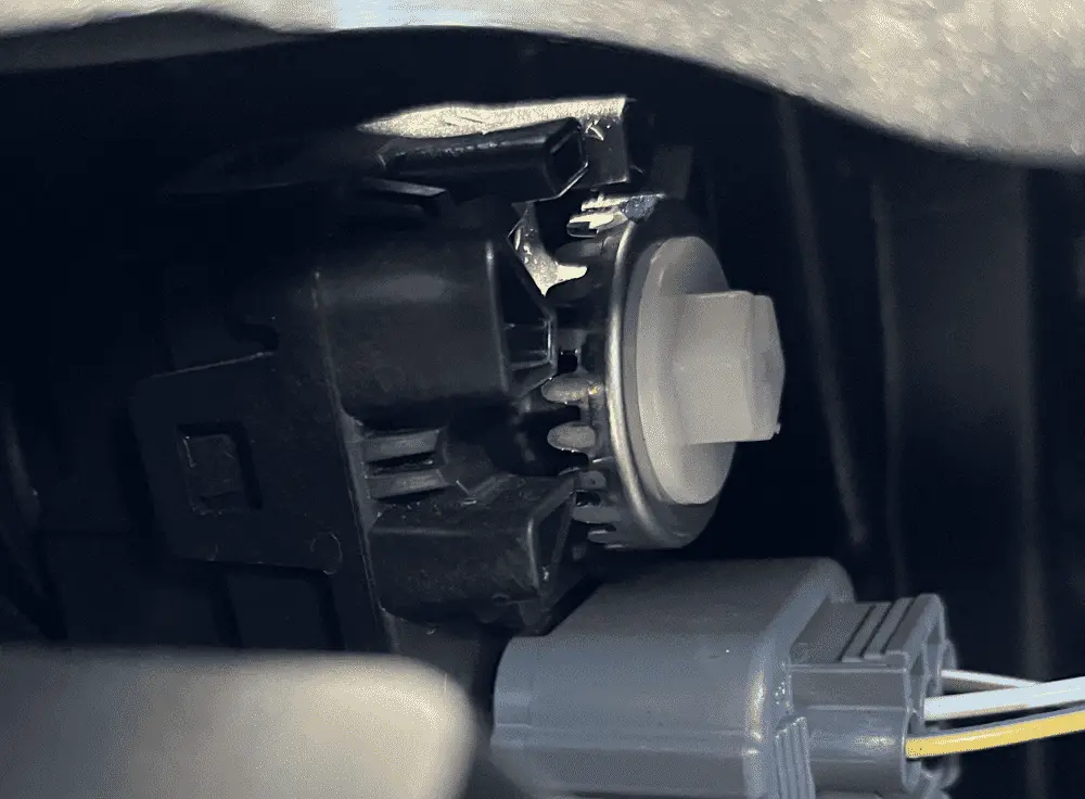

This is a common adjuster. The notches on the little wheel engage the slots in the Phillips screwdriver tip.
Mine had blue marks on the adjuster. I assume these were from the factory. The driver side had been adjusted down a little as the blue mark wasn't at the top. The passenger side had the blue mark at the top. I used tape to get a before measurement because my driveway is not level. I then adjusted the driver side blue mark to the top. Once both driver and passenger blue marks were at the top I then adjusted both 1 full turn of my screwdriver. This is exactly 4 notches on the adjuster. This turned out to be about 1/8 inch up at 3 feet from my garage door.
Side view adjuster
Top view adjuster
