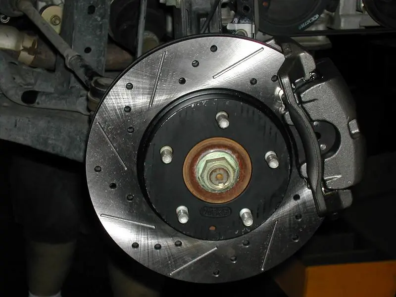

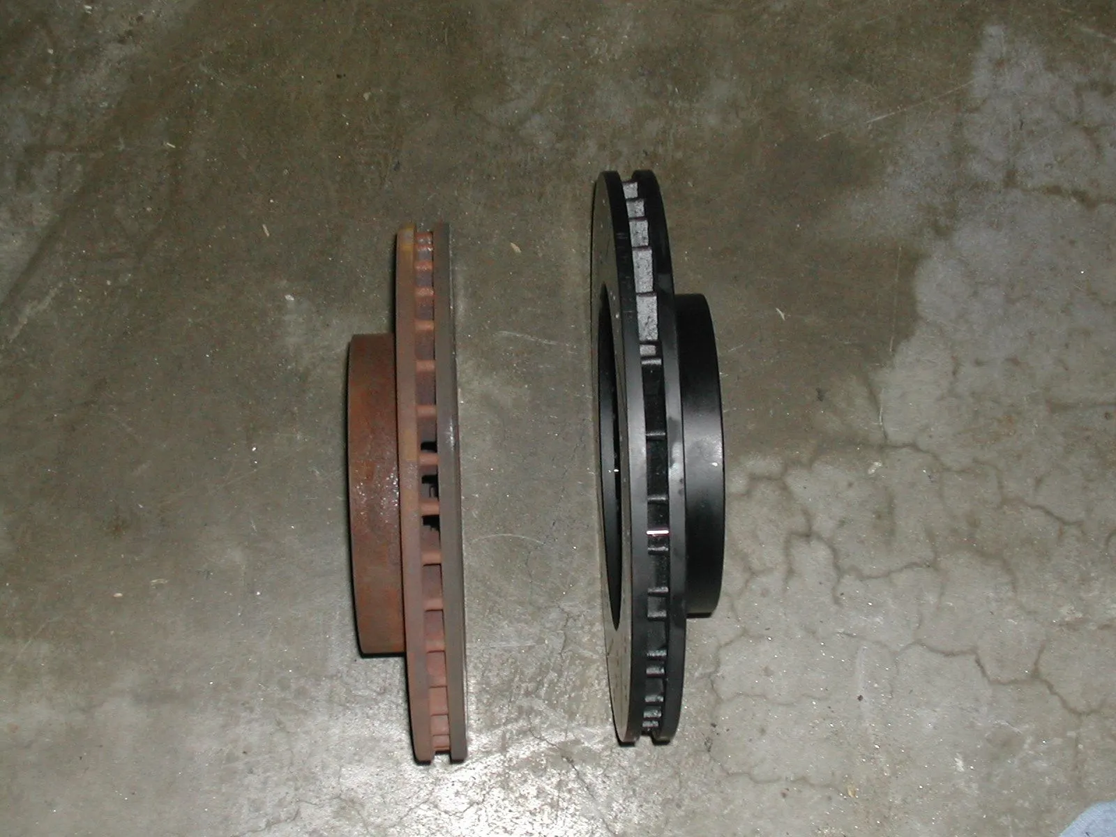

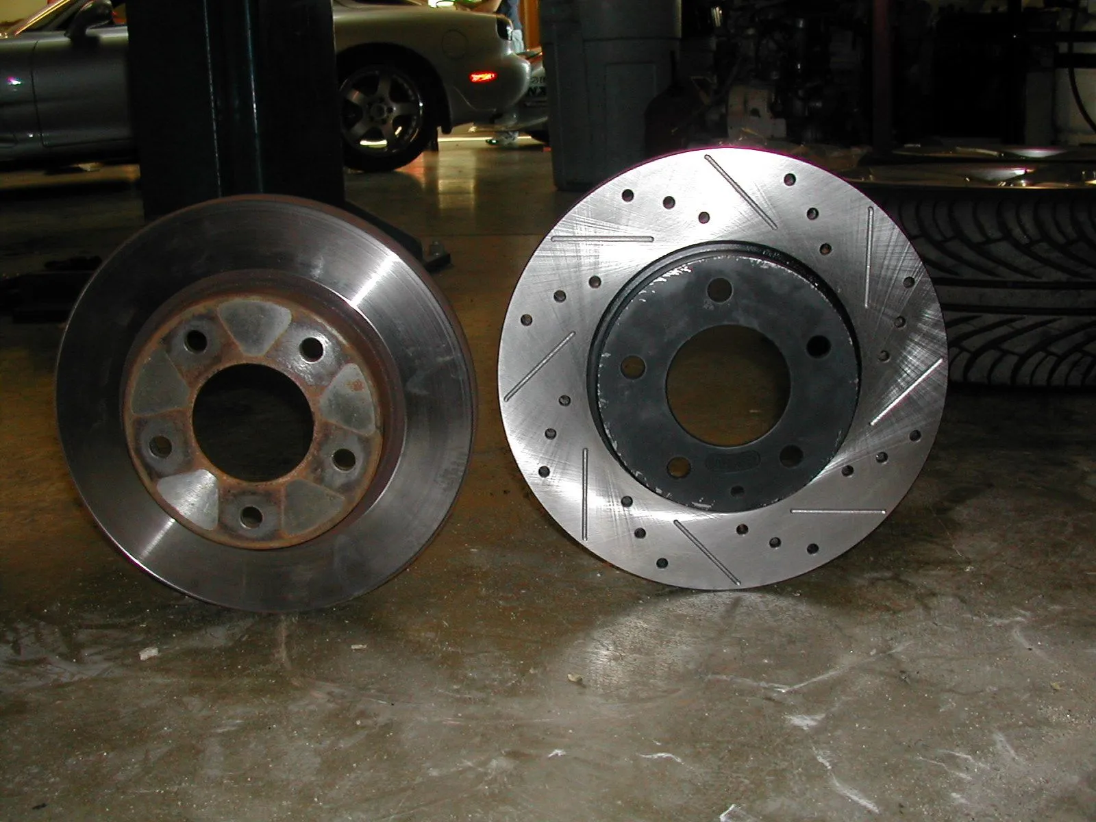

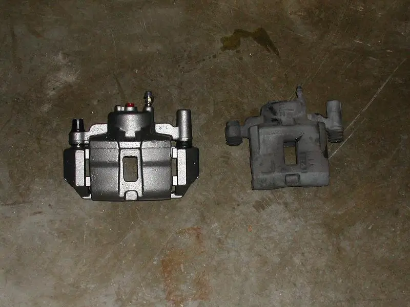

i assure you it makes a diff. (not as much as a $1500 brake kit) but my p5 stops much better than before and the brakes hold up much better on the track
here are some pics of the diff. in rotors and calipers
probably more so from the better rotors and pads than from larger rotors.
