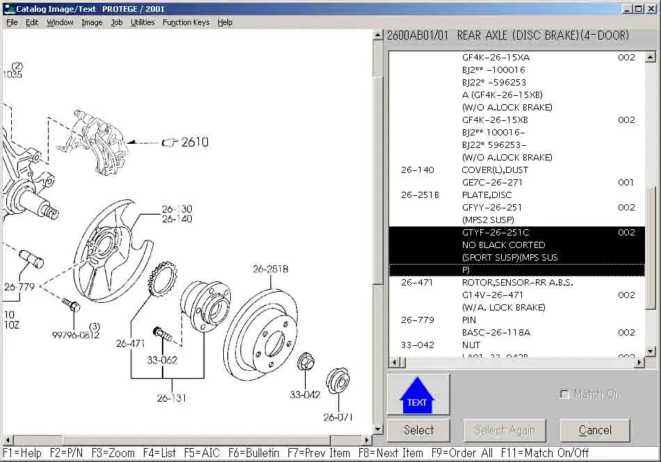

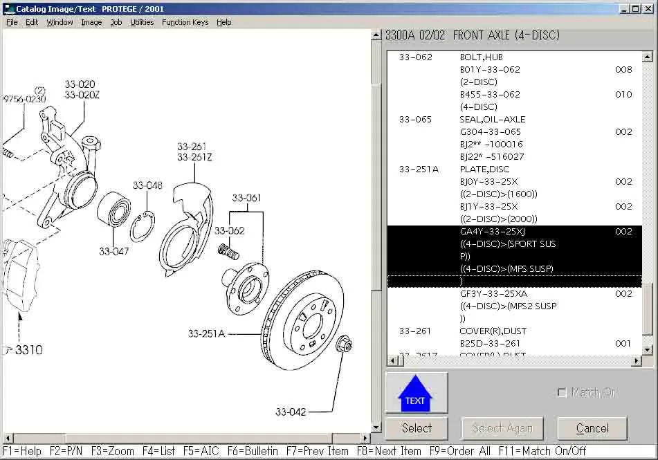

As you can see, they're the same...
"sport susp" = ES & P5
"MPS susp" = MP3
"MPS2 susp" = MSP
any other questions? (poke)
