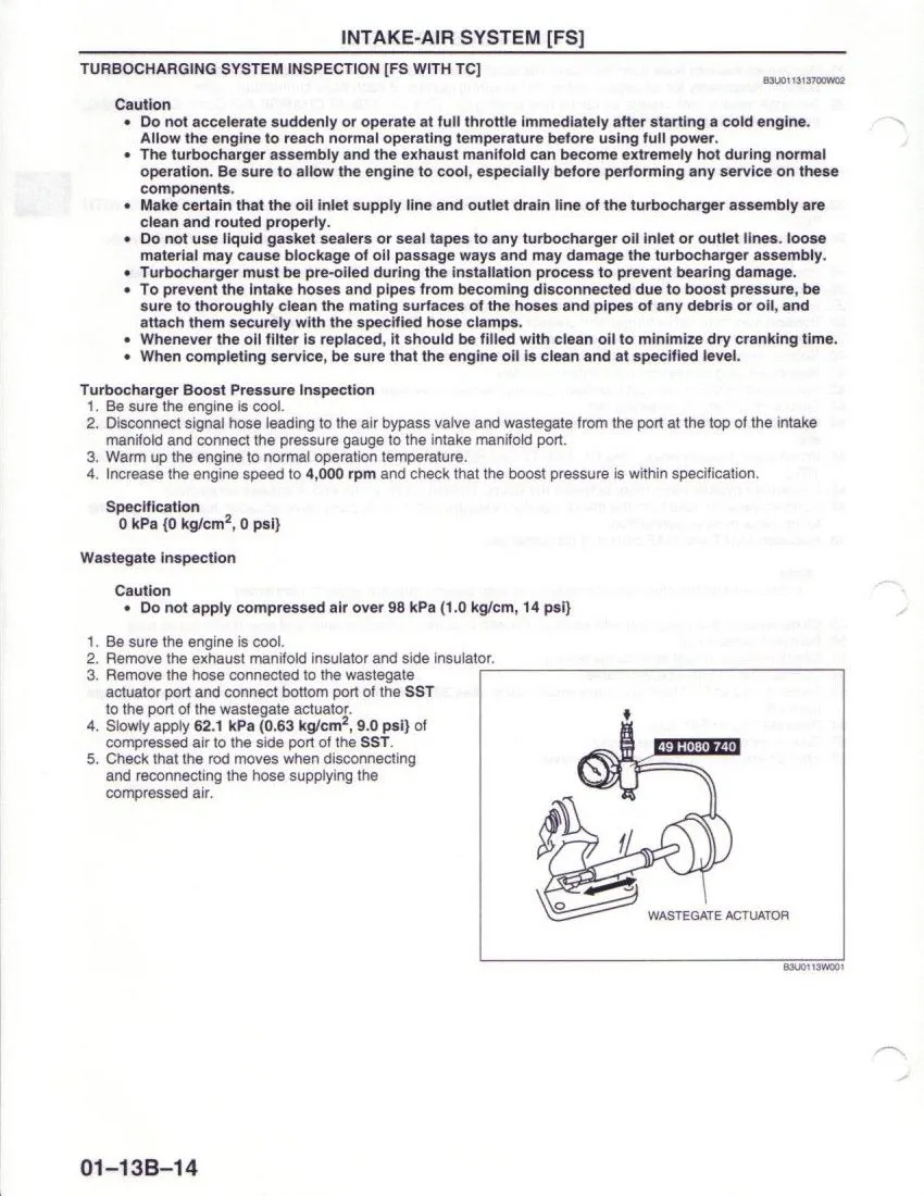

Here's a pic of the factory workshop manual...I'm curious how anyone (like a car magazine) knows other than heresay if Mazda won't even print it?
attachment.php
For autocross, at the National level, generally, you have to prove things by the workshop manual, citing a car mag doesn't fly. So for instance in STX, if you replace the computer (which is legal) you have to maintain the stock boost level...but how do you prove you're at the stock boost level?

Well it was all over the place I had some literature from Mazda concerning this and it was always stated as 6.9PSI. I don't think I kept any of it I will look around this was all over a year ago. Personally I think stock boost sucks so it was never an issue for me. I run 12PSI with the MBC in. If they changed the PSI on the later cars or after production started on the 03's then thats just one more thing Mazda lied about just like the overated power numbers for the RX8's for which Mazda was sued and lost. Supposedly the Manual for an MSP was just a barely ammended ES manual. This car was never really given any support just slapped together by a bunch of half drunk port workers. (laugh)
I love my car but I seem to be lucky compared to some others. Mine runs 12PSI all day like a champ after 33k miles, never really hesitated and gets good mileage. The only thing I did not like was getting screwed out of 1.9PSI of boost! Well that and the sorry stock turbo hoses which were replaced by Mazda.
