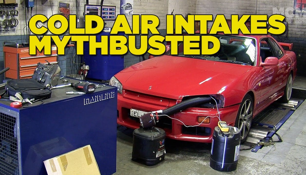

On a turbo car intakes don’t really do much, whether warm air or cold air. That’s why you see so many big turbos with pods directly attached to the turbo or just a screen attached to the turbo. I remember seeing a video online where they talked about how Intakes really don’t add much in the way of power. Also, typically when they do these “dyno test,” typically they take the lower factory Dyno number (factory airbox ) and take the higher dyno number once they put the intake on.”
