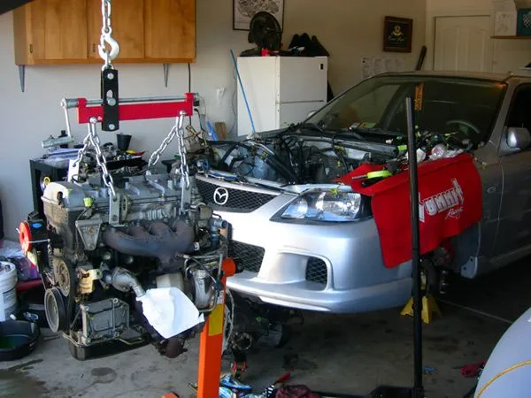

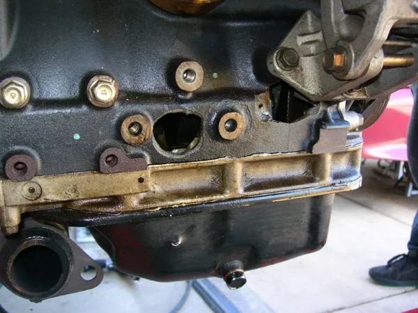

I blew my motor on March 30th. I've been saving cash to get a new motor. I finally was able to get the cash together and I pulled my motor today with the help of my friend.

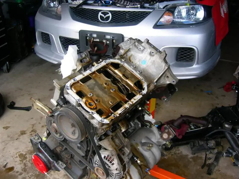

So...... here's the motor... pulled. Super-f'ing-Chuck-Norris thanks to Tony (AzMz6) from 6Club.com for the advice.

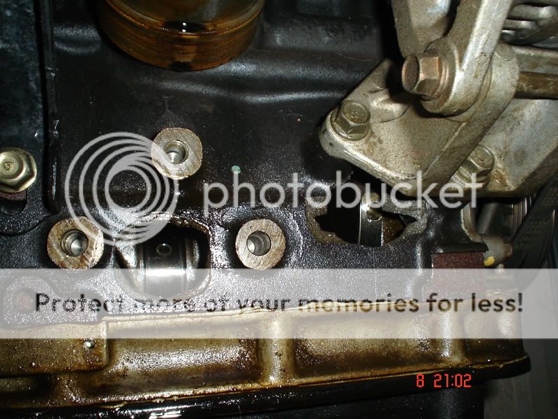

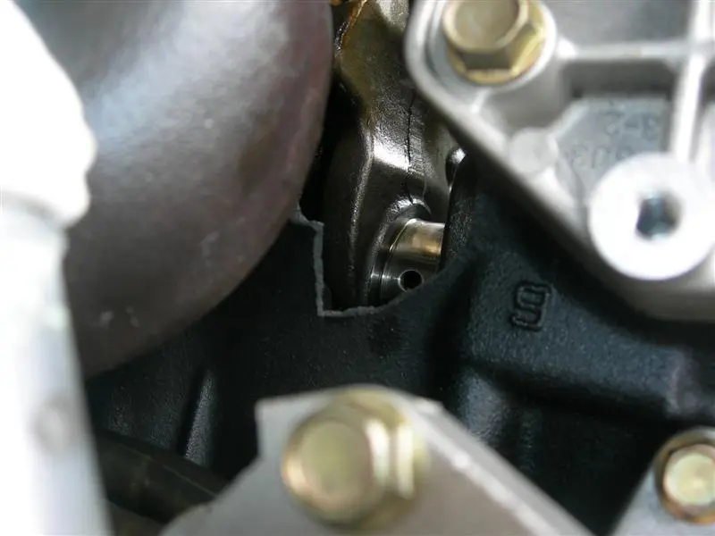

Check out these two holes in the block. TWO!!!!! Not one blow point... there are two. The motor threw two rods at the same time. Tell me it's because I didn't "change my oil." (For the new guys - MazdaUSA told me they wouldn't cover my warranty because I didn't have complete oil change records.)

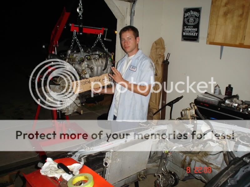

Here's the picture I'm going to keep in the file for when I sell the car. For those of you who don't know me, that's my buddy Dave holdin the sign.
Good to see that you got the engine out.
I had 6 holes in my block. I need to get some pics up asap of my destruction of a block. Good luck with the car.

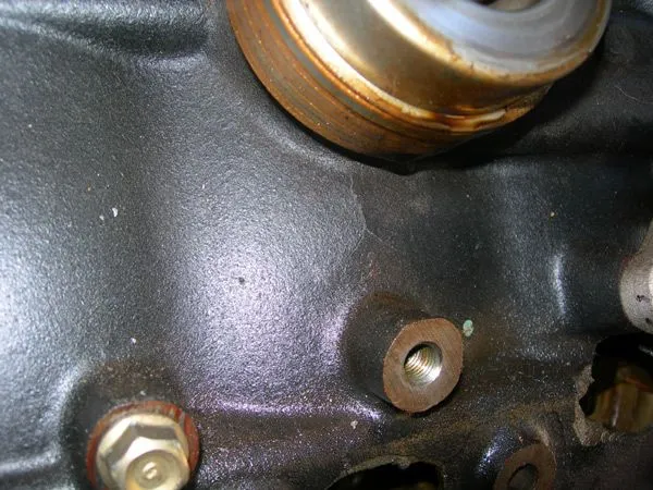

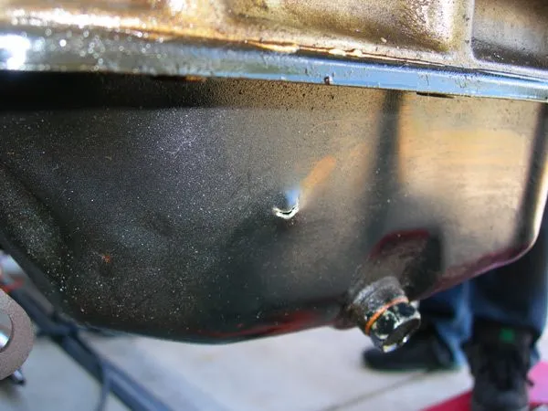

There are a total of 3 holes in the block one that I can fit my hand through under the turbo. There is a crack where something wqas coming out of the block. There are two dents in the oil pan from the inside going out.
Bill (rednecks_r_us)is taking pictures for me and will post them when he gets home tonight. There is no compression either. We can easly turn the crank by hand.

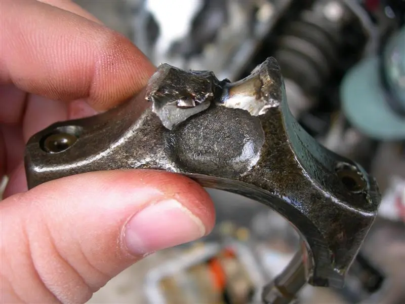

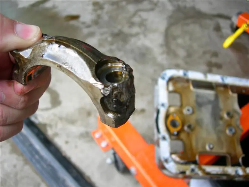

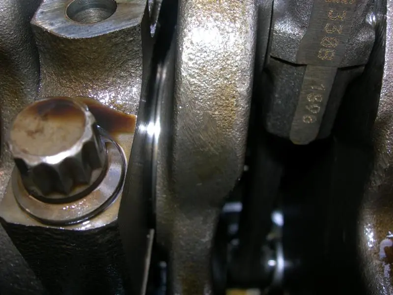

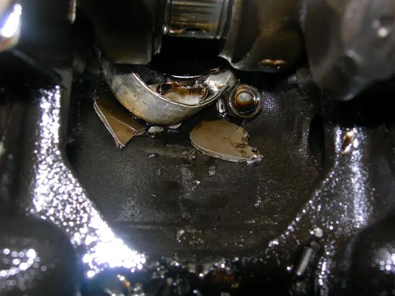

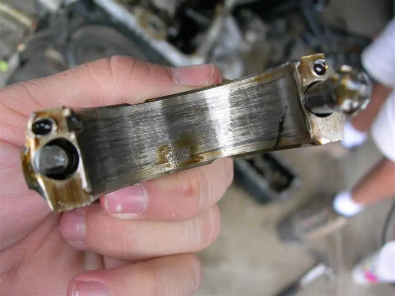

The car has 46K miles and Mazda won't warranty it because Aaron changed his own oil and didn't have receipts. This is a bone stock MSP on stock boost.

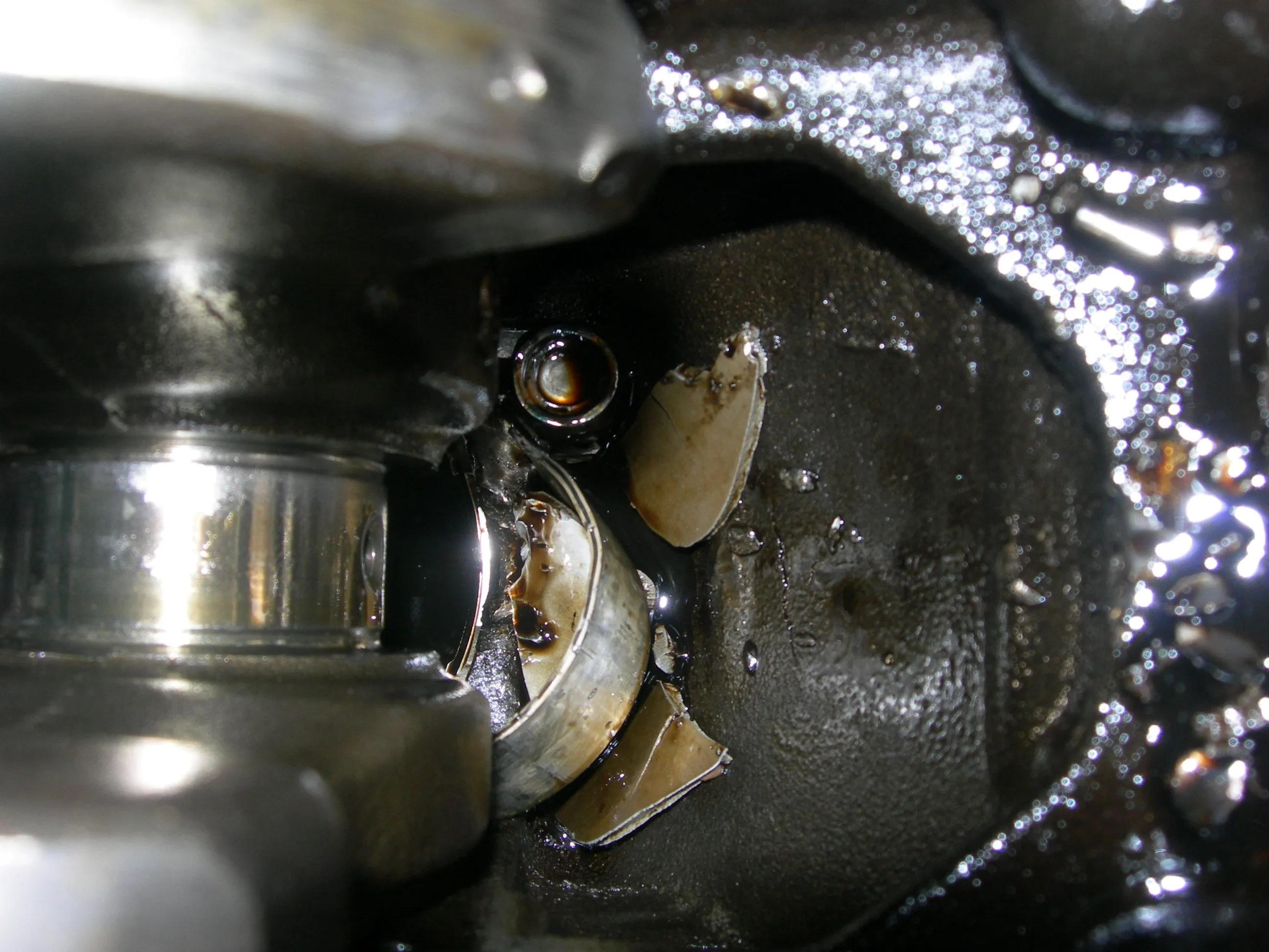

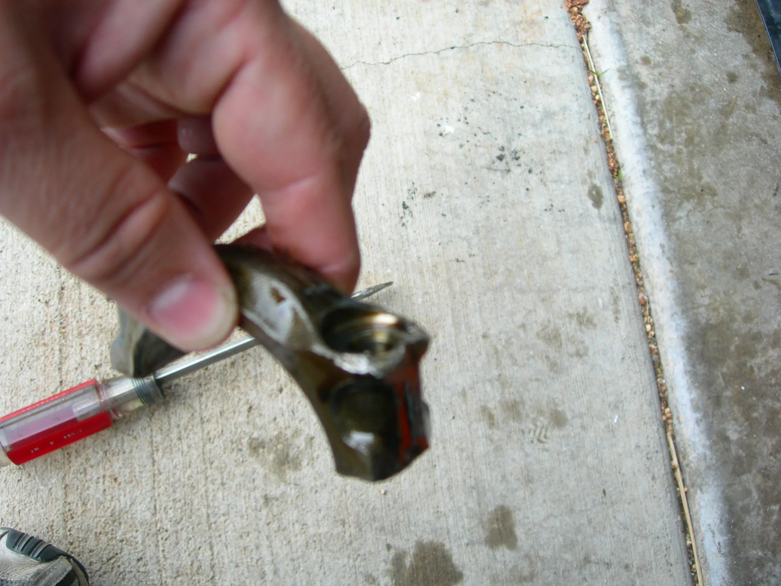

A rod broke and went flying around in the bottom end. Aaron was at 3600 rpms in a 25 zone on his University campus. Speed bumps all over campus so speeding isn't even an option.

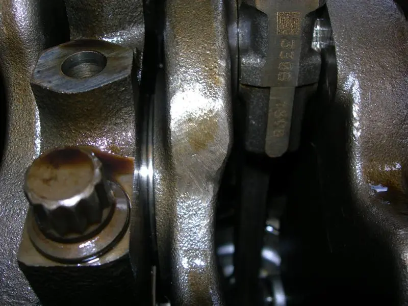

It even scored the crank. Pulled the intake manifold thinking maybe the VTCS screws fell and stuck a valve. But all the screws were there.

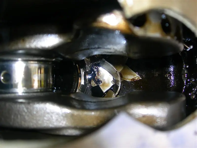

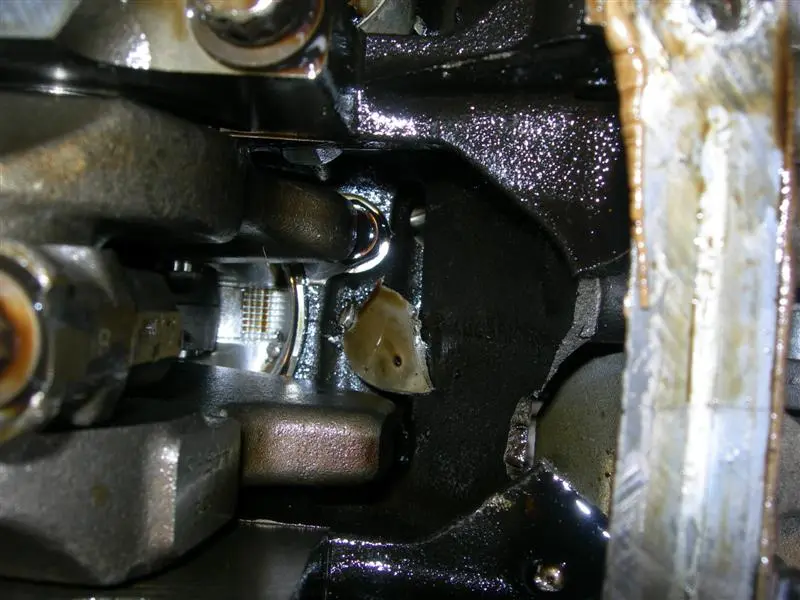

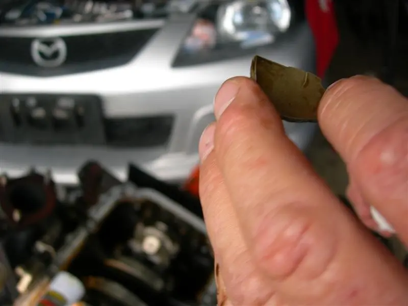

look at all the debris inside the motor

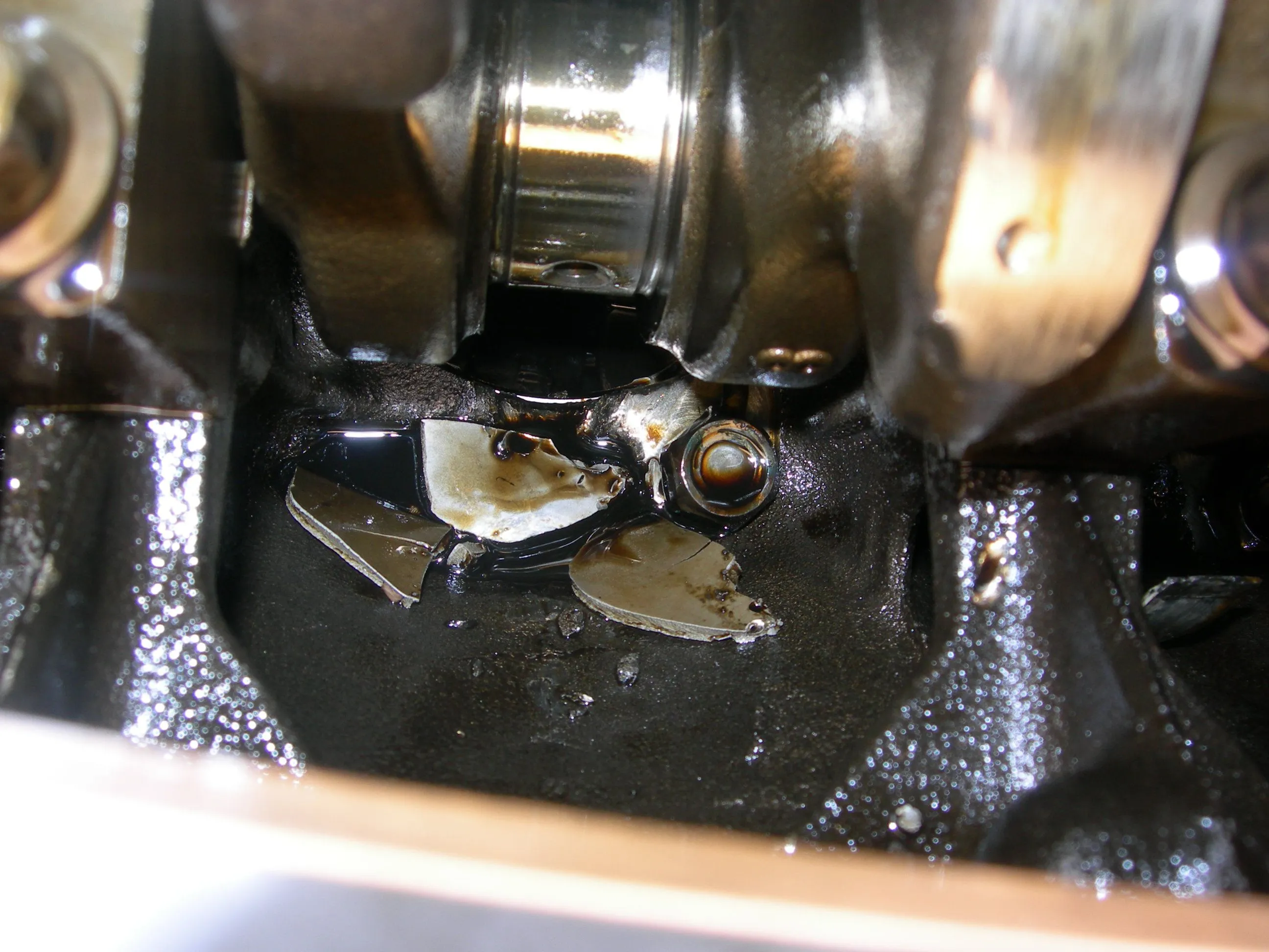

The last 2 show some scoring that occured during the Zoom-Zoom-KABOOM
