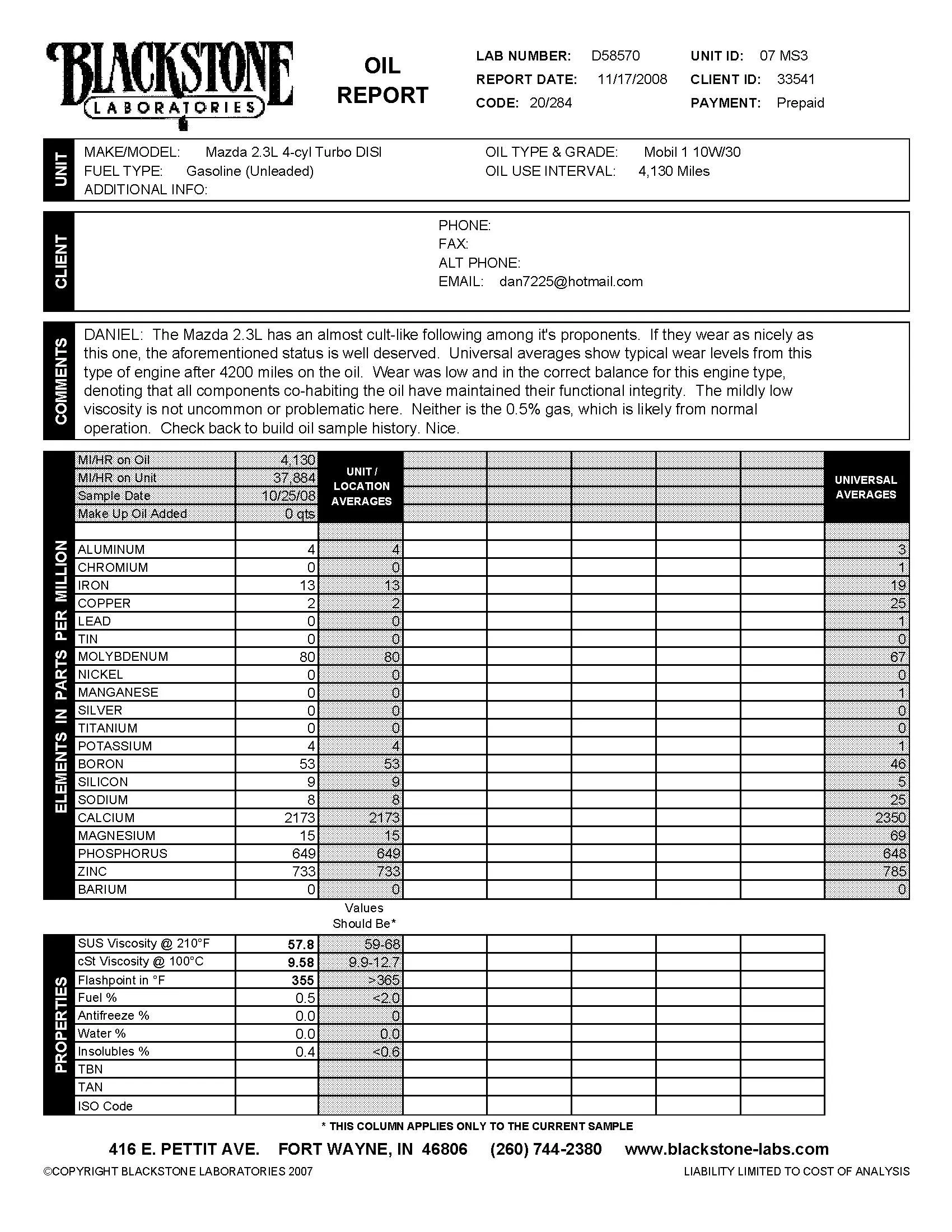

so here's the analysis
4130 miles on oil
37884 miles on engine 10/2008
used Mobil 1 synthetic 10W-30
what do you think?

no actually this kind of proves the whole no need to change the oil every 3k theory...bet the oil was black as s*** AND smelled of gas...but low and behold...the oil is still doing it's job! PRAISE OBAMA err Jesus!!
i drive a lot of highway miles. and i dont really drive my car that hard. i can't afford to waste money changing the oil every 3k. i usually try to get it done @ 3750 or less than 4000.
also this test was done with 6qts of oil, spin on adapter, and the rediculously huge NAPA Gold 1516 filter.
Here's my latest UOA from Blackstone:
Miles on engine 25109
Miles on oil 4989
Date sampled 10/06/08
Make Up Oil 0.0 qt.
OEM Mazda Filter
Mobil 1 5W-30
Aluminum 4
Chromium 1
Iron 27
Copper 5
Lead 0
Tin 1
Moly 97
Nickel 0
Manganese 0
Silver 0
Ti 0
Potassium 2
Boron 53
Silicon 7
Sodium 7
Calcium 2365
Magnesium 13
Phosphorus 627
Zinc 832
Barium 0
Sus Visc @ 210F 55.5 should be 55-62
cST Visc @ 100 C 8.92 should be 8.8-11.1
Flashpoint in F 385 should be >365
Fuel % <0.5 should be <2.0
Antifreeze 0.0
Water % 0.0 should be <0.1
Insolubles % 0.4 should be <0.6
TBN 3.4

more data for the folks who may still have doubt that you don't need to change your oil as often as 3-4K miles
i mean you have 5k on that oil and it is still doing its job! you could prob squeeze another 1k out of that oil.
My previous UOA covered a 5182 mile OCI and included 3 days at an HPDE- 93F temps with 30-40 minute track sessions. The report was still good, and Blackstone stated:
"Feel free to run it another 1,000-1,500 miles before resampling. Check back then, as you may be able to go a little longer on this fill. The TBN read 3.2 so you've got plenty of active additive remaining for the extra miles."
If you are using a good synthetic 5W-30 oil anything less than a 5000 mile OCI is a waste of time and money.
