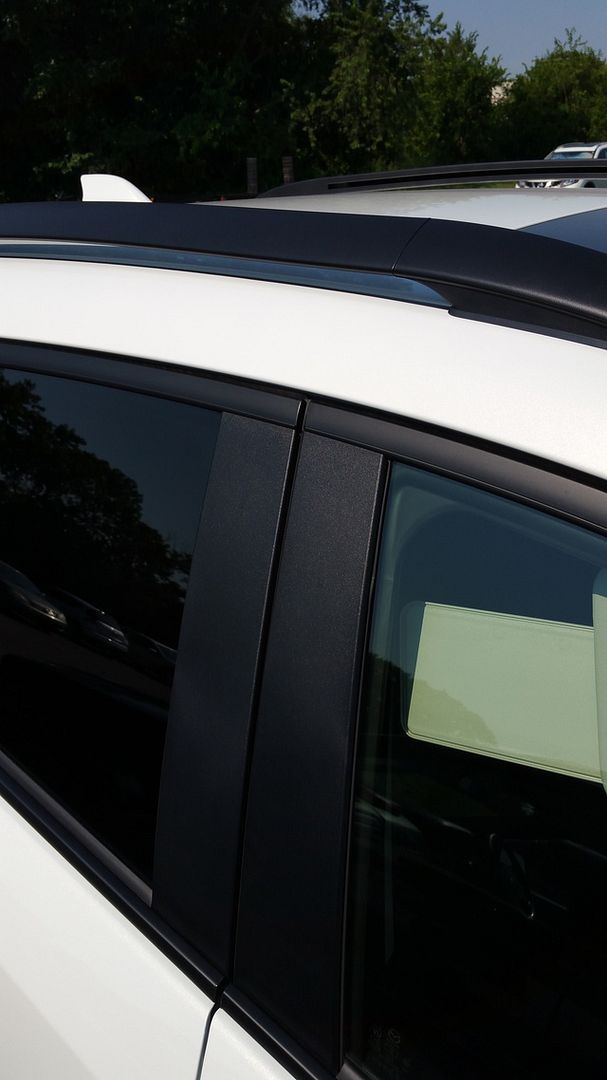

did you use the basic black plasti-dip?
wondering how well it matches the other black trim
a closer pic outdoors if you get the chance would be great

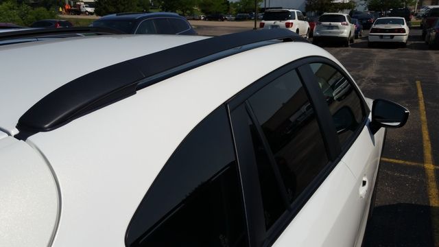

I did use the basic black plasti-dip, and I think it matches the other black trim quite well. See for yourself, though:

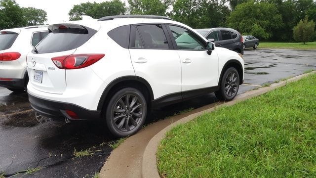

The plasti-dip looks to match the black trim very well indeed. Did you 'dip' the wheels as well?
Yep rims are now dipped as well using the anthracite grey "true metallic" line sold by dipyourcar.com. They have a nice metallic sheen to them but I'll also be adding the gloss coat soon to look more oem like the 2016 models. I took the wheels off to paint them. Great tutorials on YouTube so you don't waste time and energy by using the wrong techniques.
