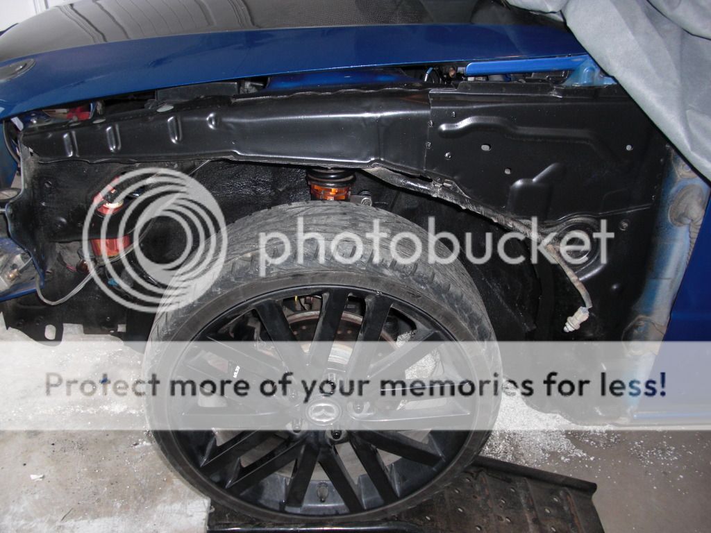

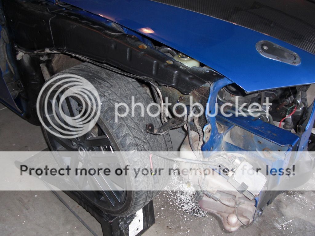

rust proofed the inner fender, wheel wells, and raised the ride height of the coilover by 1.5"
i used Por 15, its a multi part system. I taped up a few things but i also had the front suspension out of the car when i did it. As long as you follow the instructions you'll be fine, top coated it with black bedliner to give it UV protection.
