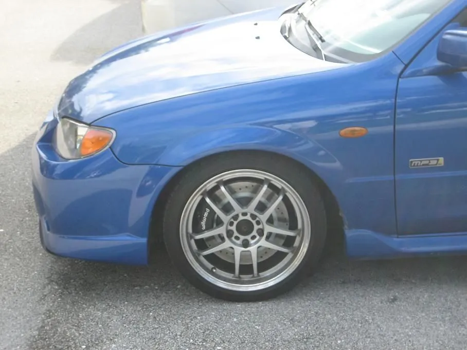

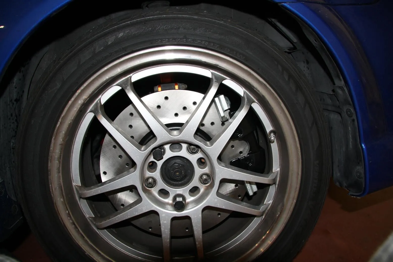

I got em on my car.... :-)
One shot is of my old WilWood setup and the other of the MS6 without pads. Ive ran them a few months and with stock MS6 pads (great life, high dust) and StopTech rotors from Tri-Point they can handle everything I throw at them. I like them even better than the WilWood setup. Highly recommend!!

From looking at the pics on the first page. The caliper only covers half the rotor. Not sure but I don't think that helps. Plus it looks sorta funky
Thats the regular 6 sedan setup on the Speed6 the surface area the pad covers is larger along with a European style caliper much like the VWs and Audis.
