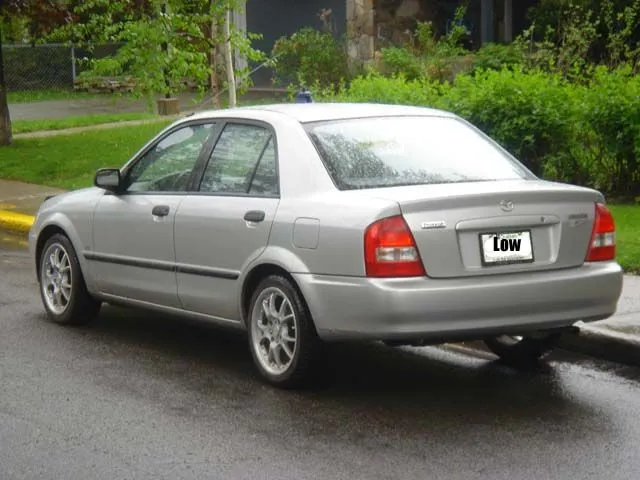

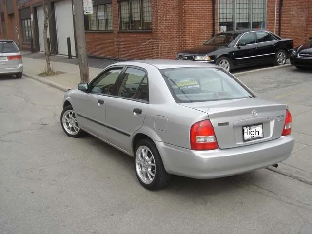

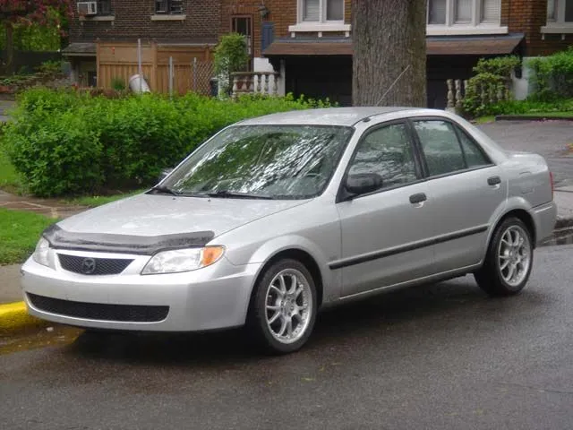

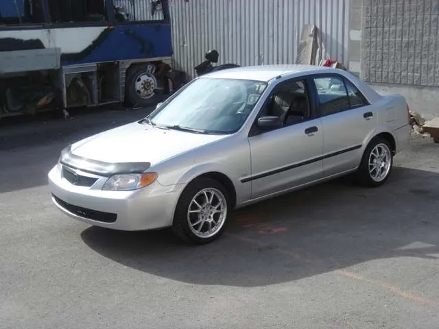

Heh heh heh, ya ya I shoulda done more research. 2 inch drop or less you may need a camber kit, otherwise it's ok, I installed the aforementioned spring/shock combo and the alignment guys were able to keep it within specs. Megan racing designates the drop on these springs to be from 1.8 to 2 inch drop, depending on model, mine being a 2001 SE base model totally bare!! It's light as hell, hehe
(but I have A/C ehhe)
So my car doesn't get the 2 inch drop...sniff...
But Im pleased with the difference in handling, I may be a Newb but I notice the difference in the way the car handles expansion joints at high speeds very nice indeed, the Tockico hp's help of course.. I'm running stock sway-bars but it
handles well in spite of of it.
ok to the chaste, the pics ..
p.s. I,m running 16/7 42+ NS-1 205/40/16 rims an skins (only a half inch taller then my stock 195/65/14 wheels)
