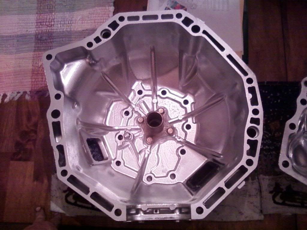

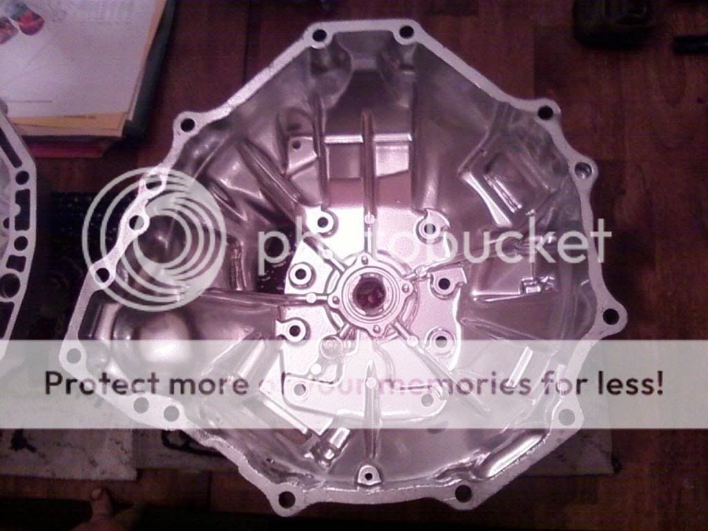

The JE Engine has a different bell housing than the B2600i. Engines that are bolt in for the B2600 are as follows : Mazda FE3 DOHC 2.0 and or the Kia Sportage Variant (95-2003) of this engine which would be easier since its all ready setup for RWD. Mazda FE-SOHC, Mazda F2 engine, The R Series Diesel, and of course the G6 engine which you have. The G6 Transmission is a R box. Identical in many ways to the RX7 Turbo II (R) box. Difference include Input shaft length, gear ratio's and tail housings and Bell housings. Neither variant is known to be stronger than the other. The only vehicle that the JE bell housing can be found in is the Mazda 1989 929s model. Very rare these beasties are. Both the G6 and the JE (at least in the MPV) show to have the same part number for the motor mounts. So with the bell it should be almost direct fit in the B2600 (Maybe haha :). ) I have heard the MPV had the JE (w) a 5 speed but i have yet to find proof. Ill post some examples of my JE bell and the G6 bell :
B2600 Bell :
JE Bell :

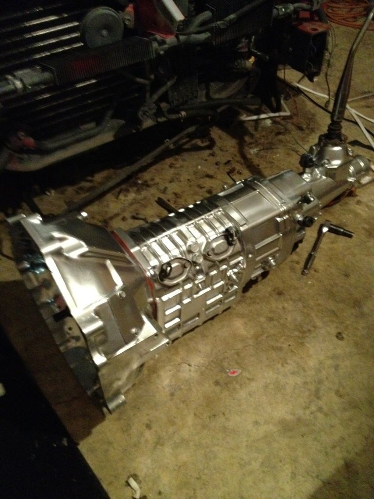

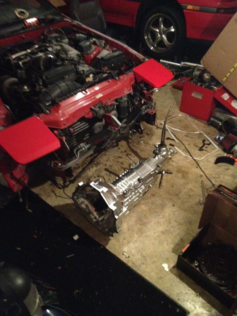

B2600 R Box (w) JE Bell Going in my Miata :
