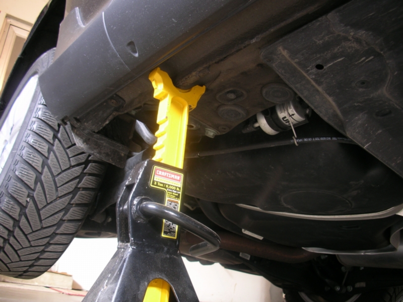

So then do the axle stands just straddle the pinch weld like in this picture (not a MZ2)?
Look for the "notches" in the pinch weld near the front and rear wheels...it's extra strong there, specifically designed for putting a jack/jackstand.
