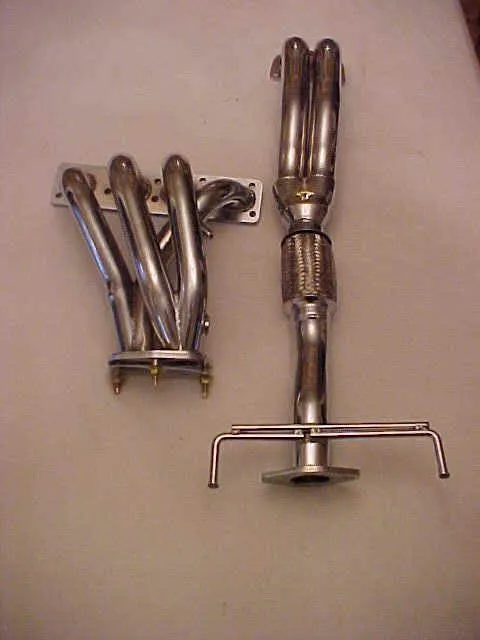

Here's a pic of the header i just purchased! I figure i should be getting close #'s as yourself..this header i just ordered is a 4-2-1 design...
Well...w/ getting 150whp without nitrous is going to be very difficult!!
