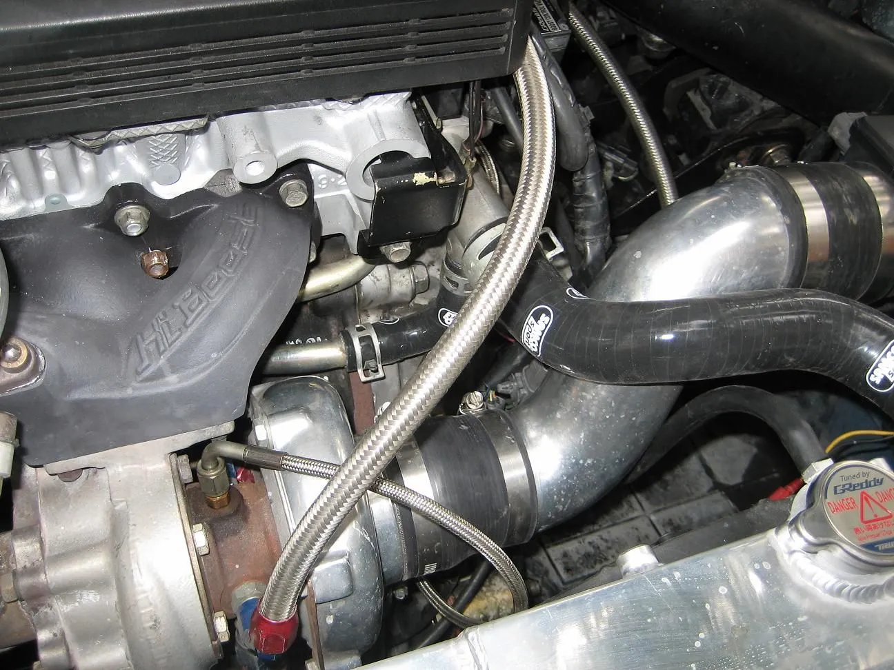

Here are some shots. Only noticeable stuff is it's dirty as hell, and the head is ubber clean. Also the two new black Samco hoses. Boostin a woppin 6psi and so far 173miles in two days or so. Will swap oil at 1k with synthetic and then up the boost slowly to the target range. I hope to get a oil cooler in the future and place it where the fog light is sicne the fogs suck up electric power when on with the A/C. Car shakes like a mother. Even an MSP with front/read mounts feels smoother. SEAN....
ps- im gonna be powder coating a bunch of my little brackets(like that on black one scratched up) sometime this week and ceramic coat the DP then giving her a nice wash to get things looking real nice.
I REALLY want to up the boost already and go past 4k RPM. I was recommended to just be in and out of boost often to get a good seal on the piston rings and not to pass 4k for now.

Be mindful that when you are powdercoating that bracket, that it is where some of your ground wires attach to.
Car has 1k+ miles already so I will be doing the synthetic oil change and upping the boost to a conservative 10-14ish pounds for now. I'm not in the mood to start swapping trannies just yet.
On a side note the car does take slightly longer to spool with the lower compression pistons, it's def noticable....or maybe it's the tune. It's not tuned for the new pistons so maybe it can also be that. Just thought of that...oh well. More updates soon.....
